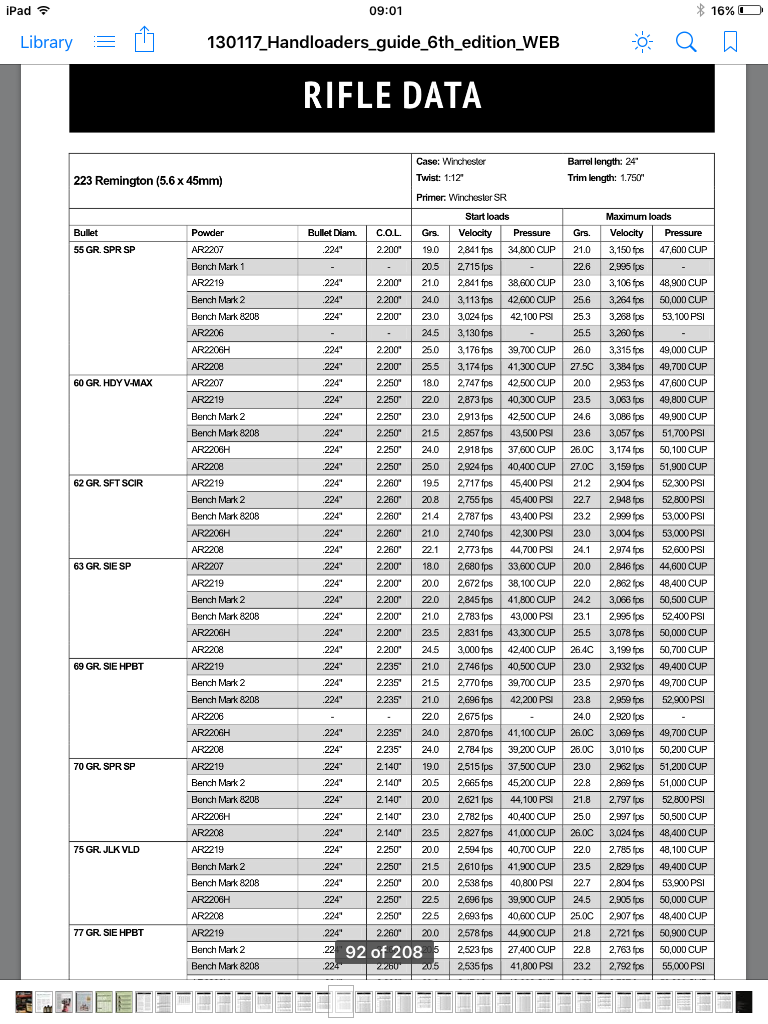

Here is the data I have found, not entirely complete. That coupled with reading some of the comments, I’m a little inclined to give the BM1 a miss and just use 2208 with the most up to date edition of the ADI data.
BM1 with 55gn

No there are a lot of people that just when giving load information are very cautious as they dont want to be responsible for miss information that may cause a issue. I think what you have there and even what is in the current manual that shows its use for lighter projectiles indicates that it is certainly a possible powder to use. It may not be the best one but if you start at the lower load I am sure you will be fine. Its not like you are going to blow the gun up. That information even shows a faster powder than BM1 can be used. If you wanted to be absolutely cautious you could load 20 grns that is less than the minimum shown there but no so much less that it would cause a problem by going too far in the other direction of under loading.
Re: Anyone using Benchmark 1 in a .223?
Post by JimTom » 14 Feb 2018, 1:28 pm
Yeah all good mate, I Would never load anyone else's load anyway. I was just curious if anyone was using BM1 in a .223. As always I will start at the minimum load and go up in half grain increments, staying below the maximum load, in this case from 20.5 to 21.5 checking the cases as I go to check for any signs that it is getting too hot.

Tried the BM1 loads with the 55gn projectiles as previously discussed and achieved average results with it. It performed well enough to use however the AR2208 loads performed somewhat better. I guess there is a reason why the 55gn projectile load data has been superseded by ADI in the recent additions of their reloading data.

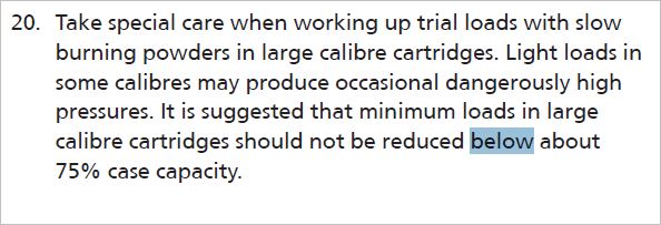

There are many ways you can reduce loads fore example
My 3006 AS50N 15gr 180 gr cast ~1600 fps
My 223 AS50N 7.6 gr 55gr SP ~ 2200fps
Also cropped straight out of the ADI loading manual.
Reduced loads 75% of Case capacity.JPG (39.94 KiB) Viewed 12687 times
And an extract from a letter sent to me from ADI when I asked about reduced loads.
Reduced loads 60% max 2206H.JPG (72.59 KiB) Viewed 12687 times
If your thinking about reduced loads consider using 2206H and Trail boss.
