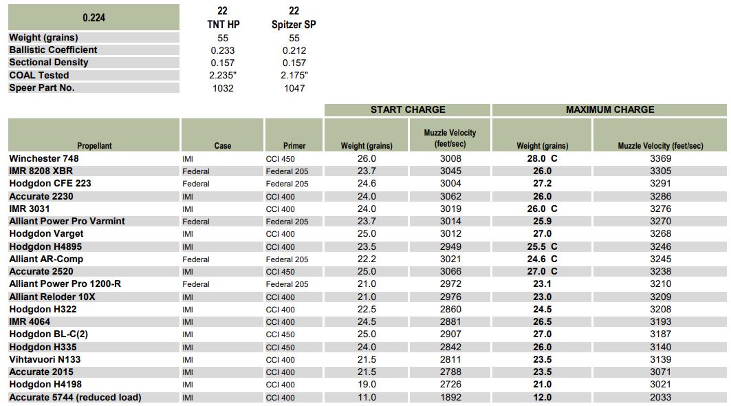

Sorry to drag up an old thread but a lot of people come to the site for info (perhaps without joining) and read what can be erroneous information.
According to ADI, bullet shape/type is extremely important to powder loads. There's discrepancies all over the place, but for ease, let's just use the 55g projectile the OP was asking about, and ADI AR2206H powder recommendations:
55 GR. Barnes TSX Flat Base: 21-22.6g
55 GR. Sinterfire: 22-24.6g
55 GR. Speer Soft Point: 25-26g
Basically a 5 grain spread across the 55g projectile types; according to ADI, at least, you should take into consideration the bullet type - not just weight.

Re: 223 55gr Sierra Gamekings
Post by bladeracer » 26 Nov 2020, 5:41 pm
Yes wrote:Sorry to drag up an old thread but a lot of people come to the site for info (perhaps without joining) and read what can be erroneous information.
I don't know what the Sinterfire is but the TSX is a monolithic copper bullet, very different to a copper-jacketed lead core. Sinterfire is lead-free so I suspect it is also monolithic. The Speer is a copper-jacketed lead-core bullet
Perhaps if you understood the bullets you are discussing you would better understand the load data.
Regardless of the load data any manufacturer offers, it it always just a guide. It has no reference to what maximum loads will be in your specific firearm loaded by your specific techniques.

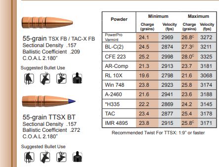

Post by bladeracer » 26 Nov 2020, 6:27 pm
Yes wrote:No, the post emphasised ALL 55g projectiles. Perhaps have a reread.
"G'day Witty4740,
The design of a jacketed projectile is pretty much irrelevant as regards load data, soft point, flat point spire point flat base or boat tail, the data is based only on bullet mass. Data for 55g projectiles is the same foe ALL 55g projectiles, but if you find yourself in a position where the weight is not listed then use data for the next HEAVIEST projie than what you have and you will always be on the safe side, Cheers."
His second statement about all 55gn bullets is a generalisation, but is still valid.
We are discussing load data, not actual testing in a specific firearm.
All load data are generalised, the people providing the data have no control of any of the external influences over those data. Also, do not regard ADI data as accurate, I don't believe they do any significant testing, merely use computer modeling.
For examp[le, Barnes' load data is 25.8gn of AR2206H (IMR4895)
Barnes .223 TSX data.JPG (44.89 KiB) Viewed 20050 times
Load the three bullets in your own rifle, using your own methods, and see what data you get from it yourself.
I happen to have received TSX and TTSX bullets today in the mail and will be testing them shortly, but in 7mm. I can test 120gn VMax alongside 120gn TSX but those are the only two I have of identical weight.

Post by bladeracer » 26 Nov 2020, 7:02 pm
As you can see now, the data listed for the monolithic copper TSX is 25.8gn of IMR4895 (AR2206H in Oz) making 3171fps (not the incorrect 22.6gn offered by ADI). It correlates very closely with ADI's 26gn of AR2206H (IMR4895 in the US) for 3315fps with the 55gn Speer SP - two _very_ different bullet designs.
Speer's data is 25.5gn of IMR4895 at 3246fps. Note also Speer does not differentiate bewteen their two different 55gn bullet designs, the same data are for the TNT and the SP.
Speer 55gn data.JPG (117.48 KiB) Viewed 20040 times

Yes wrote:I agree in theory. But having starting points for min and Max loads is vital and is bullet profile specific, not solely weight specific. Or a better way to put it, powder loads are bullet profile and weight specific (whether for safety or performance).
I'd also argue that minimum starting points are also as important as maximums.. And yes, my own experiences with hand gun loads tell me there is likely a good spread in either direction to remain "safe". But you wouldn't want to be loading up super low loads (projectile may not make it out of the barrel) in the same way you wouldn't want to go super high and get a kaboom.
Very few manufacturers list minimum load data, it is usually only listed in very specific circumstances, generally reduced loads of very slow powders, in large cases, with heavy bullets. Unless it is specifically stated not to reduce it they are just random starting loads, not minimum loads.
I load up lots of super-low loads that often don't make it out the barrel, it doesn't cause any problems. Generally I find the squib levels to be in the vicinity of 300fps to be able to make it out the muzzle - that's in anything from .22LR to .303.
I rarely load anything up to the point of seeing pressure signs, other than when I'm trying to determine where the high-water mark is. And yet some of my loads exceed ADI maximum loads, with zero pressure indicators.
Bullet weight is _by far_ the primary factor for charge weights, regardless of bullet design.
You don't shoot semi-auto handgun then. Double tapping a Glock that starts with a Squib would be a day you wouldn't forget.
Best case scenario, you need a new gun... Worst case, well, you can imagine.
We'll have to agree to disagree on the projectile profile... I prefer to be thorough and account for all controllable variables when it comes to reloading. Most data I consult also provides min and max - which we can both agree on, are good starting points, but are just that - starting points.
Yes

Yes wrote:You don't shoot semi-auto handgun then. Double tapping a Glock that starts with a Squib would be a day you wouldn't forget.
I shot IPSC with pistols for thirteen years, but have never used a Glock. I would not be double-tapping any load during reduced load development. Generally a semi-auto pistol squib won't cycle to allow a second shot, it usually requires the user to ignore the issue and deliberately chamber a second round and fire it. Making it a user failure, not an ammo or firearm failure.
You need to get out of the mindset that any source of load data is gospel, it is ALL just generalised options to give inexperienced reloaders some guidelines to get them started, that is all it is. With some experience you will find you no longer even bother looking for load data from other people, you can just generate your own through your own testing.
