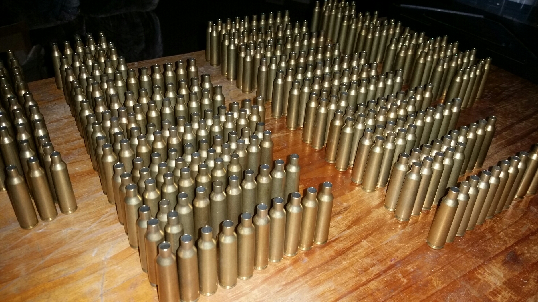

For those of you who weight sort their brass...
Ive just sorted over 500 cases into .1 grain lots...
Sorted...
2018-03-14 18.16.03.jpg (1.45 MiB) Viewed 9402 times
(Looks like the north korean army marching over the table... :lol: )
In this instance there is a difference of 10 grains from the lightest to the heaviest over 400 cases.
So im curious to know what do you group them in/how do you group them/what do you consider to be too large a spread...?... (for example lots of 3 grains, or .3grains)...?
Once weight sorted, do you go to the extent of checking volume...?
And does that grouping differ for varmint vs target shooting for you.
Also, at what point of weight difference do you test for different charge weights...? (I guess this may differ for different cartridges, but interested to hear what you do & for what cartridge(s)).
And finally what do you do with the extreme stragglers...? (For example the few extreme light & heavy cases--in this case i have quite a few).

There are a lot of depends in that question. Like how many fall into each group. 10 grains is lot for any case I would have thought. I weight sort but dont get that sort of spread but pay for the privileged up front as the manufacturer weight sorts. I am looking to put boxes of 50 together as I normally shoot 36 or a few more in a session. I then keep that 50 together for its life. i usually have at least two boxes of the same usage and age close weight so I can move from box to box without difference. Also 50 is a good number to process at one time. If I have stragglers which I get when I weight sort projectiles I put these aside in bigger weight difference groups and use them at practice days rather than club comp or higher level comp(less spread less usage).

Post by Stix » 14 Mar 2018, 7:26 pm
Thanks sungazer...
Yes i also keep lots of 50 for everything...
The 10 grains is an extreme...
Out of that lot of 400 there are 200 that are within 1 (one) grain of each other--they are the 300 in the middle naturally...
So what do you group in/weight difference within any given lot of 50...?

Post by marksman » 14 Mar 2018, 8:15 pm
the old benchrest rule was batch all within 1/2 a grain, lighter and heavier cases together
I don't bother to much now unless the cases come from various places
I do the volume check but usually only an average and on really good brand cases
by weighing the cases you are assuming that the cases are the same and the internal volume will also be
trying to be consistent and getting things as close as can be identical
so your shots will be identical :allegedly:
got to say well done good job there stix :thumbsup: :drinks:

Re: Weight sorting brass
Post by Stix » 15 Mar 2018, 10:38 am
So Brett well all you blokes actually, out of curiosity...how do you batch proj's when there is both weight & distance of ogive to base to take into consideration...?
Also is it worth me atleast just quickly weight sorting the proj's...?
Post by sungazer » 15 Mar 2018, 10:58 am
Brett will do things different to me as he is using bigger projectiles that may have bigger differences and different changes in the projectiles may have different effects in different guns and disciplines. That sounds like a lot of disclaimers.
For me I overcome the different length ogives by seating well off the lands so that a few thou difference is not a large influence in the overall measurement. Weight sorting projectiles when the maths is done for a 155grn is not worth the predicted outcome. However that doesn't stop me from doing it. It gives you more confidence in your shot placement if you believe you have done everything possible to stop the odd one out. What that means is not shot is a flyer and every shot on the paper has a meaning. When you have that confidence in your shots its either you or the wind so you can adjust your aim to get more shots on the centre.
Sorry that didn't answer your questions. so for me I only sort on weight. I sort down to the milligram as that is the resolution of my scales. However they only have a accuracy or linearity of 2 milligrams so in reality I am sorting to +/- 2-3 milligrams . If there are ones that are outside the SD (the bulk of the projectiles) you should notice there are a lot in the middle range and there are less numbers as you move outside that middle range. Then any that are well outside that just go in the one group to be used at home for sighting in or fowling the barrel before a comp.
