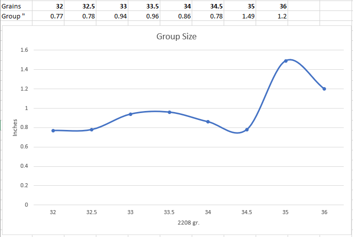

Post by YoungBuck » 08 Apr 2018, 10:36 am
Just rounding off this thread, I hit up little river yesterday and put the rounds to the test (4 shot groups) then had some fun putting cheap PPU rounds onto the steel plates out at 450m :D
For those interested below are the group sizes. The low powder loads surprisingly shot very well and the grouping picked up again with the 34.5gr rounds.
I suppose the next step is to experiment with smaller changes in charges at the lower end (32-33gr) and around the 34.5gr mark.
Edit: forgot to mention there was no sign of over pressure in any of the cases fired :thumbsup:
YoungBuck
