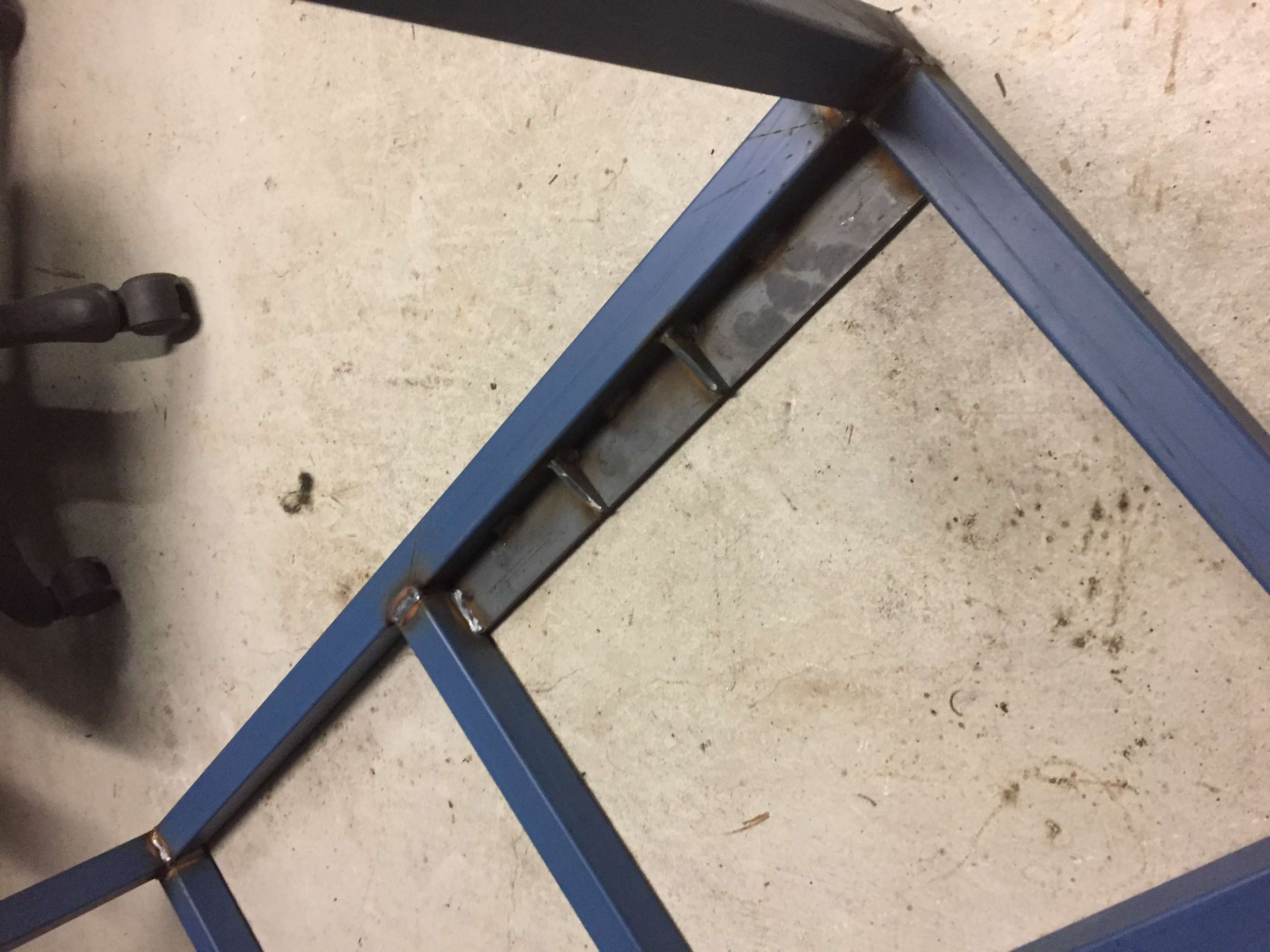

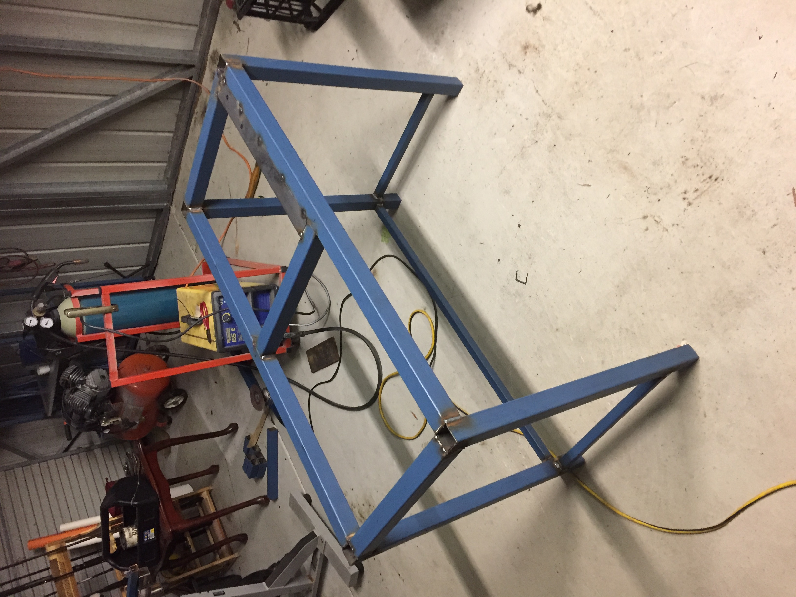

i have digital scales with my press kit, o a little bench movement shouldn't matter.will have the bench bolted down as well. started welding up a frame for my bench this afternoon,40x40x1.6 RHS box frame, with a section reinforced with 1/4 " flat bar where the press is to be mounted. gusseted as well. it's probably over enginered, but i am known for that OCD quirk. will post some pics up soon if anyones interested :thumbsup: :drinks:

i'm a sheetmetal worker by trade , so slapping this together with a mig welder and a 5" grinder isn't outside my skill set :lol: if it gives other folks some good tips or ideas i'm all for it :thumbsup: some guys put pics of their home made portable shooting benches on here some time ago which i thought was great. but one fella camo painted his and had a hard time finding it :lol:
a veiw of the back off the flat bar/press support showing simple gusset's welded in to prevent flex
frame all welded, still gotta grind it up for a neater finish. on the right side you can see a section of 6mm x 50mm flat bar added for support where the press is to be bolted

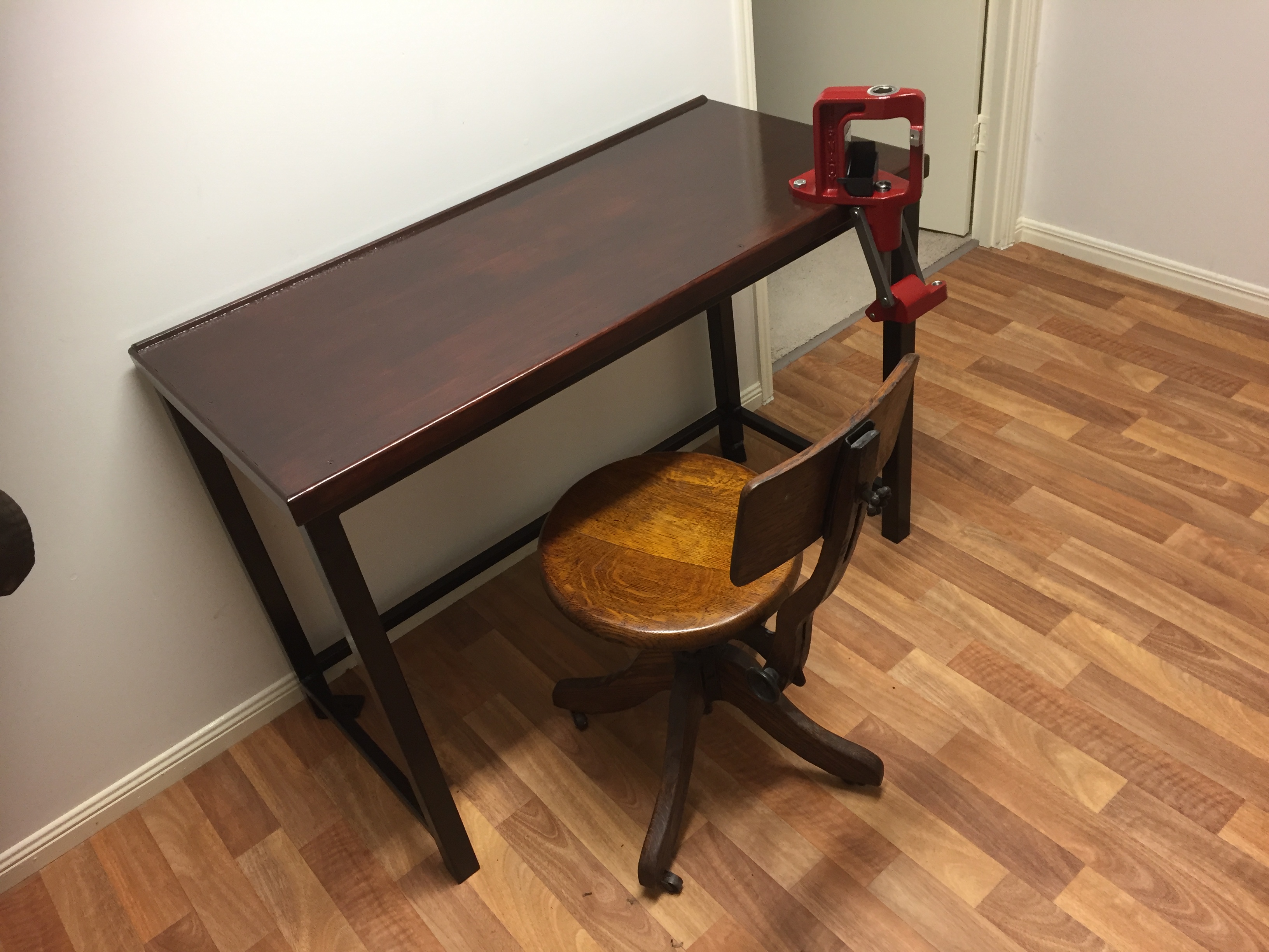

foam ply OB ? please enlighten me . i was going to use 25mm marine grade ply screwed down with the screw heads recessed, and get some trim mouldings for the edges and stain and estapol/ varnish the woodwork . steel will be painted in gloss black engine enamel i got (leave it out in the sun for a few days and it bakes on almost as hard as two pack paint) i realise i might be getting carried away, but i have had all these materials on hand so i really hasn't cost me stuff all. it's the car/hot rod thing comin'out in me that i did for years.gotta customise stuff. any ideas or advice would be appreciated. will post more pics as this project progresses :drinks:

Post by bigrich » 17 Apr 2018, 7:14 pm
okay, found some marine ply, half a tin of one step stain/varnish and some satin black enamel in the shed. $25 worth of pine trims, nails and pva glue from the big hammer store and bingo ! one reloading bench. just got to bolt it down now and i'm gunna start prepping and cleaning cases. dunno if they would cover making a reloading bench on "better homes and gardens" :lol:
the new hobby bench

Post by Oldbloke » 17 Apr 2018, 7:19 pm
Bloody hell. That's dam flash.
