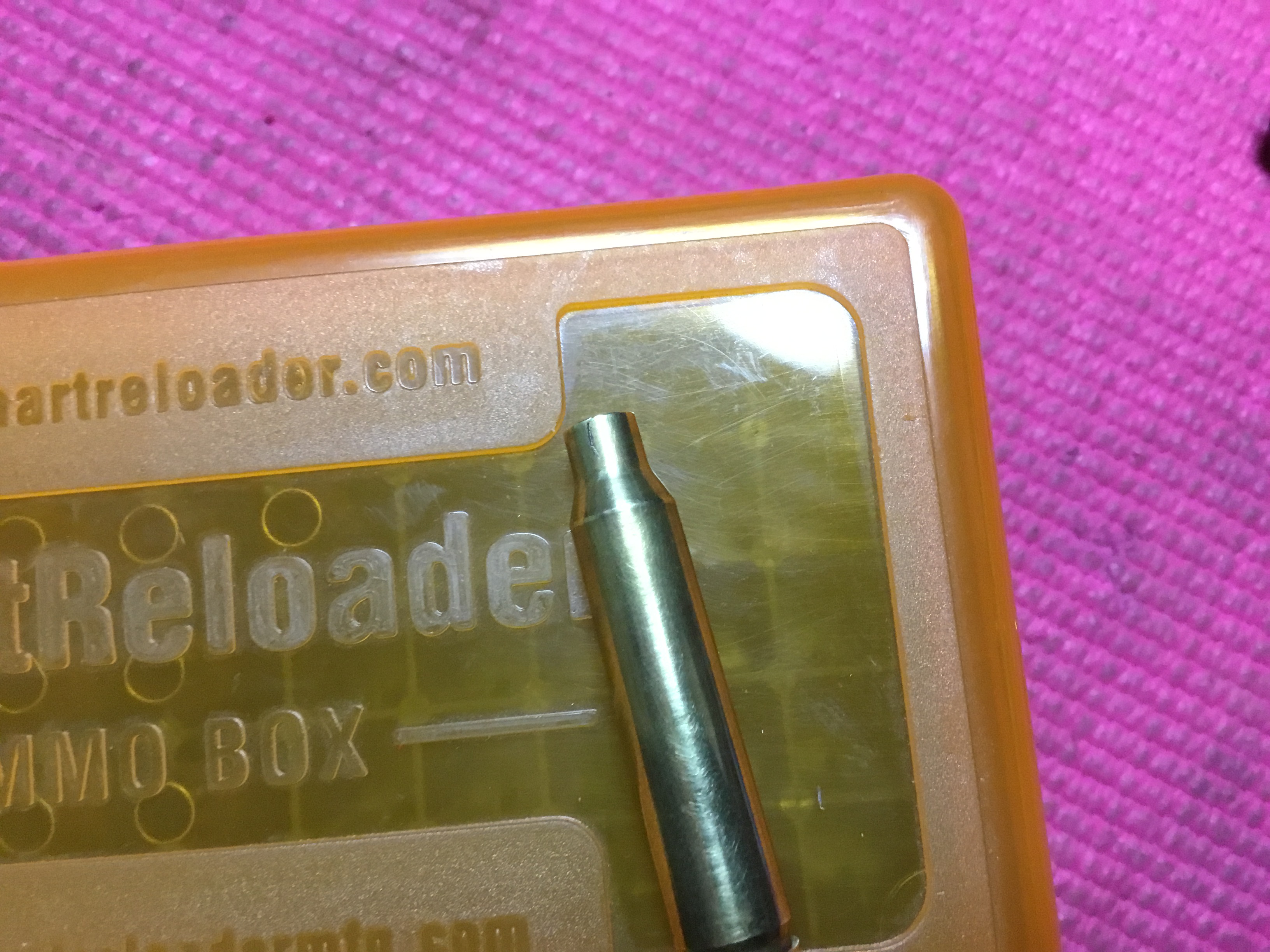

Post by flashman » 15 Apr 2018, 9:04 am
Hi just wondering if any body crimps 223 rounds ,why I ask is because went to the SSAA range got set up opened a box of reloads, I had 1 round that was pushed back into the case, now didn't use that box ,when I got home use my RCBS bullet puller to check neck tension ,bit crude all felt tight ,so collected the bullets ,powder and reassembled them , ok where did I go wrong it never happen before......... :?:

Post by Bills Shed » 15 Apr 2018, 10:46 am
If it was only one in the box that was visually set back in the case, I would have a really close look at that case neck. You may find a crack. Push a projectile in the neck point first ( this will put some pressure on the neck to open up) and use a magnifying glass to inspect the neck.
One set back projectile in a box of reloads does not mean they are all faulty, expecialy if you have done this many times.

Post by flashman » 15 Apr 2018, 11:11 am
Hi Bill, haven't check for cracks , I inspect them all after a good tumbling and most of the time there in a serviceable condition ,could of be a hair line fracture I missed ,will give it a good looking over and report back ,thanks........... :shock:

Post by flashman » 15 Apr 2018, 11:59 am
flashman
Posts: 422
Re: To crimp or not to crimp 223
Post by flashman » 15 Apr 2018, 12:09 pm
Hay Bill u were spot on thanks will take more care after 5th or 6 reload in my inspections ...... shoot lots ,have fun :)

Post by Bills Shed » 15 Apr 2018, 1:17 pm
Problem solved. All good

Post by flashman » 17 Apr 2018, 7:48 pm
Scj429 ; good point, but no the case did have a split in the neck ,and neck tension would of been compromises, so the plane is to aneal more often between reloads maybe 3&4th loads .... :)
