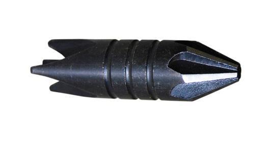

Are you using an inside and outside reamer. Maybe Purchase boat tail projectiles.I had Problems with flat base bullets in my .222 years ago
Re: .223 bullet seating issues
Post by duncan61 » 17 Apr 2018, 8:45 pm
I mean a case mouth chamfer.I have learned something new

Post by duncan61 » 17 Apr 2018, 8:50 pm
One of these :D
Post by duncan61 » 17 Apr 2018, 8:52 pm
O.K good luck

More deburring on the inside with said tool
