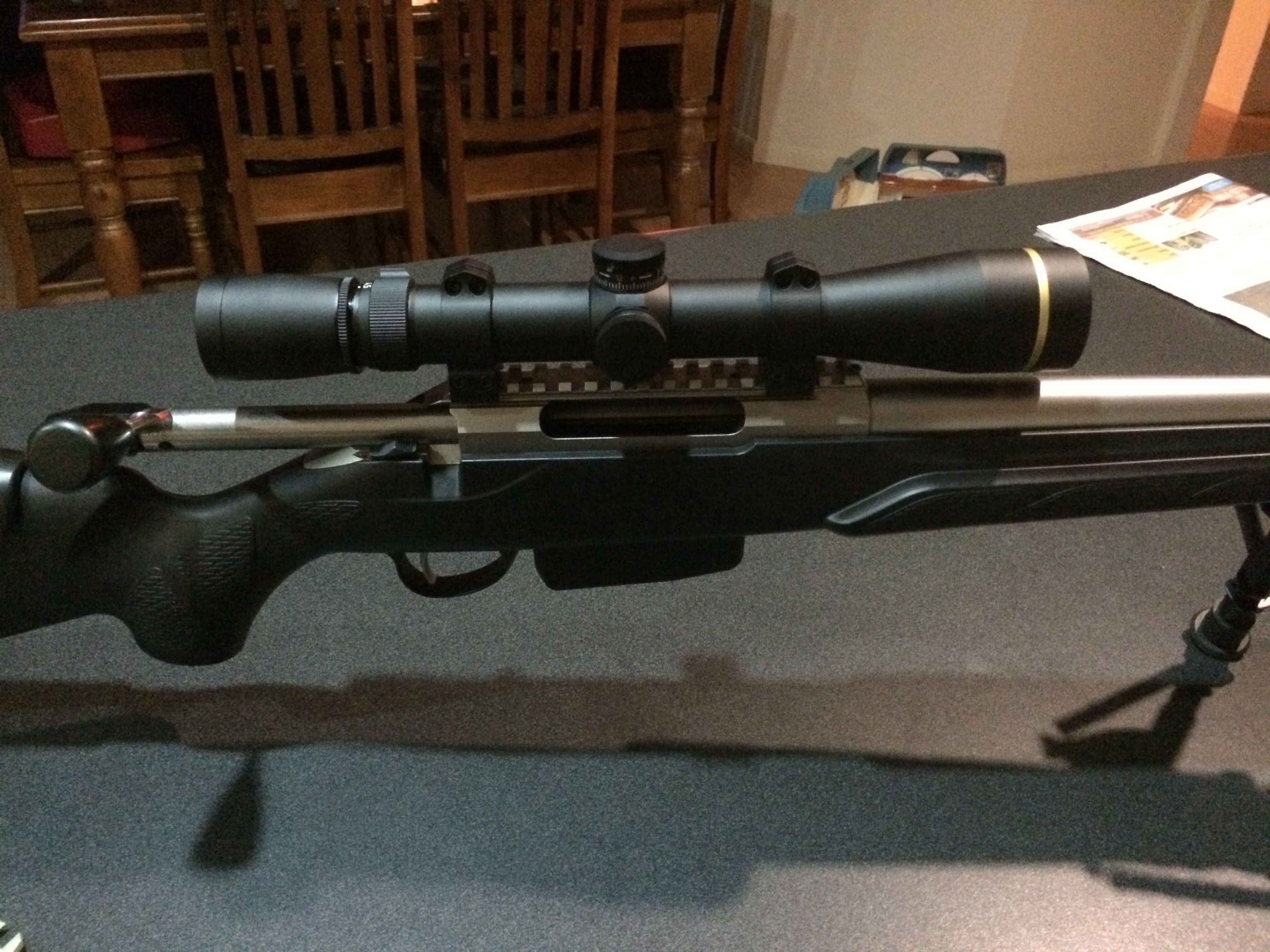

Post by bigfellascott » 19 Dec 2016, 8:34 am
I went with the Leupold mounts on my T3x with a 3-9x50 objective it's a nice fit (might have been medium height rings) can't remember now but will try and have a look at the pack. I did try the T3 rings they gave me but they were just a little low unfortunately.

Post by Monty » 19 Dec 2016, 12:47 pm
Perfect fit there :thumbsup:

Post by bigfellascott » 19 Dec 2016, 1:17 pm
Monty wrote:Perfect fit there :thumbsup:
Yep suits this blokes fat melon well. :lol:

So I mounted a Leupold 3-9x40 with the DNZ low mounts without any problems. There is 5mm clearance at the objective, and about 3.5mm where the taper starts down to the main tube because of the barrel profile (see bigfellascott's photo.) The rings are perfectly aligned and lapping probably wouldn't be worth the effort.
