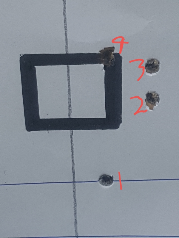

I have a Hawke Sidewinder 10-50x60 scope mounted on my Howa, 24", 1:9 fluted bull barrel, in an XLR Element chassis.
This setup has delivered very satisfying performance even with my mediocre skills.
The first pic is a 5 shot group at 100m using Nosler 50gn Ballistic Tip projectiles. The pills and the cases were weight batched to get things as consistent as possible. I apparently got a little excited and pulled hell out of the 5th shot.
With the drought and Calicivirus wiping out the rabbits here and the foxes apparently starved out, the rifle has been in the safe for the last couple of months until last week when I decided to take a few target shots at 200m just because there was no wind for a change. The results were inconsistent with uncharacteristically large groups and stringing both vertically and horizontally, so I put it away and waited for another calm day to test at 100m.
Nothing has changed, the scope rings are tight, the bolts mounting the action to the chassis are tight, the small rails bolted to the action, on which the rings are mounted are tight, and the ammo is from the same batch as in the first pic. The Hawke Sidewinder has removable turrets, allowing the user to change from the standard quarter inch per click to one eighth, the locking rings that hold the turret to the scope were also tight. I was shooting off the bonnet as usual, with a rear bag to try to remove any variables my wobbles and tremors might introduce.

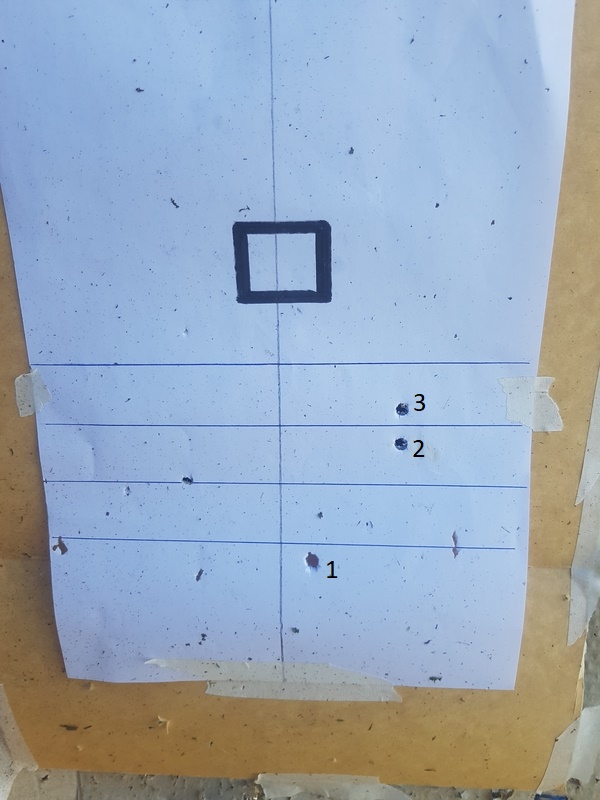

The second and third pics are the results at 100m today.

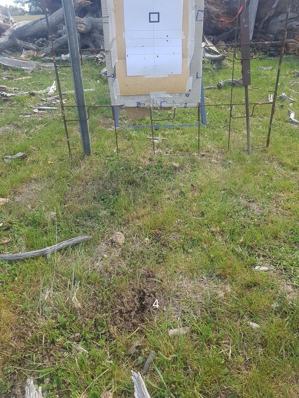

With the scope set at the 100m setting recorded in my range notes, I fired shot 1, it hit 4.5 inches lower than expected. I dialled 6 clicks up, fired shot 2 and it was as much higher as expected but off an inch and a half right, I then dialled another 6 up and fired shot 3 which was only half an inch higher. By this time confusion was setting in so thinking that my elevation turret was sticking, I wound it all the way up, all the way down and back to the 100m setting and fired shot 4 which hit the ground a full 18 inches lower than shot 3 and back in line with shot one, at which time I gave up in disgust. There was no wind to account for the movement to the right.
The only thing I can imagine with all other things being as they were, normal, is turret failure or perhaps something even worse.
I would greatly appreciate the input of anyone with a clue as to WTF is going on here.

Post by Wm.Traynor » 06 Oct 2018, 7:38 pm
The only faint hope you might have is if you note exactly where the turrets are in their adjustments and wind each turret, first one way to the limit back to the opposite limit, then back to their original settings. Sorry to sat it never worked for me. Otherwise it's a warranty job.

Post by Gaznazdiak » 06 Oct 2018, 7:58 pm
Wm.Traynor wrote:The only faint hope you might have is if you note exactly where the turrets are in their adjustments and wind each turret, first one way to the limit back to the opposite limit, then back to their original settings. Sorry to sat it never worked for me. Otherwise it's a warranty job.
Damn, that was the first thing I tried. Only made things worse.
What I can't get my head around is that it went from surgically accurate to absolute sh!t while it was sitting in the safe, not dropped or bumped or anything.

Post by Member-Deleted » 07 Oct 2018, 1:23 am
Gaznazdiak mate i'm not familiar with the scope but have you checked the screws on the rings and mount
to see if any have loosened or broken ?
A bloke I know had a similar problem and found one of the mount screws had snapped probably was over tightened by the gunsmith or
shop owner
Probably not this but worth a look could save you some dollars

Post by Gaznazdiak » 07 Oct 2018, 9:41 am
pomemax wrote:When it was sitting in safe did you give it a good oiling when you were not using it ?
Yes I have had scoped do the same thing cant explain why that,s when i got it back to where it should be I started bore sighting after it was right and keeping a record of position and believe it if i don,t use a particular rifle for some time some will move not all .
Did you check the focus control for parallax?
Yes mate I did give it a good oil before putting away, but I dry patched it all out before firing the 200m shots, then put it away again for a week as is.
What I don't understand is the massive difference in 7 days sitting untouched. I treat it like it's made from egg shells, the biggest impact it ever gets is the tiny recoil from the mild .223 loads I use.
I also spent the time when I first installed it, testing to generate range notes for 100, 200 and 300m, so I just have to consult them to know what to dial up for each range and that has served me well until now. All other variables removed, Occum's Razor has it looking like some internal drama or turret problem.
As the turrets are easily swapped I'm hoping that is the culprit.
GB
Yes mate, I checked them all after the 200m last week were unusual. All tight, none apparently broken.
I'm going to pull everything apart today and put it back together from scratch, rings, rails, scope out of rings. Can't make it any worse.
What really put the wind up me was dialing six quarter inch clicks up and seeing it impact 18 inches low.

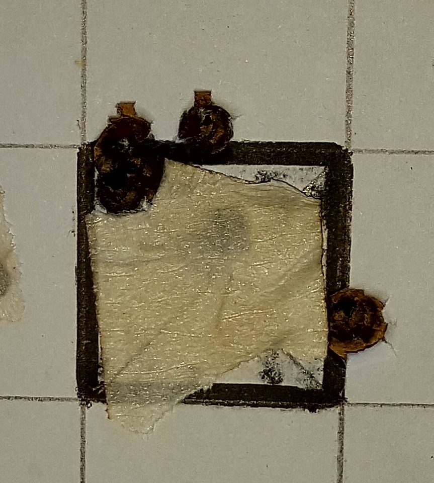

Post by Gaznazdiak » 07 Oct 2018, 2:36 pm
"Curiouser and curiouser" cried Alice.
I only had one Nosler 50gn left so I used their 70gn RDF with 24gn 06H. I haven't had the opportunity to tune a load with them yet.
I wound the elevation turret to the top, wound it to the bottom counting 201 clicks, counted back up 100 clicks, set the 100m setting for the 70gn Nosler and fired shot 1.
I then wound 6 clicks up and fired 2, 3 and 4 in a gusty 20kph wind quartering from behind left.
Glad I didn't go all OCD and dismantle ot all.
