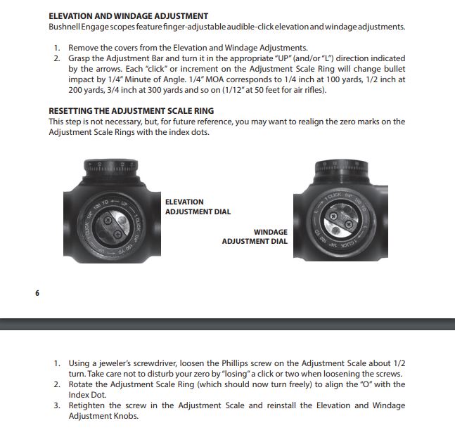

How do I zero the turrets on a Bushnell Engage ?
Both windage and elevation turrets have caps only to reveal a wedge with two small phillip screws which appears to be holding down the turret .
Do I need to unscrew the wedge ?
Seems a bit odd cause those screws would be far too easy to strip. I've tried pulling up on the turret thinking it may be a click type but it ain't.

Looks like you're on the right track.
Bushnell Engage.JPG (71.07 KiB) Viewed 2160 times

Bugger. PIA.
I wonder if I can convert them to their one-click zero set .
