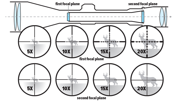

FFP keeps the reticle a constant size regardless of magnification. You only need the reticle to be constant if you are using it to range targets or for holding-over. In competition you won't be ranging your targets and you certainly won't be holding-over.
SFP the reticle stays a constant size. FFP the reticle increases/decreases in relation to magnification but the subtensions remain the same regardless of magnification.

In FFP you are magnifying the reticle as well as the field of view as you increase magnification, because the reticle increases size with the magnification, the subtensions also increase thus the math stays the same.
In SFP you are only magnifying the field of view, the reticle stays the same size. Because the reticle does not get magnified, the subtensions are different at different magnifications. In my scopes the holdovers are correct at 18-power, at 9-power the holdovers are twice as much, at 4.5-power they're four times as much. As long as you remain aware of your magnification you can still use the reticle for ranging targets and holding over.
At 18-power the top of my post is 15.4 minutes of holdover, at 9-power it's 30.8 minutes, at 4.5-power it's 61.6 minutes.

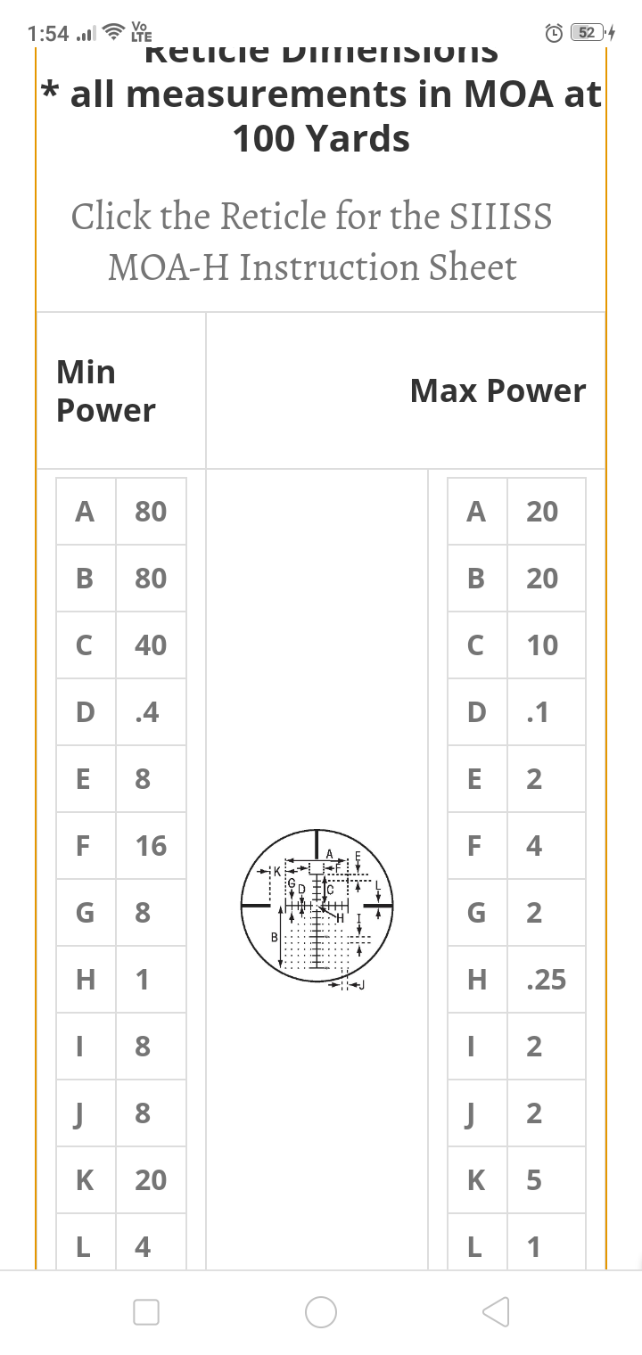

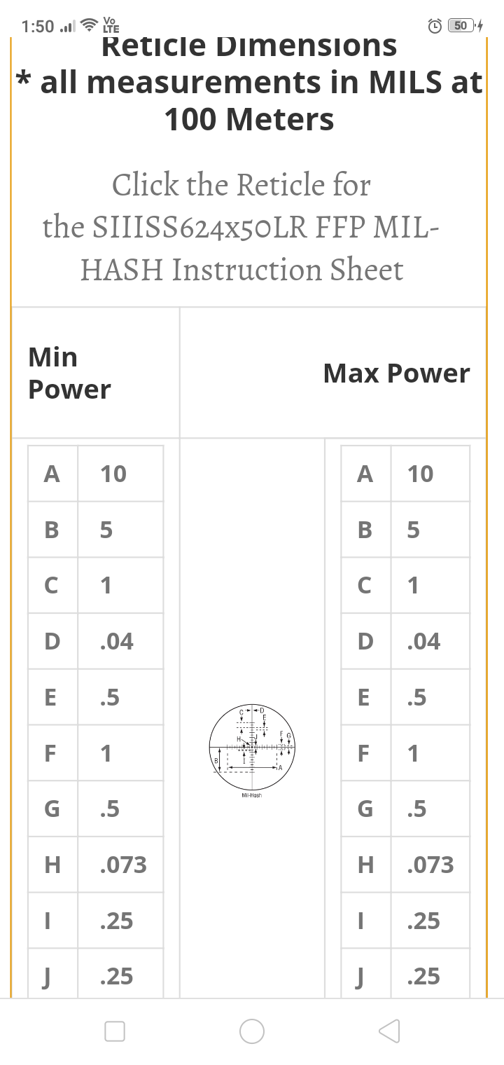

bladeracer wrote:But the primary reason to prefer SFP for precision shooting is the fine reticle, whether you're at 4-power or 24-power. You can see the difference in the picture I posted. You can also see how the holdovers change as magnification does.
My FFP reticle thickness is a constant .054 mils (5.4mm @100m) regardless of magnification.
Your SFP with a reticle thickness of eg .125 MOA on max power 18x (3.64mm @100m) is actually 3 times thicker than mine at minimum magnification of 4.5 power (16.37mm @100m)
I think we have come a long way from your original intent though and everyone is free to use what best suits them.
I would only be using minimum mag while I'm walking in and out of an area, to deal with immediate shots of opportunity, where the heavier reticle is a good thing. My reticle is .25MoA regardless of magnification, 7mm wide at 100m (I have confirmed this myself), 35mm on a fox at 500m, 70mm on a deer at 1000m - whether I'm on 4.5-power or on 18-power. I just checked it here at my desk, at 2400mm range the reticle covers far less than 1mm, possibly less than a quarter-millimeter (hard to be precise as it doesn't focus closer than 10yds) - the entire height of the reticle from crosshair to the post - 62 minutes at 4.5-power - covers about 50mm on a tape measure hanging on the door of my safe. On a snap shot at a fox at 20m the reticle covers 1.4mm of the fox, but is still heavy enough to pick up quickly. I have looked through scopes in the field with .14MoA reticles and they are far too fine for me to pick up against grass or trees, or anything other than white paper.
As you zoom in an FFP though, the reticle grows in size to conceal more of the target. Its angular dimensions don't change, but the coverage of the target does. Put your scope on a tape measure hanging at 20m and tell me what width the crosshair covers at minimum and maximum magnification, I'll try to remember to do it tomorrow myself, I don't think I've ever checked it under 100m. For me, FFP is the reverse of what you want, a heavy, easily-seen reticle at minimum magnification for snap shooting, and a finer reticle for precision at longer ranges.
I totally agree it's personal preference. FFP costs a premium though, so it's well worth determining that it is what you require before lashing out the funds.
Re: FFP Vs SFP for Target shooting
Post by wannabustbunnies » 08 Dec 2019, 1:09 am
Your reticle can't stay the same thickness regardless of magnification with a SFP scope because of where the reticle is physically located in the scope. Your BDC subtensions change depending on your magnification as well which have pointed out previously so you can't have one without the other.
If your reticle is .25 MOA at 18x and you have a 4.5 X erector SFP scope everything changes by a value of 4.5x because you are only magnifying the image.
A FFP the reticle and image increase/decrease in relation to each other.
In your image above look at the reticle positions relative to the deer. The FFP stays the same whereas the SFP starts out wider than the deer and moves inwards as the power is increased.
Here is two sets of reticle subtensions from Sightron. Both 6-24 power scopes so 4x erector, one is FFP the other SFP.

Bladeracers image is a little misleading because it makes it look as though the reticle weights are pretty much the same at low magnification whereas the reverse is mostly true. FFPs only really suffer at low magnification because the reticle is TINY. From what I can gather - most FFP reticles are set to weight towards the upper end of magification, not the bottom.
Wannabustbunnies - I think Bladeracer was saying that the SFP reticle stays the same regardless of magnification 'in relation to the scope FOV'. Not the image. ;)

Look at the cross section diagram of a scope put up by bladeracer and note the difference in physical distance of either reticle the user's eye.
It should be immediately apparent the advantage FFP confers is a reduced susceptibility to inaccuracy due to minor variations in the shooter's eye position.
