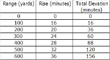

Post by straightshooter » 17 Feb 2021, 7:30 am
Melb
For the sort of ranges you are contemplating the attached table might help.
It is for standard velocity ammunition. HV will offer little or no advantage.
The most important point to understand is the projectile, due to time of flight, will be very wind affected.
For example, at 400 yards with a 10 mph cross wind you will need to adjust about 13 minutes.
So in order to have that amount of adjustment available in your scope, irrespective of what you might think the scope specs tell you, the elevation adjustment will need to be approximately centered due to the inherent mechanics of the adjustment system which is a limitation of most scopes. Also the scope will have to had to have been accurately centered for windage initially so as to have maximum available adjustment in either direction.
This isn't the province of most inexpensive scopes.
You might consider investigating scopes with true wide elevation and windage adjustment ranges to avoid frustrations in your endeavour.
Good luck.

Re: Running out of elevation adjustment (22lr long ranges)
Post by bladeracer » 17 Feb 2021, 12:23 pm
straightshooter wrote:Melb
Good luck.
Have you calculated this from the actual trajectory of a specific load?
CCI specifies a BC of .110 or thereabouts for their Std Velocity 40gn bullet at 1070fps.
I use .165 as it follows the real-world trajectory out to 300m. Past 300m, the trajectory steepens (for me at least) but group sizes at those distances make it difficult to precisely measure the drop, or velocity, to calculate the BC. I'm building a steel box to protect the chronograph to allow long-range velocity measurement. At long ranges, the bullet is coming down very steeply, requiring the chronograph to be mounted at a corresponding angle.
