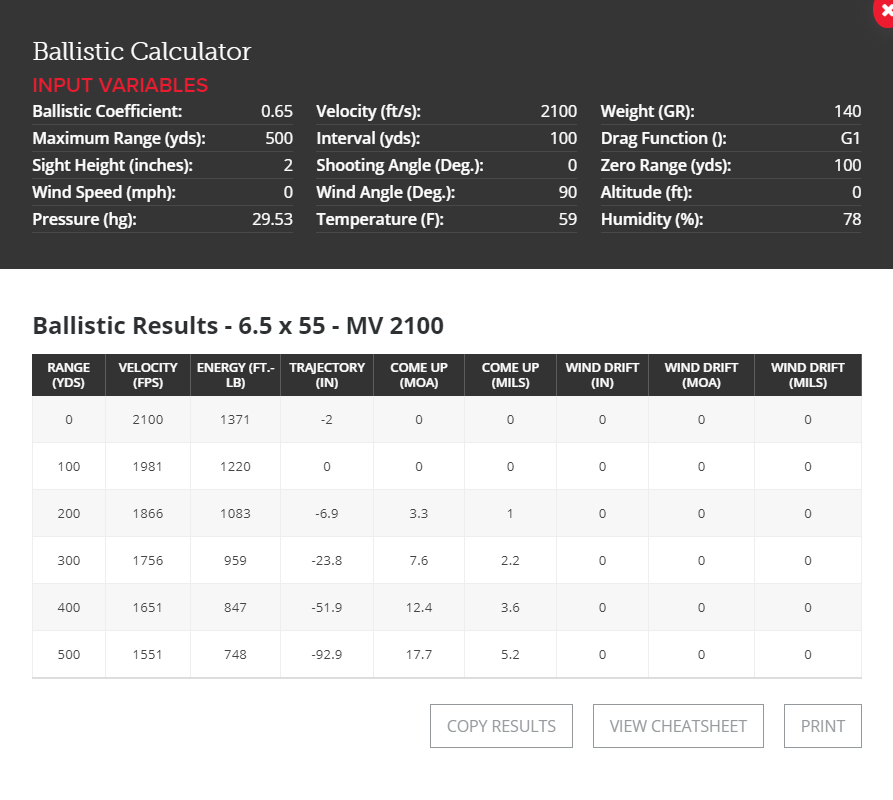

Here's what I came up with:
Reticle - Dead Hold BDC-PA
For your load:
140gr, 0.65g1, 2100fps

Post by bladeracer » 06 Apr 2021, 6:22 pm
As In2anity said, 2100fps is quite low for the 6.5x55mm.
Using the subtensions he posted:
100m zero
1.5MoA=142m
4.5MoA=211m
7.5MoA=272m
11MoA=341m
I would zero at 200m (120mm high at 100m):
200m zero
1.5MoA=233m
4.5MoA=294m
7.5MoA=350m
11MoA=412m

That reticle is far more appropriate for a 140gr @ 2700fps, i.e. a factory/power 6.5cm load. 100yd=0, 200yd=1.6moa, 300yd=4moa.
Nevertheless if your rifle is indeed the venerable 6.5 x 55mm Swedish Mauser, 36gr of AR2208 under that 140gr Nosler will yield somewhere between 2500 to 2600 fps. Then just zero her at 130yds, making the first subtension match 200yds, and second subtension match 300yds. Then anything under ~150yds; just point-and-shoot!
