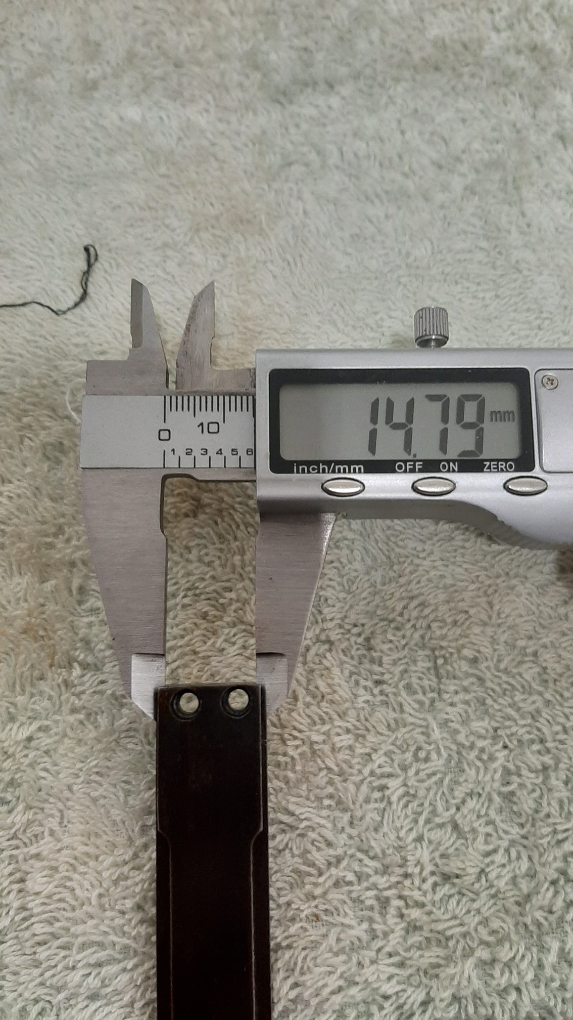

Are the dovetails always sized from the smallest width? I guess the 14mm sizing is very approximate given its 14.8. Questions I've wondered and had trouble finding answers for some reason

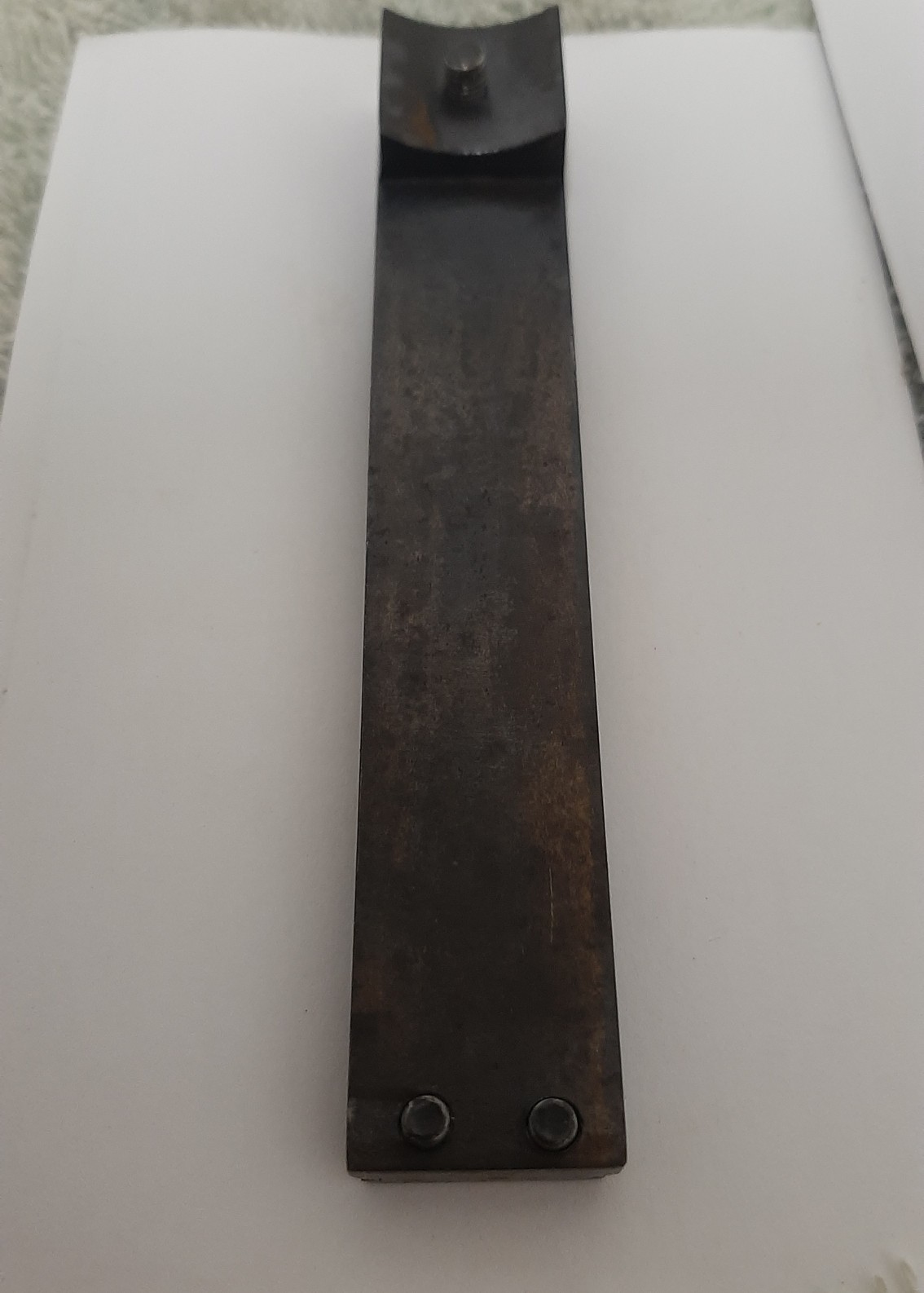

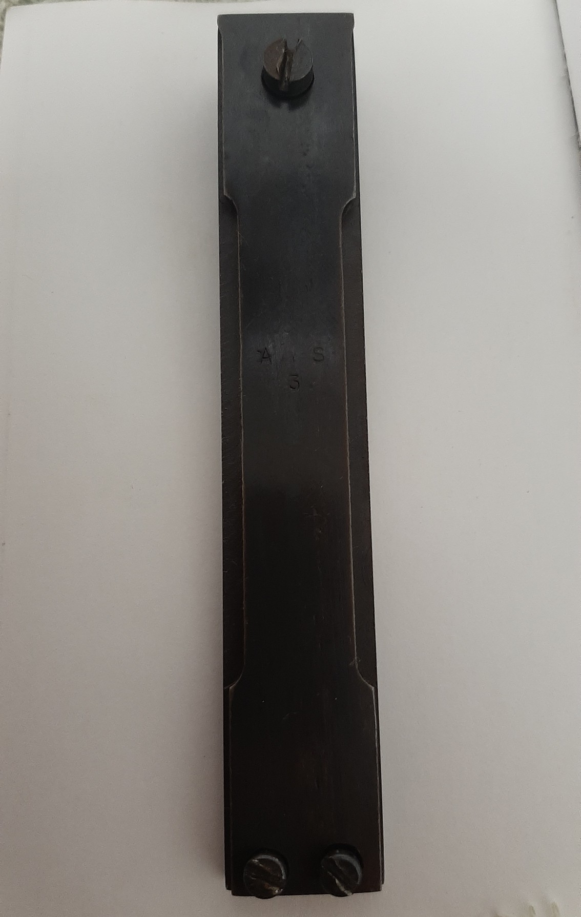

Thanks mate, took a couple of pics of the base. Nothing stamped on the underside, AS 3 stamped on the top side

With the benefit of the additional pictures I can see I got the maker of the base wrong.
I have no idea of the maker of the base but as a guess the letters A and S suggests an Ausinel Scope mount but it could easily be some other long forgotten maker.
Be aware that the screws and threads are very likely BA.
The ugly screw heads can easily be repaired by gently hammering the burrs flat with a small jeweller's hammer.
