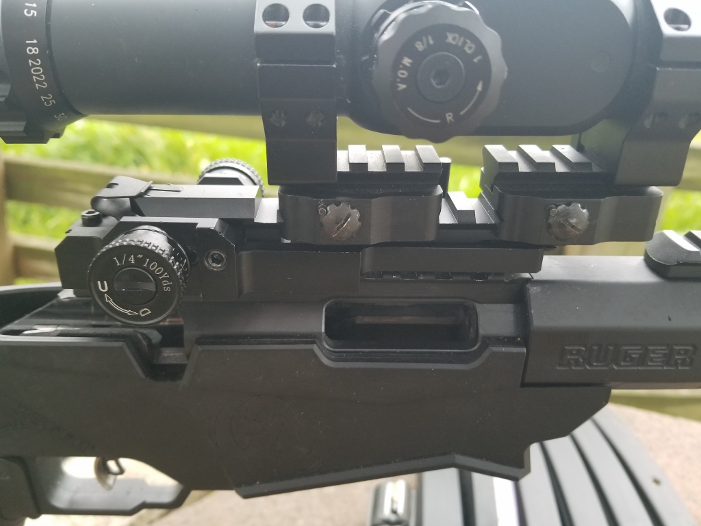

I like adjustable mounts and bases :-)
I want to see how precisely it tracks more than anything else, and I can't make it myself for $200.
It's not rated to handle recoil, especially not with an enormous scope strapped to it. Would likely be fine on low-recoil centrefire rifles, but they shoot so flat they wouldn't need this, this is more for mortars :-)
The 10-40x56 Visionking has a total of 42-minutes of elevation adjustment, so I can't even zero it on the RPR's 30MoA rail under 100m. This gadget is supposed to give me 90MoA of elevation.

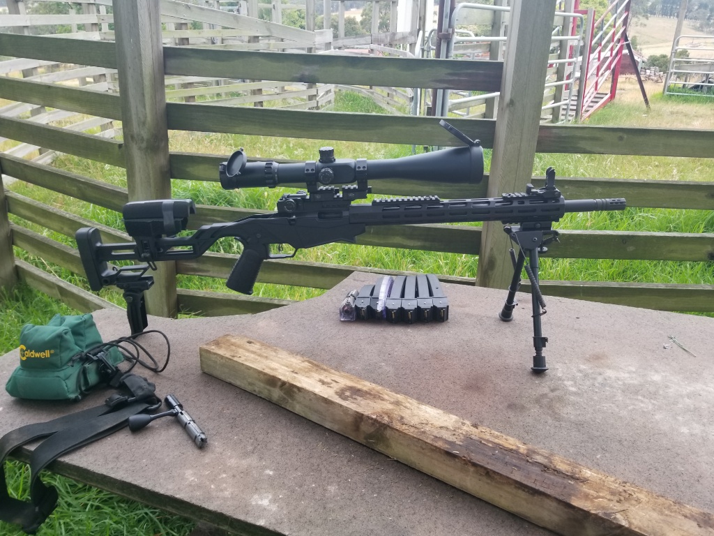

It's very, very, very windy and quite wet today, but I couldn't resist a quick play with it :-)

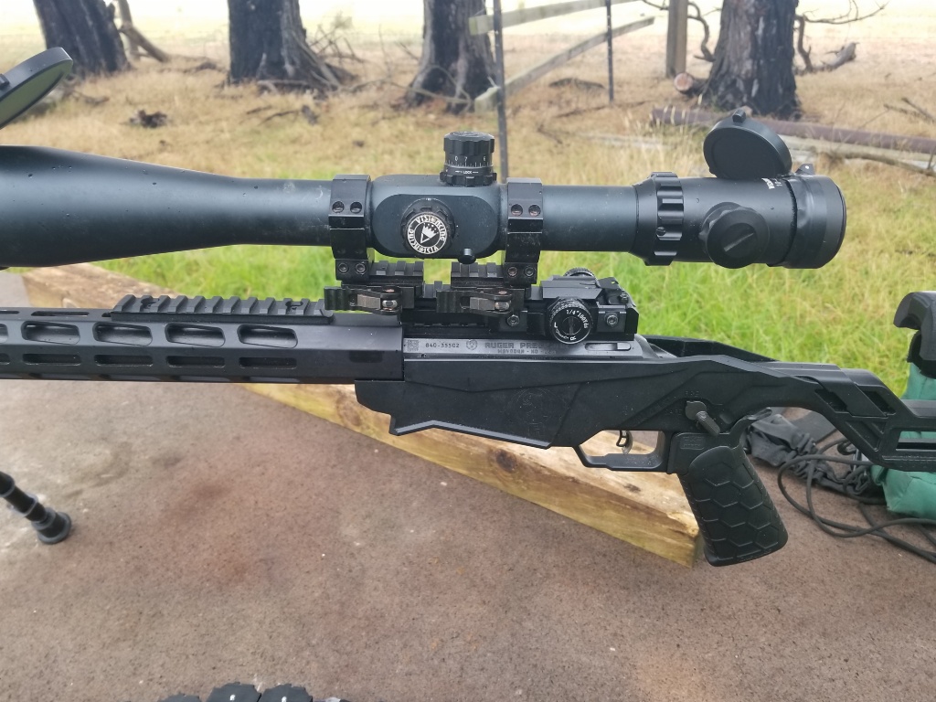

First up, it has a very short rail so I had to use QD risers to get enough rail length to mount the scope. A smaller scope that lets you get the rings closer together would be okay. Even with the risers the scope is lower than my normal scope mounted on the AR15 rear-sight carry handle. I didn't measure the height but I had to drop the comb a little.
Then I bore-sighted the rifle at about 50m as it's too windy to set up even steel targets. The RPR's rail gave me a zero about 150mm low, at the bottom of the scope's turret. I brought the rail up 42 clicks, or 10.5MoA to get me zeroed, nice so far.
I had a 200x400mm plate still standing at about 183m, everything else had blown over. I checked my DOPE sheet for Eley Standard and dialed up another 100 clicks for 25-minutes. Annoyingly, it is set up for 11-minutes per revolution, so two revolutions plus 3MoA. It doesn't have a zero stop either, though the turrets are resettable. So my current zero is one revolution up from the bottom, then back two clicks, annoying but not a deal breaker.
I allowed about a plate width of wind from the left and sent one. I didn't see a splash but I might've heard a faint ding over the wind howling through the pines just above my head. A second shot gave me a nice splash on the steel. Very impressive, but it could be a fluke. I fired three more to empty the mag with one more clear hit.
I wound the dial way up, too far to bother counting the revs, but it does have plenty of adjustment in it.
When I get some calm weather I'll give it a good test to see how well it tracks as I wind it up. I might build a frame 2m tall to hold a strip of paper and see how close each group is to the centerline as I dial it up 5MoA at a time. 100MoA is 1454mm high at 50m which is close a 450m zero, and 500m zero only needs around 1620mm high at 50m.

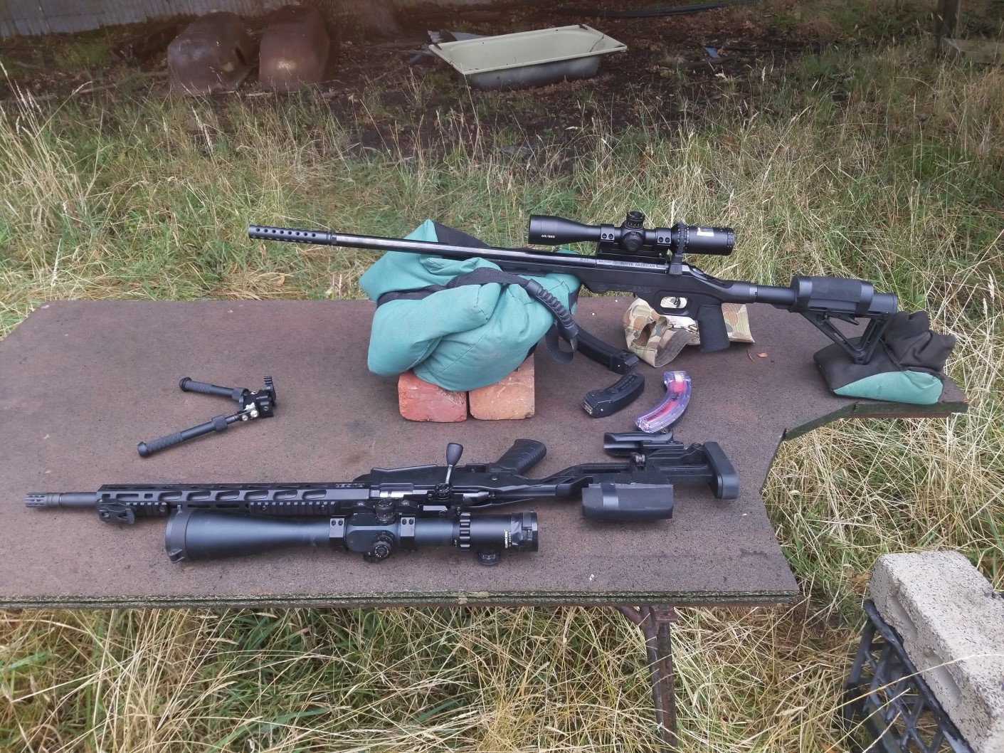

Yesterday, I measured the scope above bore at 3.145", built the target, loaded a stack of mags, got the rifle out, did the trajectory chart...then decided a 5km bush walk with the grandkids would be more fun :-)
Annoyingly, it was more fun, even in the rain :-)
Hopefully today I'll get a chance to test the mount. My very, very basic test when I got it didn't exhibit any obvious lateral drift at the 183m target while winding it up, but I wasn't shooting (due to extreme wind), just eyeing it.

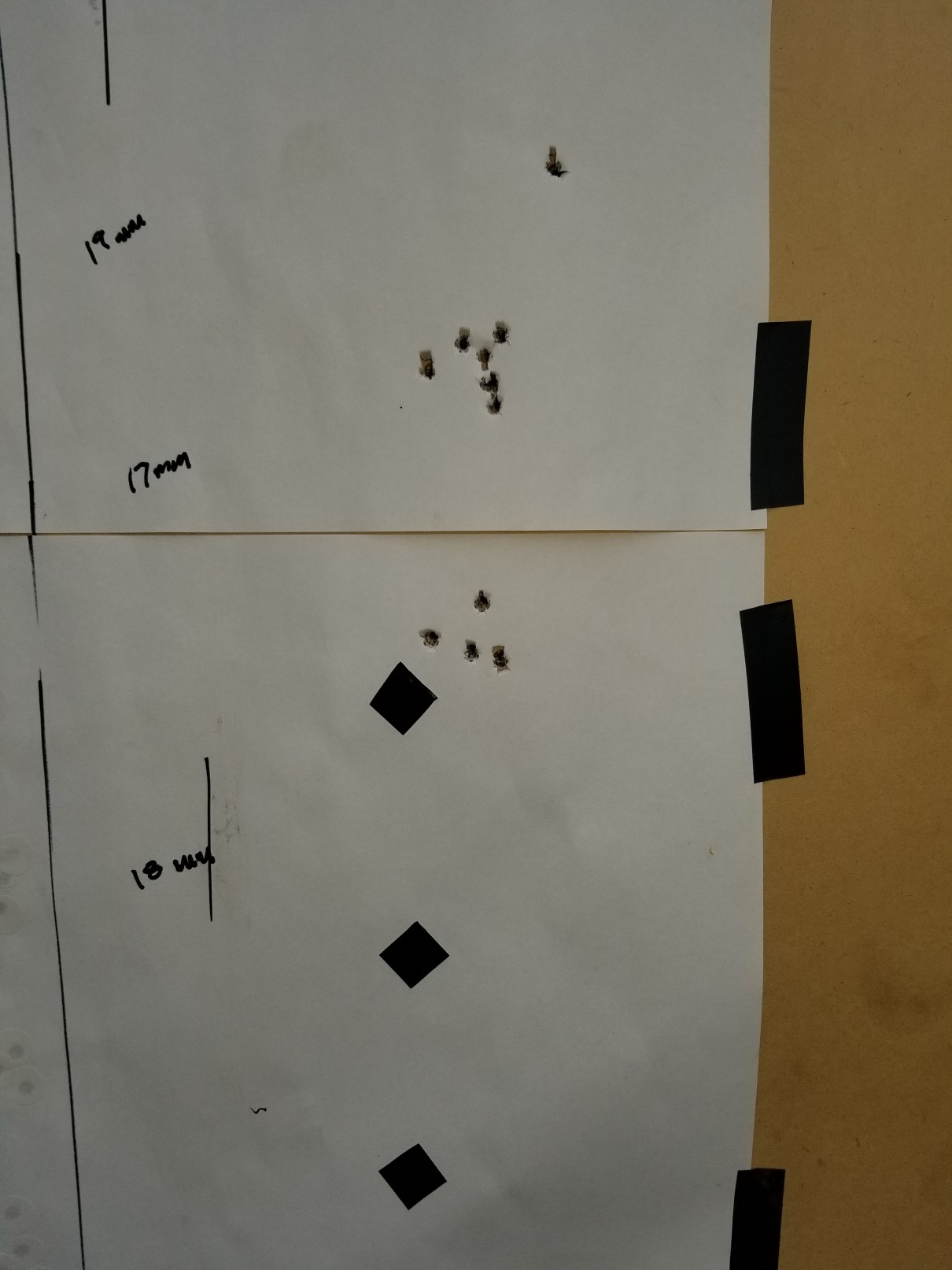

Hot and very humid this today, but no wind for a while.
I managed to get this test done just before the wind started coming in hard and even blew the target over just after the final group. I had to put it up again to shoot the final groups after bring it back down to ensure return to zero. Now it's very windy and raining :-)
I found a place under the oak trees out of the sun, and behind the sheds to minimise any wind (any light breeze could only effect the final 19m of bullet flight). Because I'm shooting so high I set up the target in front of a big dead tree. I drew a plumb line up the board to try to minimise cant, but the board kept moving slightly with the breeze and I had to adjust it several times.
All shots were aimed at the top point of the diamond at the bottom of the target board. Ignore the two groups immediately above it, I was trying to decide if I could get a bit more elevation out of the mount by adjusting the scope. The group aimed at the top left corner of the tape on the right side of the page was my final confirmed zero, about 7mm high and 4mm right at 50m. Overall, I'm very impressed with this $195 mount. I zeroed it 45-minutes up from the bottom of adjustment, and it gave me another 102-minutes of elevation for this test. With an adjustable rail to allow zeroing the mount at the bottom, there's almost 150-minutes of adjustment in the mount alone, plus 100+ in the scope. From a 50m zero that should be good to around 900m even with subsonic ammo.
I dialed in 5-minutes and started shooting 5rd groups, trying to keep the reticle aligned with the plumb line - a mistake. The target board was leaning back against the tree, and was not quite perpendicular to my shooting, so the plumb line was actually leaning toward the left slightly, forcing me to twist the rifle uncomfortably to keep the reticle aligned. I should have mounted a bubble on the scope and just shot the groups - oh well. If I can get another still day I can shoot a 50m zero group, then a 100MoA group and use a plumb line to see if there is any actual drift - I don't believe there is. After the fourth group I could no longer see the bullets hitting within the 40-power scope's field-of-view. The 11-Minutes-per-revolution was bloody annoying - 5, 10, 11+4, 11+9, 22+3, 22+8, 33+2, 33+7, 44+1, 44+6, 55 (yay!), 55+5, 55+10, 66+4, 66+9, 77+3, 77+8, 88+2, 88+7, 99+1.
But my groups steadily climbed up the board, veering very slightly left, by about 35mm at 100-minutes, due certainly cant added by myself.
The increasing cant also made the groups open up toward the end of the test but some were still pretty decent. At 30-minutes a 14mm group, 65-minutes was 17mm, and at 100-minutes it was still a 24mm group.
My estimates of group centres gave me steps of between 54mm and 74mm, with an average step of 69mm over the 20 groups. The tightest step by far was the last at 54mm (close to the end of travel), so I discounted that one as an anomaly. Five-minutes is 73mm at 50m, so the graduations are under-size, about 95% of a minute. 27.6mm at 100m instead of 29.07mm - so it's been graduated at the 1"-at-100yd that is so commonly used (a minute is actually 1.047" or 26.6mm at 100yd, or 105% of an inch). So dialing up 10-minutes on the mount actually only raises it 9.5-minutes, dialing 25-minutes raises it 23.75-minutes, dialing 100-minutes raises it 95-minutes. This is a test that everybody has to do with their scope as well, to determine exactly what it's adjustments are.
So, very impressed with this gadget :-)

I forgot, the last target is the three groups I shot to confirm it returned to zero from the 100-minutes.

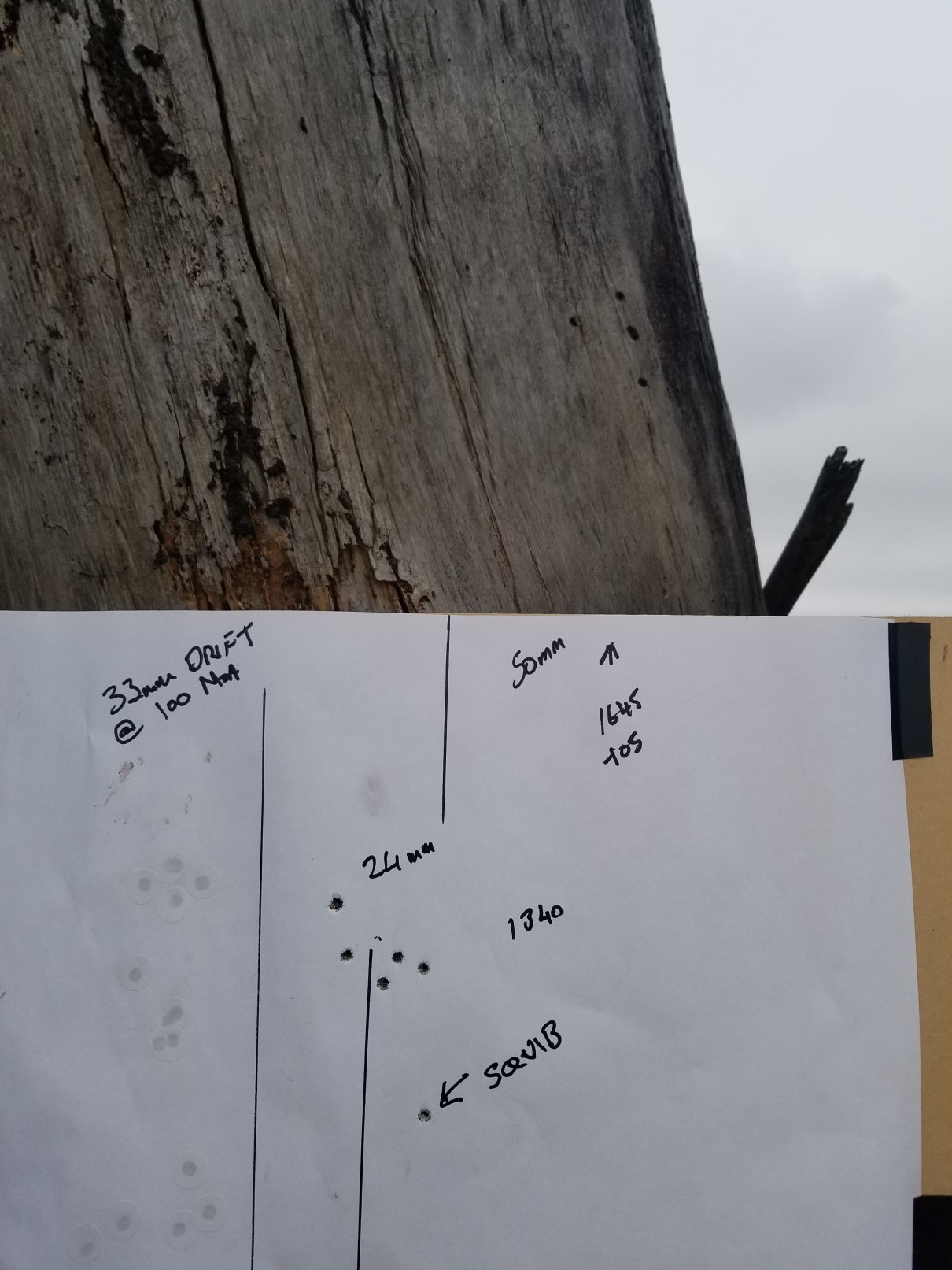

Pretty damp today, but no wind.

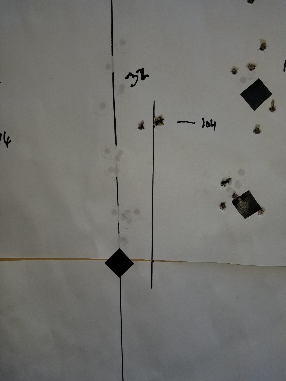

I didn't bother mounting bubbles, I shot a group at 50m, wound up the mount 100-"inches-per-100yds" and fired another group. Shot number two was a squib that dropped a few inches low so I fired a sixth.
Today I used Eley Standard just because I have a lot more of it than Edge, and I had three audibly weak loads out of forty rounds fired today.
The group couldn't be much more plumb above the first group, it's maybe 5mm to the right. Height was 1340mm above group one, so 24mm lower than the Eley Edge yesterday.
Bottom group is my before group, top group is after going up and coming down 100-minutes. Not a great group, but it's in the right ballpark :-)
Then I swapped to the Ruger American Target which is set up with an adjustable rail and zeroed at 100m (with CCI Standard Velocity) at the bottom of the scope's turret. This gives the full seven revolutions of elevation - 105-minutes. It actually has 106-minutes but is zeroed one click up from the bottom, with three clicks left at the top above 105-minutes. I didn't bother altering the zero and just shot some groups - the 18-power scope is pathetic after looking through the 40-power :-) My before group was 104mm high and 32mm to right of aim.
Then I came up seven turns, 105-minutes and fired a group. These went over the top of the target board into the tree. Height was _about_ 1645mm above aim, less the 104mm of zero offset, about 1541mm of height. Drift to the right was about 50mm, less the 32mm zero offset, about 18mm. But the group wasn't great, and hard to measure as it's in the curve of the side of the tree and more than two-meters above ground. I'll have to raise the target board about 600mm so I can see above the grass to aim right at the foot of the board, perhaps tomorrow.
To be 104mm high at 50m this Eley Standard will be zeroed around 95m. 105-minutes of adjustment reaches out to 507m from this zero. 105-minutes at 50m is 1526mm high (my group was at 1541mm high), so we can see that the AR Optics 4.5-18x40 scope is graduated to actual minutes.
Then I came back down from 105-minutes and fired some groups.
These were 30mm to right and 99mm and 101mm above aim, so a perfect return to zero.

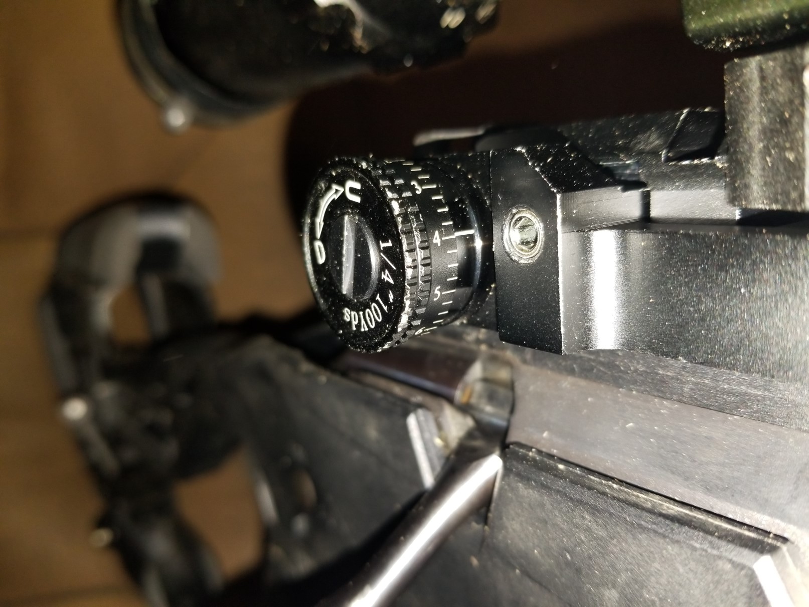

Oh, I totally forgot as it really isn't an issue, but the elevation dial is numbered "backwards", and the index mark is at the front of the turret, not the rear.
As you can see, turning it in the direct of "UP", or clockwise, the numbers go down, not up. This hasn't mattered at all to me so far, but could potentially be an issue for somebody else. I can't really see the numbers clearly enough to read them anyway without glasses. It's zeroed at the number "4" as I haven't reset the turrets. So I just give it a full turn until "4" again, being 11-inches, then count by elevens, then go past by however many more inches I need by simply counting how many numbers pass the index mark, I don't need to read the actual numbers. If you did find it an issue I'm sure you could very easily print an adhesive label and wrap it around it.
If you want to be able to see the index mark from a shooting position behind the scope you will have to scribe one yourself, not at all difficult.

I suspect the reversed elevation scale is a QC issue. It appears that the two turrets have been printed with their scales, but then the windage turret has been tagged "UP - Down" and the elevation turret has been tagged "L-R". I tried to confirm this by removing the turrets to swap them over, but whoever did up the screws is far stronger than I am. The instructions say they're easily removed to re-zero the turrets. If I can swap them over, then some simple stickers on the face of them to indicate direction would fix it. Not being able to remove them though means having to print scales to wrap around the turrets, more difficult but not insurmountable, and black text on a white background would also make them easier to read.
The turrets have a diameter of .864", so a circumference of 2.714". Just a matter of printing a strip with a scale marked with 43 lines (44 segments), with a number every fourth line, cut it out, wrap it around the turret, and adjust the printer scaling until it fits perfectly. The strip is .160" in width. Although it would be a lot easier to do if you could remove the cap :-)

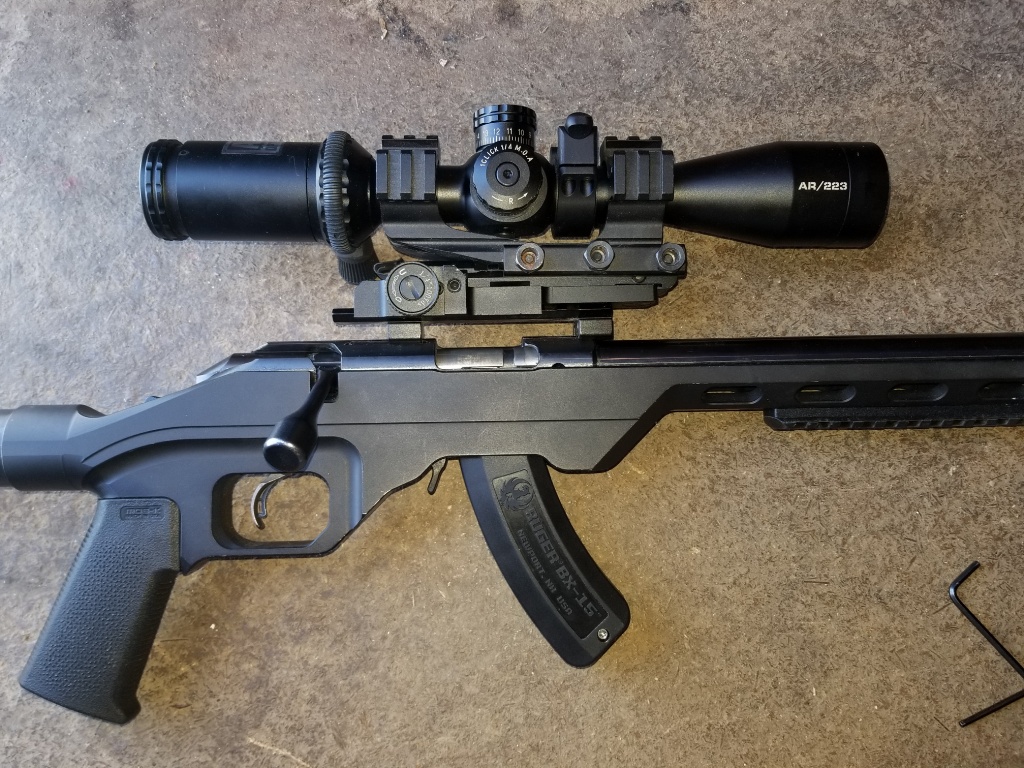

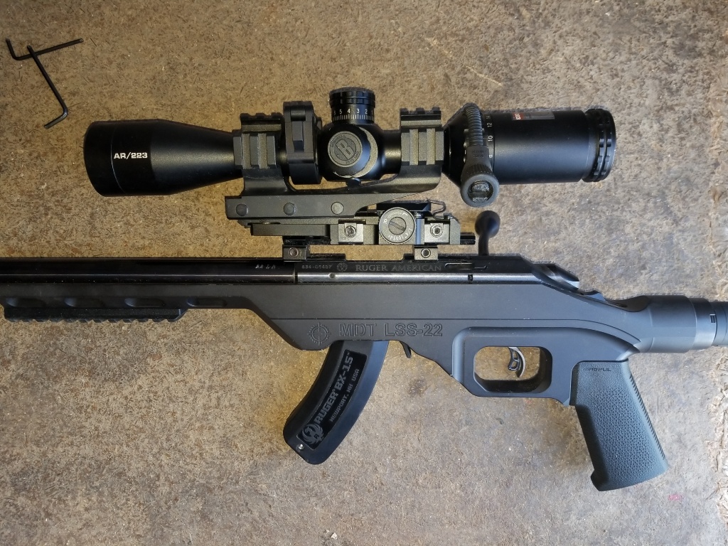

I mounted this rail on the Ruger American Target as it's my preferred long-distance .22LR. Ruger mills the dovetail into the sides of the receiver, not along its length, so you can't slide mounts on from the back, you have to use two-piece mounts with separate clamps. I was a bit restricted but it worked out okay.
I used a dovetail to pic rail adaptor which gave me a bit more length to the rear, then mounted the adjustable rail on that. With its very short rail so far forward I used a one-piece pistol mount backwards to get the scope further rearward. Not too bad.
Then I centred the scope windage, wound the elevation turret to the bottom, and boresighted at 50m using the rail only. My boresight was 200m left and 140mm low, boresighting well to the left seems to have become my default recently.
Had an eye test last week and the first indications of a cataract in my right eye are apparent, but nothing to worry about just yet hopefully. But having done a lot with the 40-power scope recently, it takes some getting used to 18-power :-)
