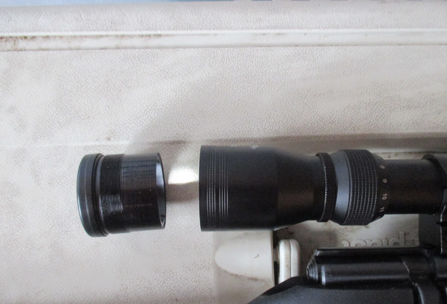

I obviously unscrewed the incorrect union , Manual said unscrew eyepiece which is what I did . Will screw back up tight and loosen lock ring .

Looks like its probably been "de-gassed" now. Might have some interesting fogging problems when you have a sudden change in temperature.

The lock ring you should have loosened is the thin knurled ring behind the power ring. Once loosened you could have easily turned the entire eyepiece until focus is achieved, then retighten the lock ring.
As said you have now purged the nitrogen gas from your scope. Did you not read the instruction manual? Google is your friend if you dont have one.
