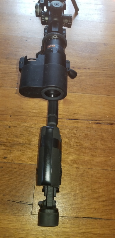

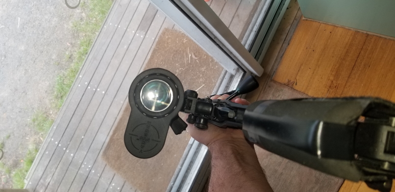

I _finally_ received my Tactacam FTS yesterday. It's actually two parts, a bullet-style camera, and a periscopic housing that mounts on the scope allowing a normal view through the scope while mirrors allow the camera to view through it as well. You can use the rifle without interference from the camera, but press a button to record when you want to.

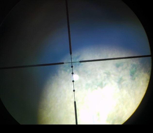

There is no way to view anything from the camera without connecting it to a computer, and downloading the videos to watch them. Except it's supposed to Bluetooth connect to a phone or computer so you can view it, which I and a mate can't get to work so far :-) This matters as not being able to view it means you can't set the reticle to be vertical or ensure the camera is properly centred in the scope.
Screenshot 2023-02-08 040013.jpg (34.08 KiB) Viewed 1256 times
https://www.youtube.com/watch?v=3ljTtzSrPBY
The actual video quality is not too bad I think, though the audio is difficult. It barely pics up our voices but cycling the bolt is extremely loud - this might be related to shooting off the back of the ute so I'll try prone next time.

First, the mount comes with seven collets to fit over different size objective housings. #7 fits over the scope but when I put the FTS on, it was actually mounted on the diopter ring, not the objective housing, so it rotated freely. I slid the #6 collet over past the diopter ring, then mounted the FTS to that to get a secure grip.
The camera sits very close along the side of the objective housing for compactness, meaning I had to remove the throw-down lever, though I can still use the zoom ring without too much trouble.
The FTS mounts to the scope with two socket-head screws, and the camera mounts to it with another socket-head screw, so you need to have an allen key with you if you want to be able to adjust or remove it. Otherwise you have to have the rifle beside you while you connect to the computer to download the video and recharge the battery. I've found Bluetooth very slow for transferring 128Gb of data but that might be an option if I can get it to work.
The Ruger Precision Rimfire only fits in one rifle case I have, but with the FTS mounted it no longer fits in that one either.
And perhaps the most important, it does sit back behind the scope a little way so it's definitely possible on something that recoils that it could smack you in the face. Hopefully I keep that in mind when I try it on some centrefires.
