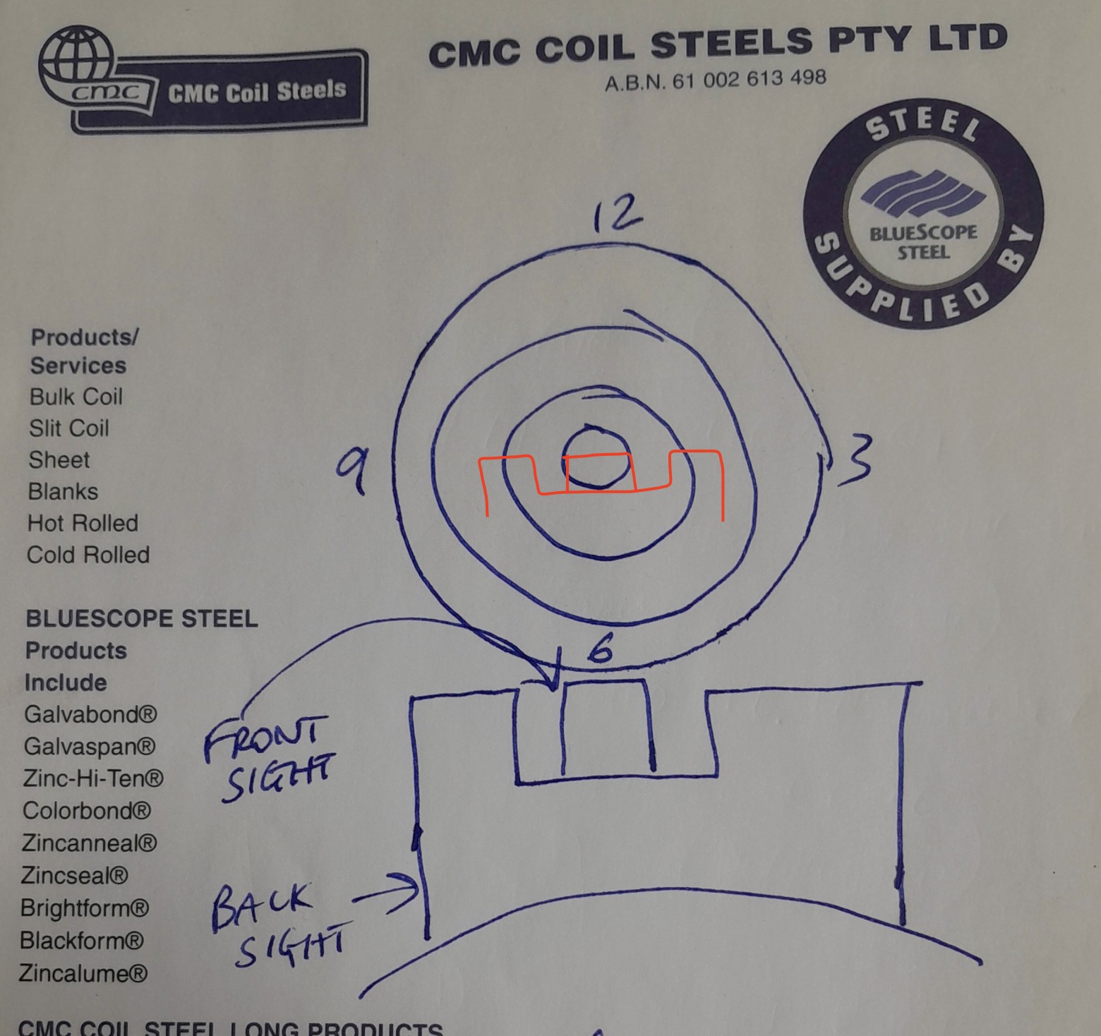

Post by Wapiti » 19 May 2026, 5:44 pm
My tip, using any open sights, is to NOT use a strict 6'oclock hold as taught in pistol shooting (which I've never done anyway), but instead, "modify" it a little and have the point you want to hit cut in half by the tip of the front sight.
Many range shooters will poo poo this, but when wanting as precise a hit as possible on animals, especially with all different critters having completely different vital-zone sizes, this works perfectly for me.
To me, target shooting is not game shooting.
A modification to this I've tried, is having the tip of the front sight at the 1/3rd up from the 6'oclock bottom of the complete diameter of the chest vital zone.
Unless it's rabbits in the farmhouse yard, forget headshots.
Anyway, that's what I do with both normal open sights and peep sights, which if it's at all possible, I ditch the primitive standard sights for peeps. Ghost rings actually.
I believe a No.4 has peeps?
How much of a step up was this idea? Heaps.

Post by Wapiti » 19 May 2026, 6:18 pm
It's where the top of the front sight is sat at 6 o'clock of, say, the circle of a target down at the range.
This is so that you can see the whole target or bullseye.
So, imagine the whole black bull on a paper target is floating above the front sight, with the tip of the front blade at the 6 o'clock position.
The idea is to not to obscure the target, supposedly it's faster.
But in the bush, it's unsuitable.
Can anyone see the problem with this "shooting range" way of shooting in the bush?
At the gun club, all the targets are at known ranges, all are at known diameters, so you know where to aim or hold-off or adjust to hit your X or 10.
In the bush, the vital zone of the animal varies wildly, the animal and it's size vary wildly, and the ranges vary wildly.
Not trying to be a smartarse, but in the bush the 6'oclock hold everyone teaches nowadays at clubs is to me, the recipe of making animals suffer unnecessarily.
So the strike point of my projectile is at the very tip of my front sight, and usually, because iron sights are so close to the bore centreline (unlike the massive scopes everyone needs nowadays), the effective range you can shoot in the bush is all the same POI with open sights.
Because hopefully, nobody shoots at an unknown size pig or a deer at 250m with open sights. Again, just my opinion.
Posts: 2355

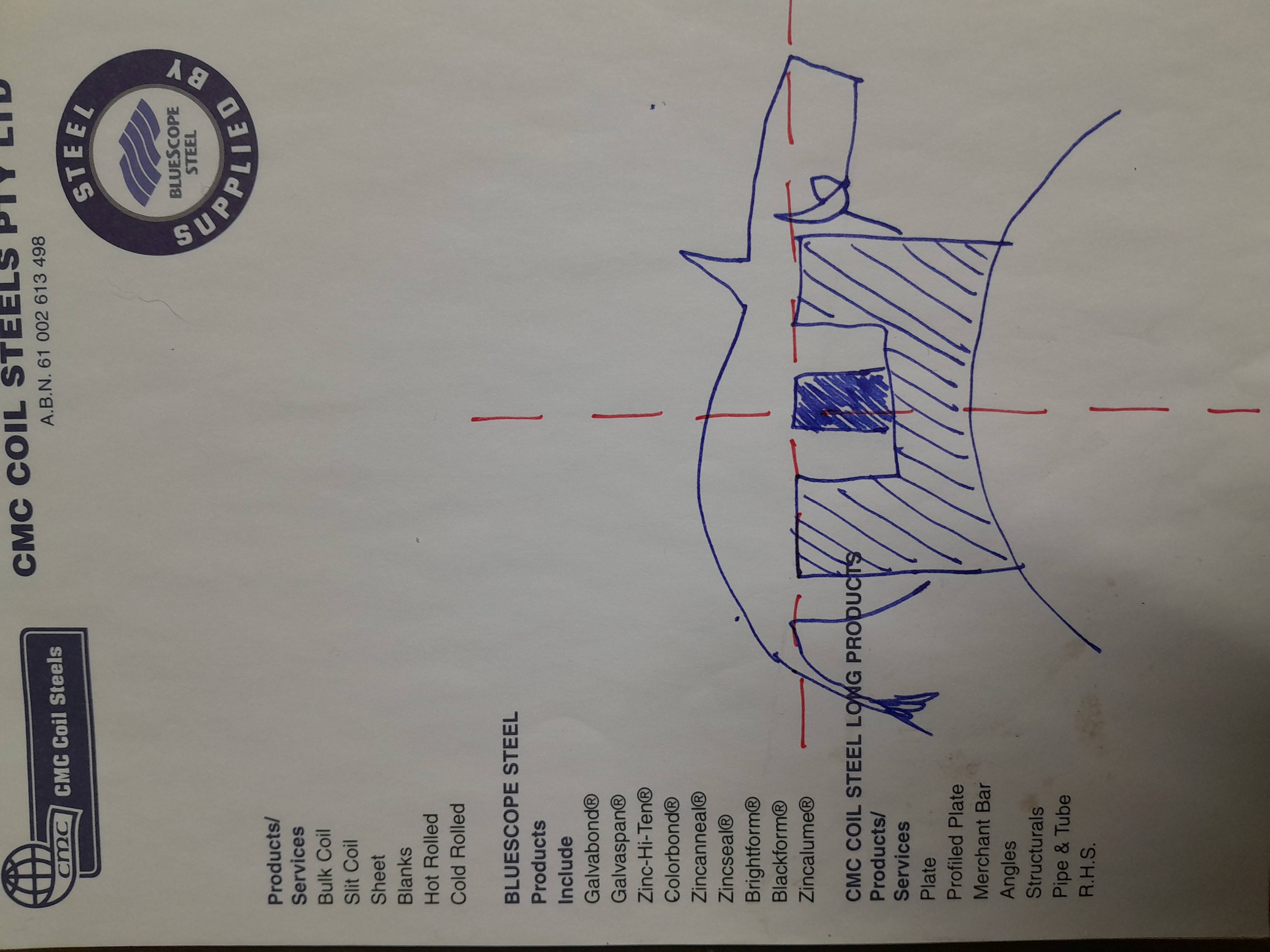

Post by Wapiti » 19 May 2026, 6:26 pm

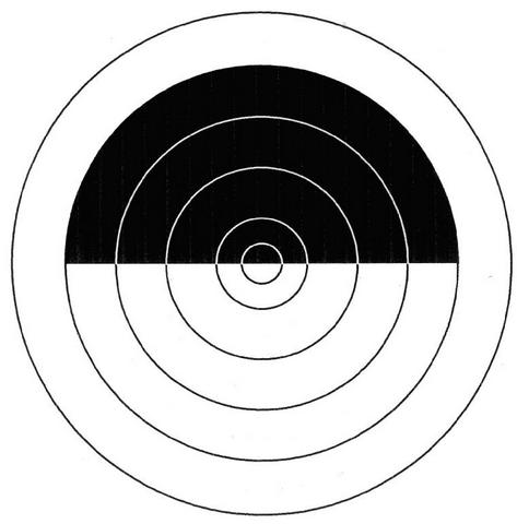

Post by Tinker » 19 May 2026, 10:27 pm
The idea of a 6 oclock hold is it's more consistent. It's much easier to sit the round black target just on top of the black foresight, rather than try to judge when it's in the middle of a black target. It's not "gay", it's just only useful for target shooting.
Which is why the military use "tin hat" targets, which are a horizontal half-moon. You're then aiming at the centre of the circular target, with the half-moon just sitting on top of your foresight.
standard tin hat.jpg (22.06 KiB) Viewed 209 times

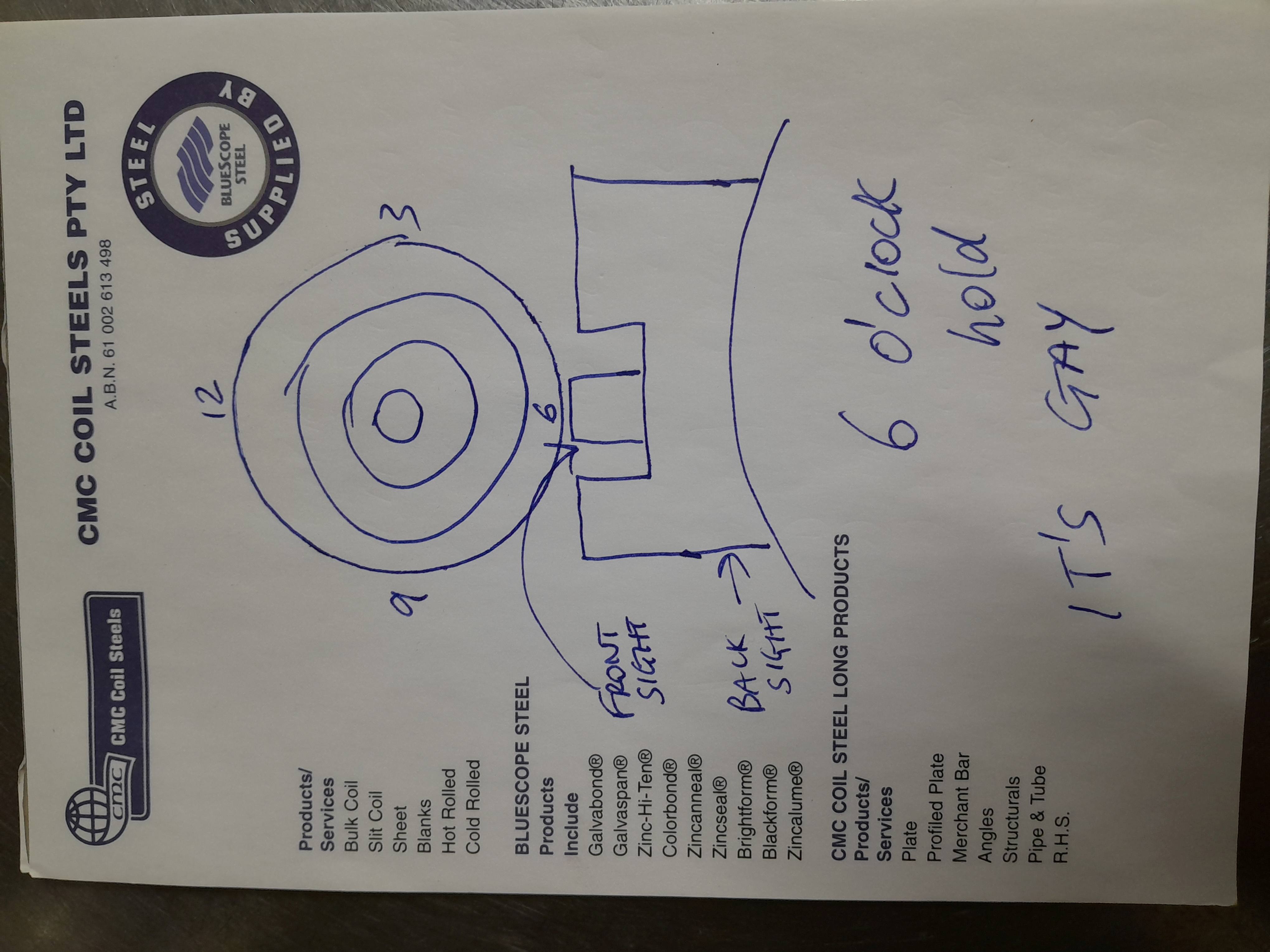

Post by No1_49er » 20 May 2026, 5:50 am
MG5150 wrote:G'day All
I recently acquired a Lee Enfield .303.
It's got open sights and the dealer told me it was zeroed for 400m, which is the closest distance, and to aim low if it's anything shorter than that.
Just checking if this is correct?
I used a ballistics calculator with the ammo details (174g FMJ by PPU) and it said 11.45 inches high at 100m so I guess to aim about 30cm low.
I'll knock up a big 1mx1m target next time I'm at the farm and do some proper testing but would love a steer in the right direction.
Also, any tips for shooting open sights?
Cheers.
After looking at the several answers that have been offered, not one of the respondents enquired about what type of shooting you intend engaging in.
Service Rifle Target, or field??
Dependant on your intention will have a huge bearing on what the correct "answer" should be.
Apparently, a 6 o/c hold is "gay". How so, when a "top-hat" or even an ISSF target is presented. In those cases, a 6 o/c aim is definitely preferred.
Field shooting is a different thing, altogether.
For further discussion, it would be preferable if you indicated what specific type of shooting you want to participate in.

Post by Wapiti » 20 May 2026, 7:26 am
Like this mate.
Probably could've drawn it to be more forward in the centre of the heart-lung zone, but you get the idea.
Using a 6 o'clock hold on a living creature, of an unknown exact kill zone size at every-shot different ranges is unacceptable and is not acceptable for bush shooting, unless you consider shot placement something that you can get a few shots at to get right, something only a paper target at a range that just sits there allows.
To me, there is no argument and is unacceptable on a living creature, unless of course you'd find wounding acceptable. Which I'm sure a mature, mentally stable person does not.

Post by No1_49er » 20 May 2026, 1:36 pm
Why is there an assumption that the OP intends shooting game?
If his smellie is for target shooting, perhaps a discussion about 6 o/c hold might be appropriate.
Sometimes, shooting is about putting holes in paper; indeed, some people never shoot for meat.
