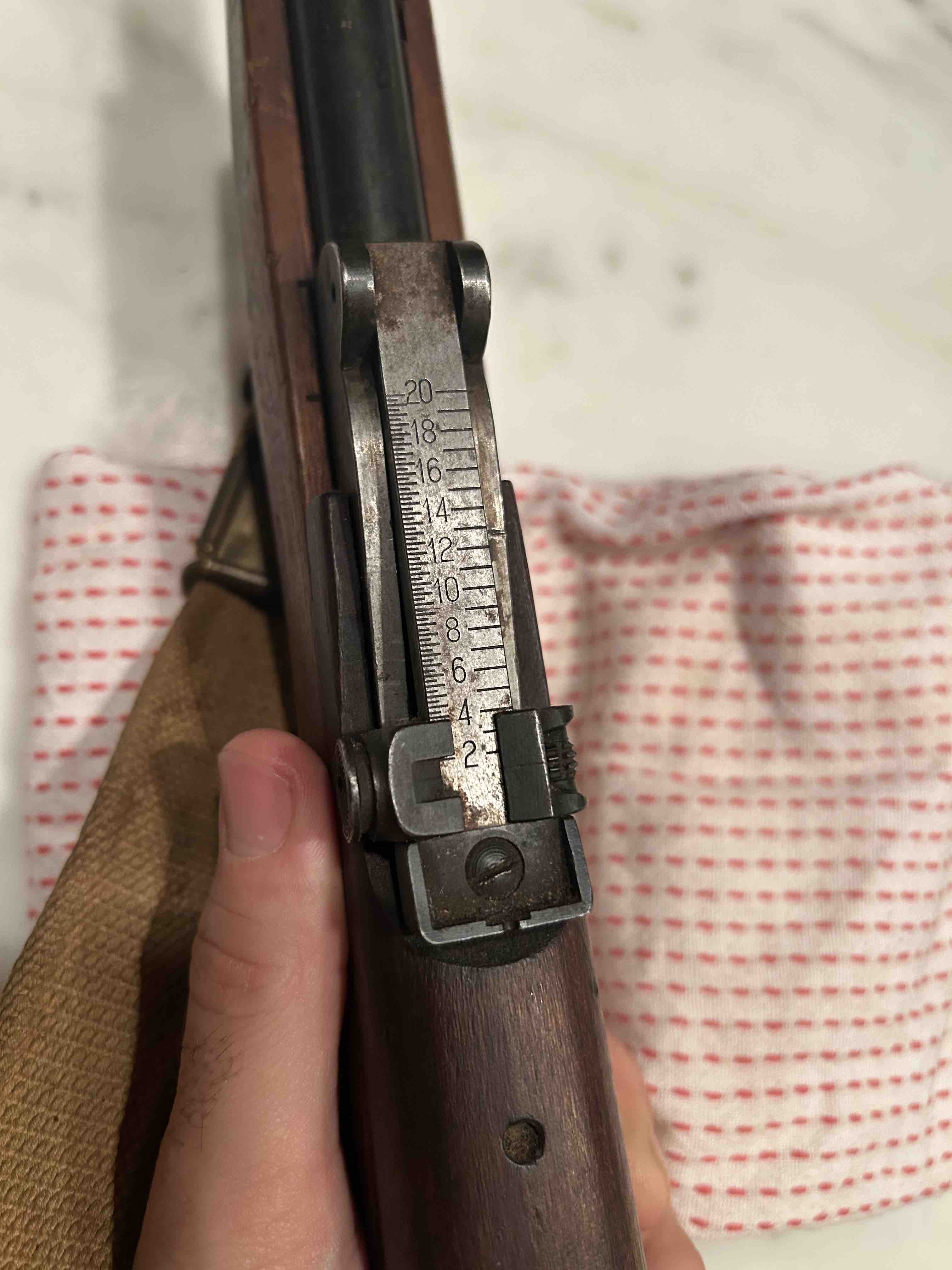

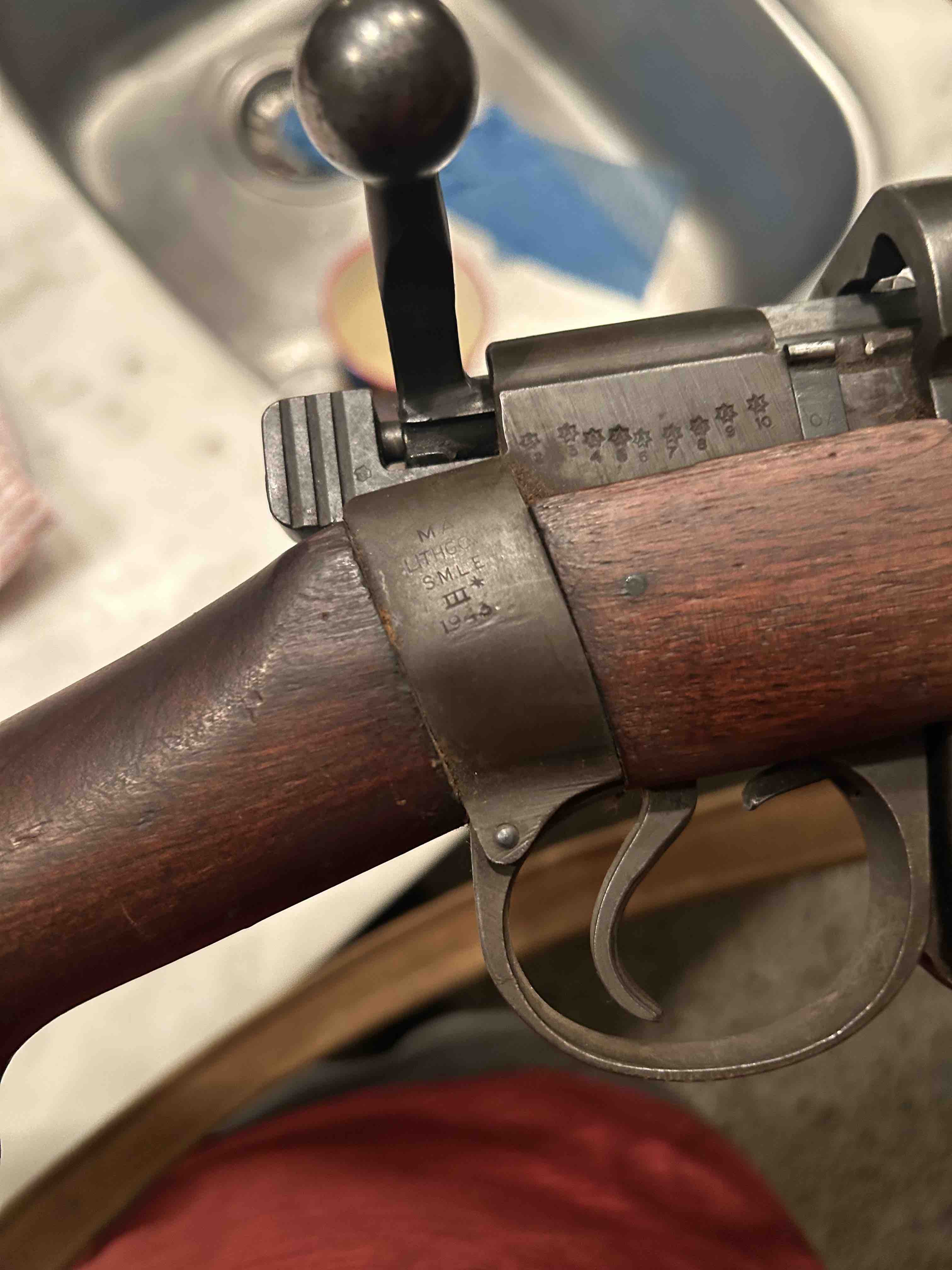

Hey guys, here are a few photos.
IMG_8120 2.jpg (314.5 KiB) Viewed 34 times
Here are the site adjustments - the top line appears to be on the 4 (400m?) mark and won't go lower? She said it was set up for 400m and can't be set lower, although I can see the number 2

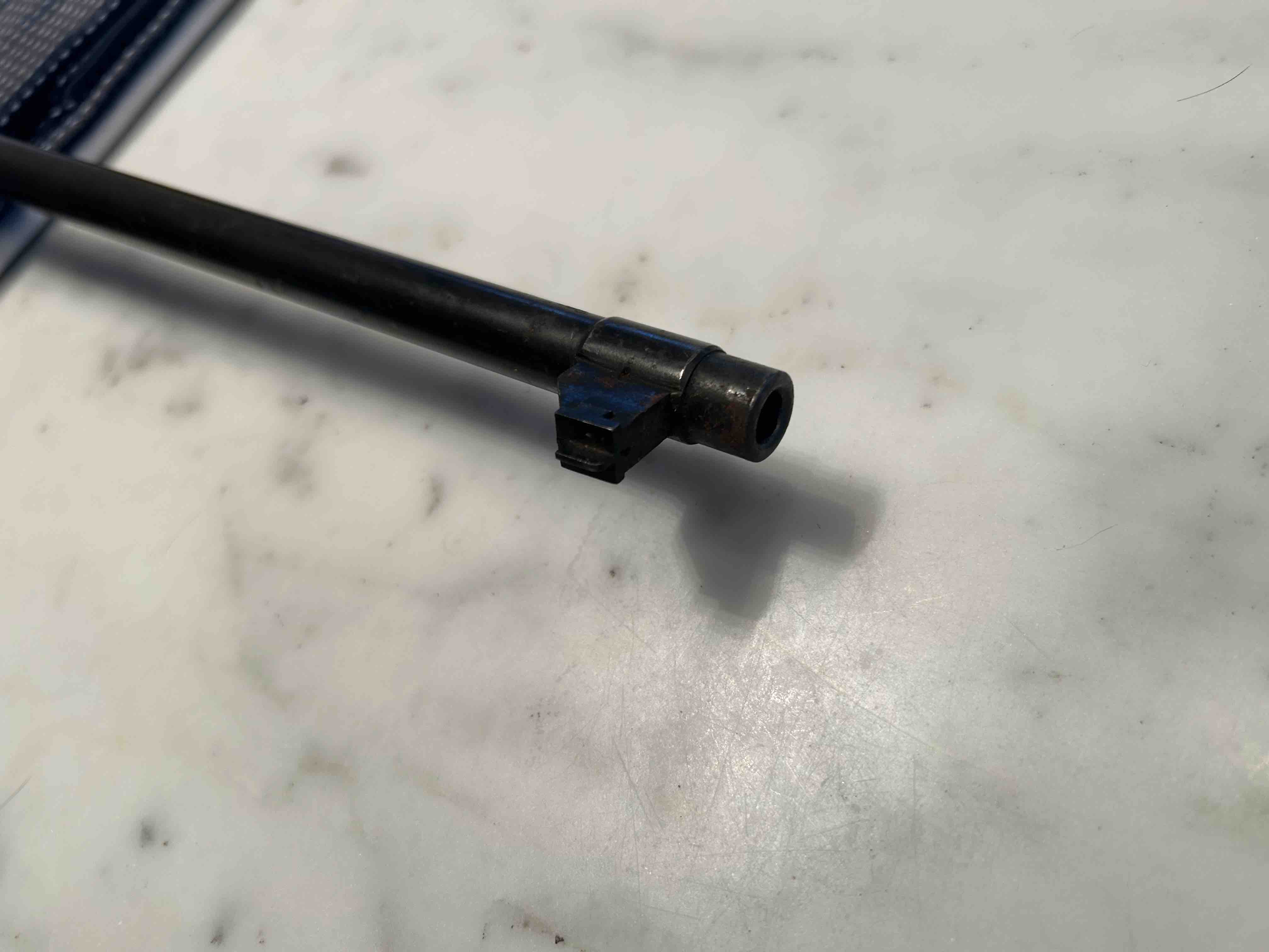

here is the sight
