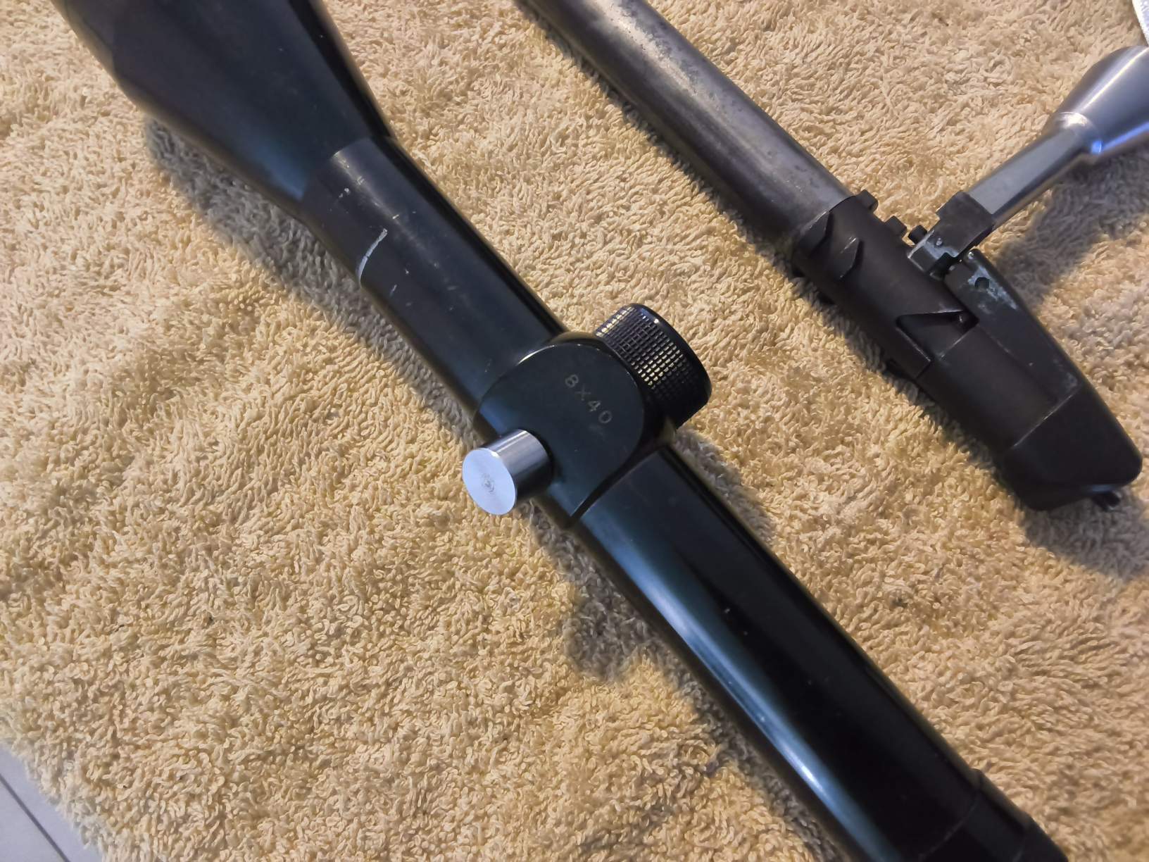

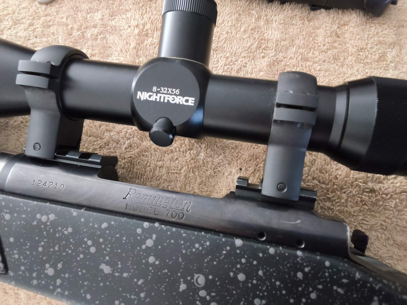

Found the old Tasco 8x40 with what is known as a Siebert conversion i did 30+ years ago as a suck it and see. Bigger cap than what is commercially out there now as I used a spring i had rather than wanted. More importantly it took a scope that had shifting zero and made it reliable. So essentially the leaf spring is removed and coil spring and plunger set at 270 degrees. Burris went one step further and placed a screw in the cap so that once you had the scope zeroed the set screw locked the erector cell hard up against the elevation and windage turrets for maximum reliability. These days the cap and spring are very discreet and most people don't notice them. The early days yes they were rather agricultural but there are thousands of conversions out there that Siebert did in the US and here mainly on Leupold target scopes for benchrest and metal silhouette.
