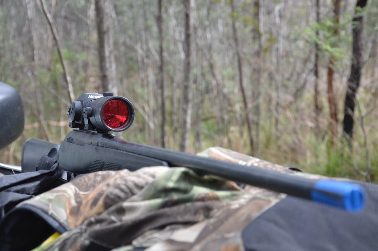

A red dot is only as accurate as you make it through sighting it in. I use a 2MOA dot. The big advantage of them it the lack a parralax error enabling quick accurate shots at short range. A prefer a 2MOA for less coverage of the target.
The is an Aimpoint H34S Hunter on a .30-06.

That's a 1X scope.

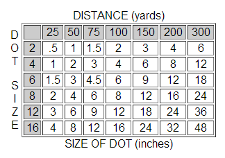

Copy / pasted from pracshooters link above :)
The diode modules are available in six different sizes; 2, 4, 6, 8, 12, and 16 moa. The size of the dot is measured in minutes of angle (moa), with 1 minute of angle being equal to 1 inch @ 100 yards (approx.). Example; a 2 moa module will produce a dot that will cover 2 inches of your target @ 100 yards, a 6 moa module will cover 6 inches, and so on. When you reduce the target distance by half, you also reduce the minute of angle by half. Example; the 2 moa module will cover 1 inch @ 50 yards, the 6 moa module will cover 3 inches @ 50 yards, and so on.
See the chart below to determine the size of each module at different distances.

16 MOA dot @ 300y :lol:
Good for hunting barn doors.
