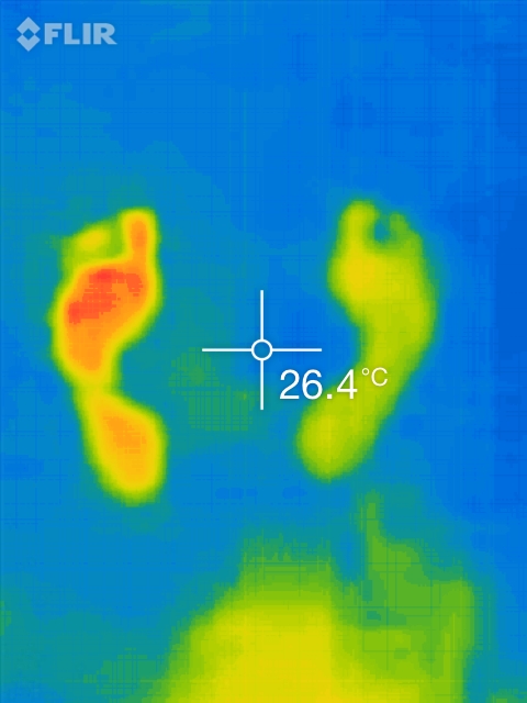

@ Title_II Good info, much appreciated :D
Here's a pic of my footprints 30 seconds after stepping back...It's surprising how much residual heat tiles trap just by walking on them. Thermal is awesome in pitch black, I can hunt the sons cat just by following her footprints even in the darkest room. This pic is from a FLIR One attached to my iPhone, the thermal Weapon sight I have is B&W and can pick up the Roo's way out past 750m without too much trouble. Cost is currently the biggest drawback with this technology though now that the sensors are being produced in Belarus I expect the prices to fall in coming years where this technology should be affordable for the average hunter.
FLIR One - Different colors show that my left foot as on the tile longer then the right...Pic taken in pitch black room with no outside light.

Post by Title_II » 09 Dec 2015, 2:28 am
Yeah, I do the same thing with my thermal. I can also see inside my exterior walls when it is cold or hot outside. Anything in my walls either speeds or slows the rate at which heat either comes into my house or leaves my house, resulting in a localized temperature difference on the surface of my interior drywall. I can see the studs, all kinds of stuff. There is actually something in my ceiling that looks like somebody hid a box there. There is no reason for it, it is in nearly the far corner of my crawl attic, under the insulation. I tried to get to it one day but it is so tight to get to I was afraid and need friends here to help me get it, and in case there is a problem.
The FLIR One is cool but it is a toy compared to your weapon sight. That thing is awesome.

Post by Rocker » 15 Dec 2015, 8:25 am
Expensive way to take photos of your feet Brett :lol:

Post by Title_II » 15 Dec 2015, 8:34 am
Rocker wrote:Expensive way to take photos of your feet Brett :lol:
Those aren't his feet. They are his footprints :)

Post by Joom » 15 Dec 2015, 9:42 am
Nah Brett is a really weird looking guy.
Those actually are his feed :lol:
