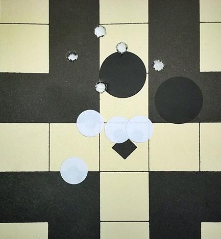

Post by p3seven » 17 Feb 2016, 12:07 pm
50 & 100 m 16_2_16 2.jpg (25.97 KiB) Viewed 4394 times
To hopefully finish the story. After checking everything to do with screws and mounts and rails and actions I went over everything with the torque screwdriver and equaled everything out so to speak. Nothing was really out of spec. Off to the range.
Last Friday the scope was high 3" and right an inch. Yesterday I clicked down 16 and up 4 (1/4 moa per click) then left 8 and right 4. Gave the turrents a tap and started work. 5 shots at target 50 m and I moved up 2 clicks tapped the turrent, following my new adjustment routine. Put the rifle aside for an hour.
Came back and set up a new target 50 m The results are the white patches. Put the black dot on 1.6 inches above the aim point (the black diamond) and moved to 100 m. The results above are the pleasing to me in that anything I aimed at would be dead and according to the ballistics I should be on the black diamond at 200 m. It was too hot in Brisbane to walk out to 200 m and back 4 times yesterday.
I will give everything a rest for a week and test again. Thanks all. I am I hopefully getting closer to being able to shoot and kill my target pests (with repeatibility) anything between 50 and 200 m with no real adjustment to my aim point.
