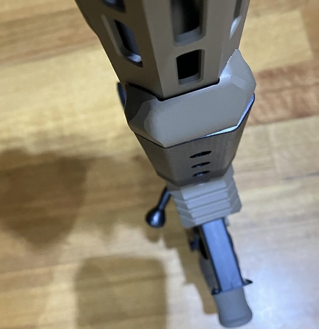

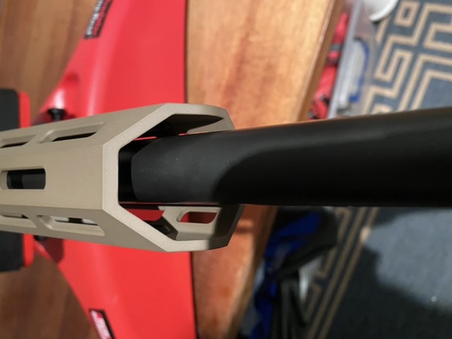

So, the replacement MDT chassis turned up and....it’s better, the barrel alignment is ok but I ended up shimming it to get it perfect. Then there’s the hand grip area that looks like a baby has glued it in off centre...and some general figment is just bad - large gaps one side, snug and tight on other...the photos kinda show it, but if it was a local arrangement - it would go back.
2 pics show barrel alignment before and after shimming.
Unfortunately - This will be my last MDT product, which is a shame as I know others have been very happy with theirs and I like the look / function. But - precision ? Not even close...for the money - there has to be better quality control.

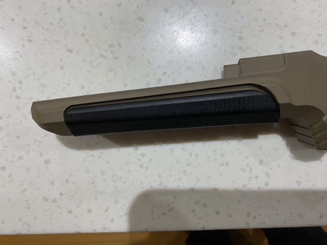

Pic 3 and 4 shows handle on chassis...

Well - another development... Nothing will be getting stopped anywhere, as MDT have now reneged on their sending of entire system stating the issues are “predominantly” cosmetic.
They have apparently identified the hand grip issue - the counter sink on front Mounting hole was not deep enough - so if I would like to pull my rifle down for the 20th time, drill that hole out and put it bsck together, it should fix the hand grip. Then I pointed out the alignment issue with the chassis / fore end was more my concern - they couldn’t answer me as to how that occurred and said we are sending you that part only. But - they have test fitted that interface, so rub marks will be evident...
I give up. I’ll see how it shoots / bed it - if it’s no good, I’ll pack it up and send it back to MDT with a FU note lol. I kept the hogue stock - I’ll bed and stiffen that if need be.
Re: Setting up new scopes level - MDT chassis ISSUE?
Post by marksman » 27 Jun 2020, 11:49 am
the biggest problem l could think of with the other photo you uploaded in a different post Tassie is that the fit would be made better by building up the gap area
to do this you will have to ali weld and will wreck the finish, if it were possible to file the touching side back it would be easier but the barrel still needs to be centered, l would not be drilling anything even though they have told you to
how could this get through there QC :wtf: l wonder where the castings are made :unknown: maybe mexico
this does not make the MDT company look anything more than money grabbing salesmen, premium price but cheapo quality
it shows you cannot believe advertising and a hell of a lot of reviews
now l think l would be looking into Australian consumer law :drinks:
