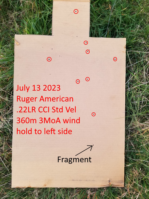

Post by bladeracer » 13 Jul 2023, 7:28 pm
I took two rifles out today and couldn't be bothered trying to pack two tripods and spotting scopes so didn't take the VisionKing. But we got on the Swarovski 80-power as soon as we got out there in good light and Rose _could_ see some of the .22" bullet holes at 360m in the cardboard, I couldn't see any. Even for her eyes it was marginal, if she didn't know there were holes there she probably wouldn't have picked them out. I fired 180rds today and with the scope at 18-power I only saw three splashes of impacts in the mud/dirt at 360m while Rose was seeing most of them with the 80-power. I wouldn't spend thousands on a spotting scope to gain perhaps 100-200m viewing range over a $200 scope, I'd spend it on a remote camera setup.
