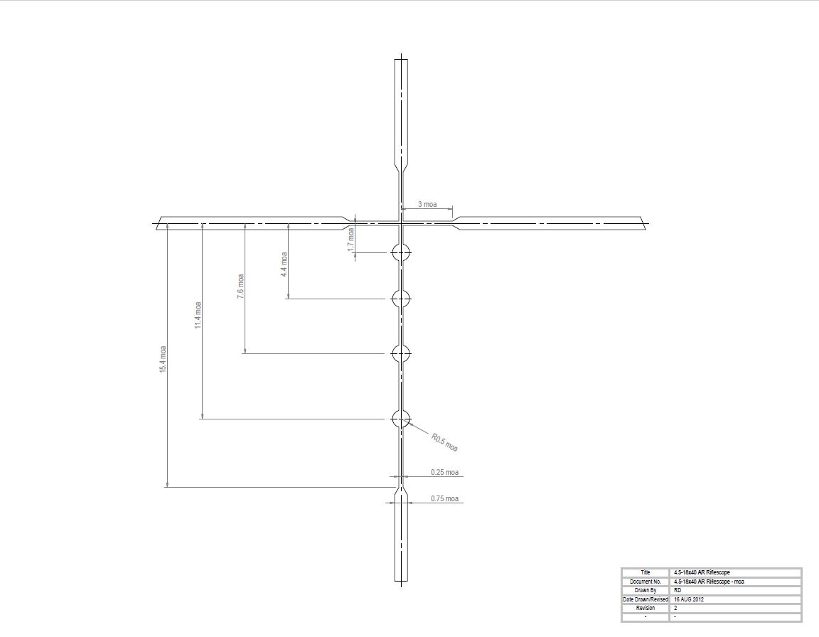

Post by bladeracer » 06 Nov 2018, 10:56 pm
You don't want FFP.
The Bushnell AR Optics 4.5-18x40 I'm using is a fine reticle out to at least 400m on my .22's. The reticle is only 0.25MoA - 7.25mm wide at 100m, 29mm at 400m. It's fine enough that you can put it on the centre of a 400m 50mm target dot and still see the dot in the quadrents. At 100m I aim at a corner of the piece of 19mm insulation tape I use as a target diamond.
Shooting paper, 18-power lets me see bullet holes at about 150m, although I can just make out 5rd groups at 180m. Shooting unpainted steel I can see the bullet splashes to 270m or so.
Having a military-style reticle is very helpful at longer ranges. It allows you to measure the difference in point of aim and point of impact in MoA off the reticle so you can translate it directly to the turrets. You don't need to know the range or guess how many millimeters you are missing by, if your bullets are falling 1.5MoA to the right of your point of aim, just dial in 1.5MoA windage to the left
I have a 10-40 1/8-MoA scope as well, which I'm missing now as I play with long-range .22LR shooting, but my brother has it on his Anschutz currently.
Bushnell AR Optics 4.5-18x40 223BDC reticle.JPG (45.48 KiB) Viewed 5903 times
