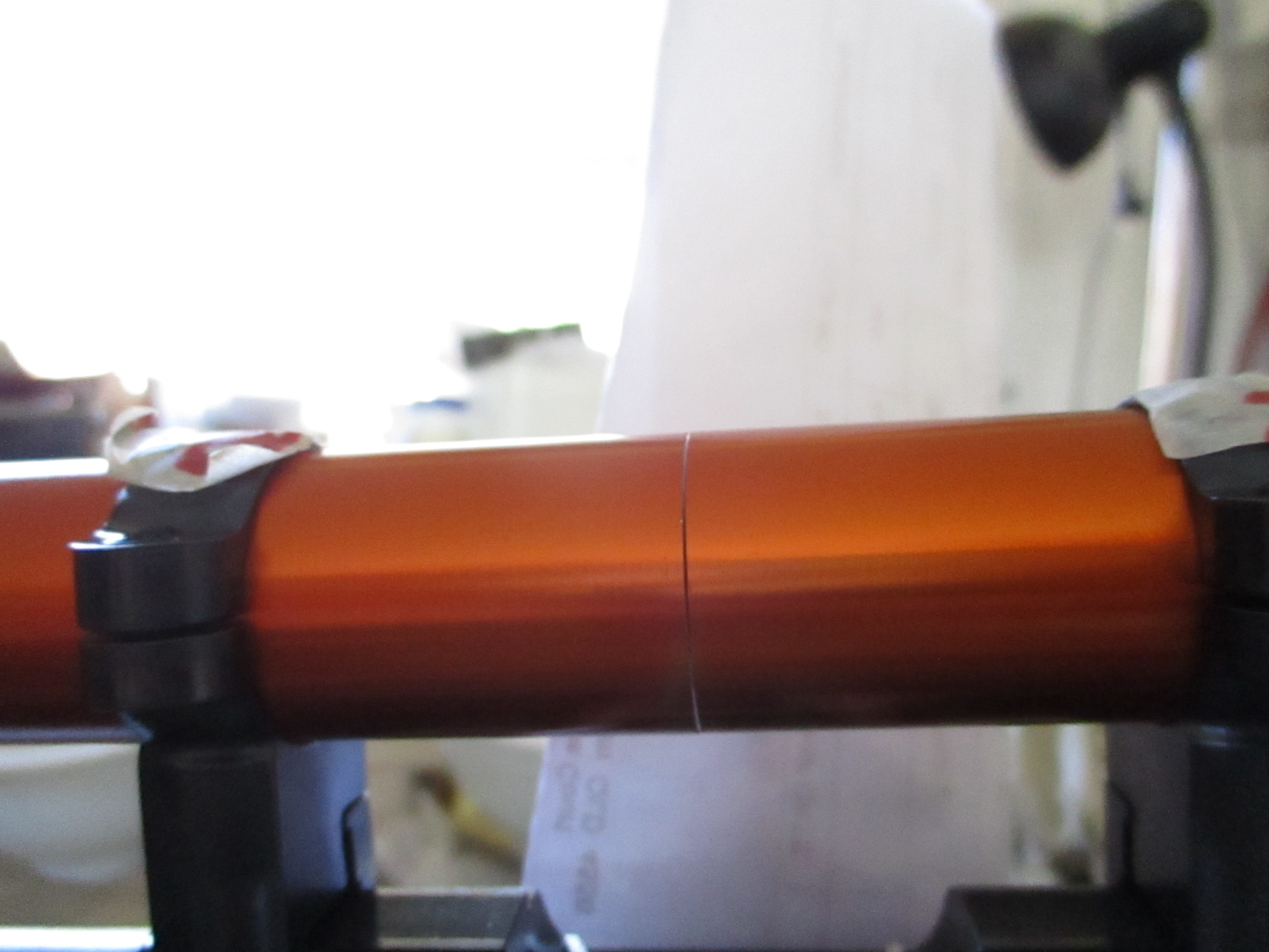

Post by Wm.Traynor » 01 Dec 2018, 5:29 pm
2018-12-01 14.49.18.jpg (1.11 MiB) Viewed 4524 times
Alignment is out and would bend the scope IMO. Don't like it much anyway especially after the previous mounts were so good.

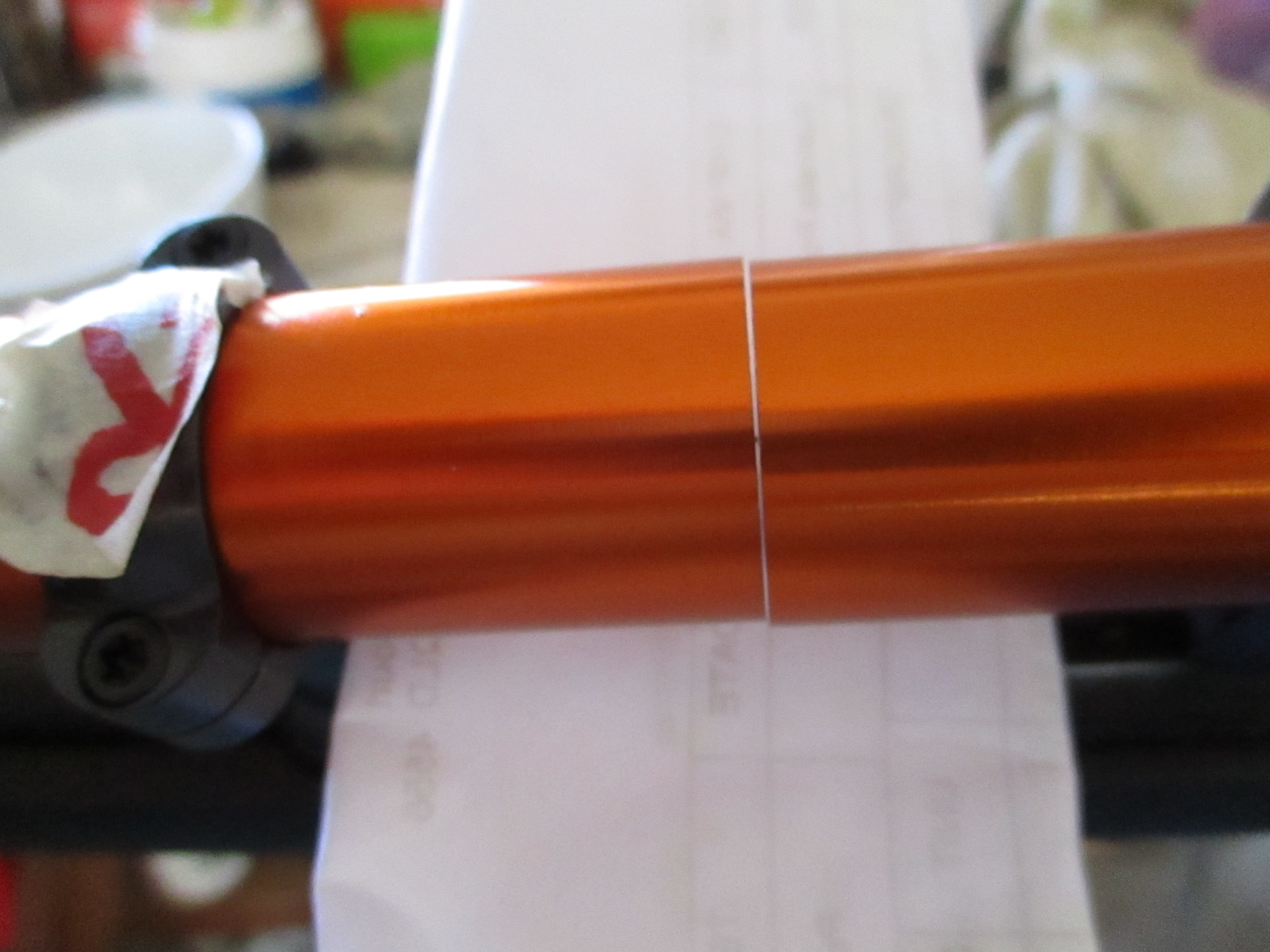

Post by Wm.Traynor » 01 Dec 2018, 7:29 pm
2018-12-01 15.17.22.jpg (1.15 MiB) Viewed 4503 times
You can see 0.010" brass shims under the rear ring-mount . The idea is to lift the rear rod into alignment with the front.

Post by Wm.Traynor » 01 Dec 2018, 7:40 pm
2018-12-01 15.46.15.jpg (1.07 MiB) Viewed 4497 times
With 0.010" shims. Close but Not. Quite :twisted:

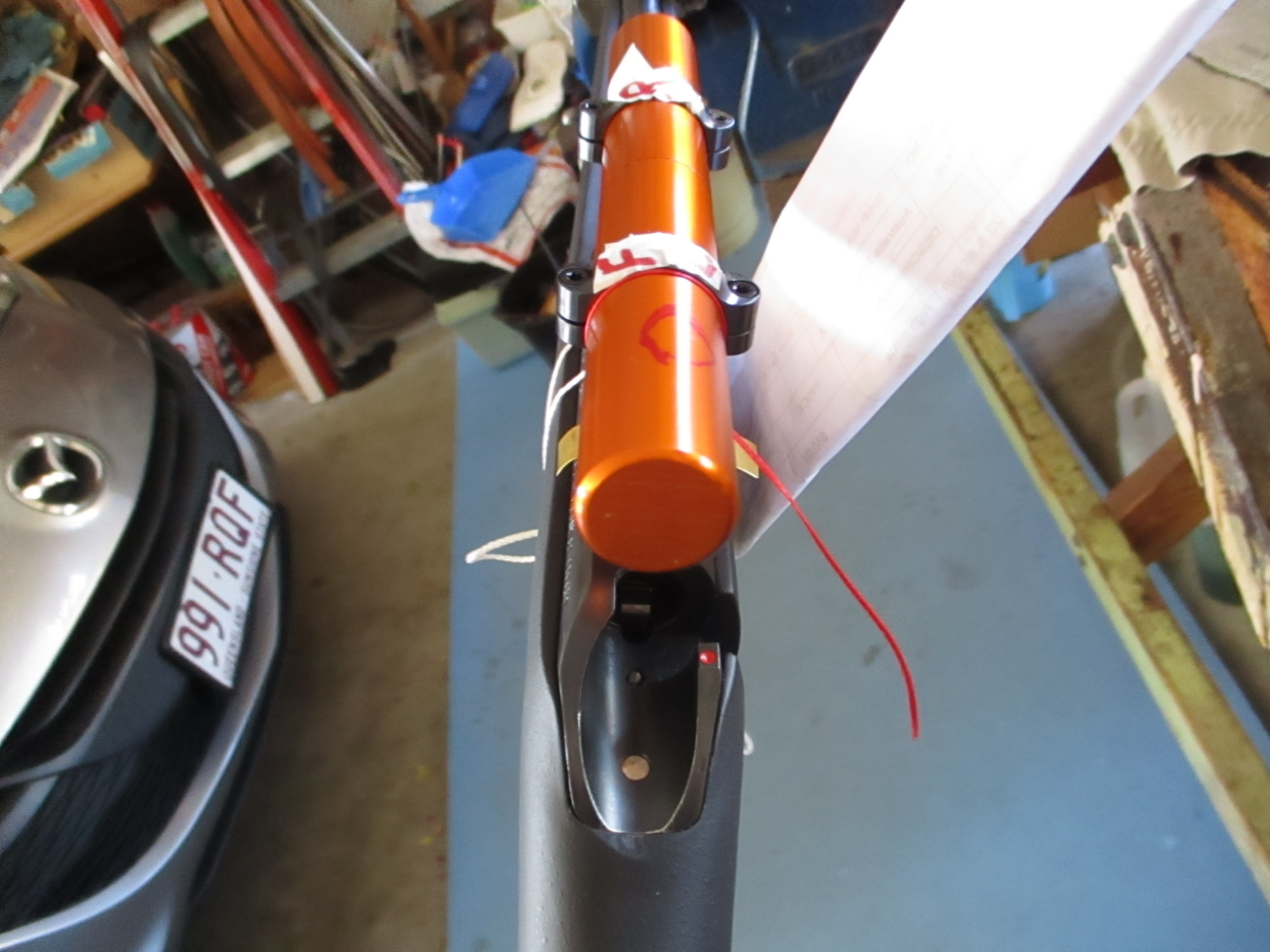

Post by Wm.Traynor » 01 Dec 2018, 8:07 pm
2018-12-01 15.46.28.jpg (936.38 KiB) Viewed 4491 times
With 0.003" shims under each side of the rear ring mount. Just. Right :D :D Who needs a $100 ring lapping kit :wtf:
My hearty thanks to Chronos :clap: :clap: :clap: :drinks: :drinks: :drinks:
