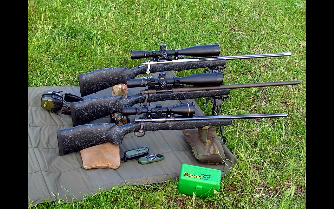

I only use 2 brands (there's one in my avatar) and that is NF NXS and luepold vx3 .
I have a vx3 6.5-20x50 on a 2506 also .
