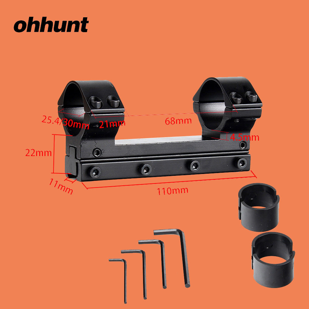

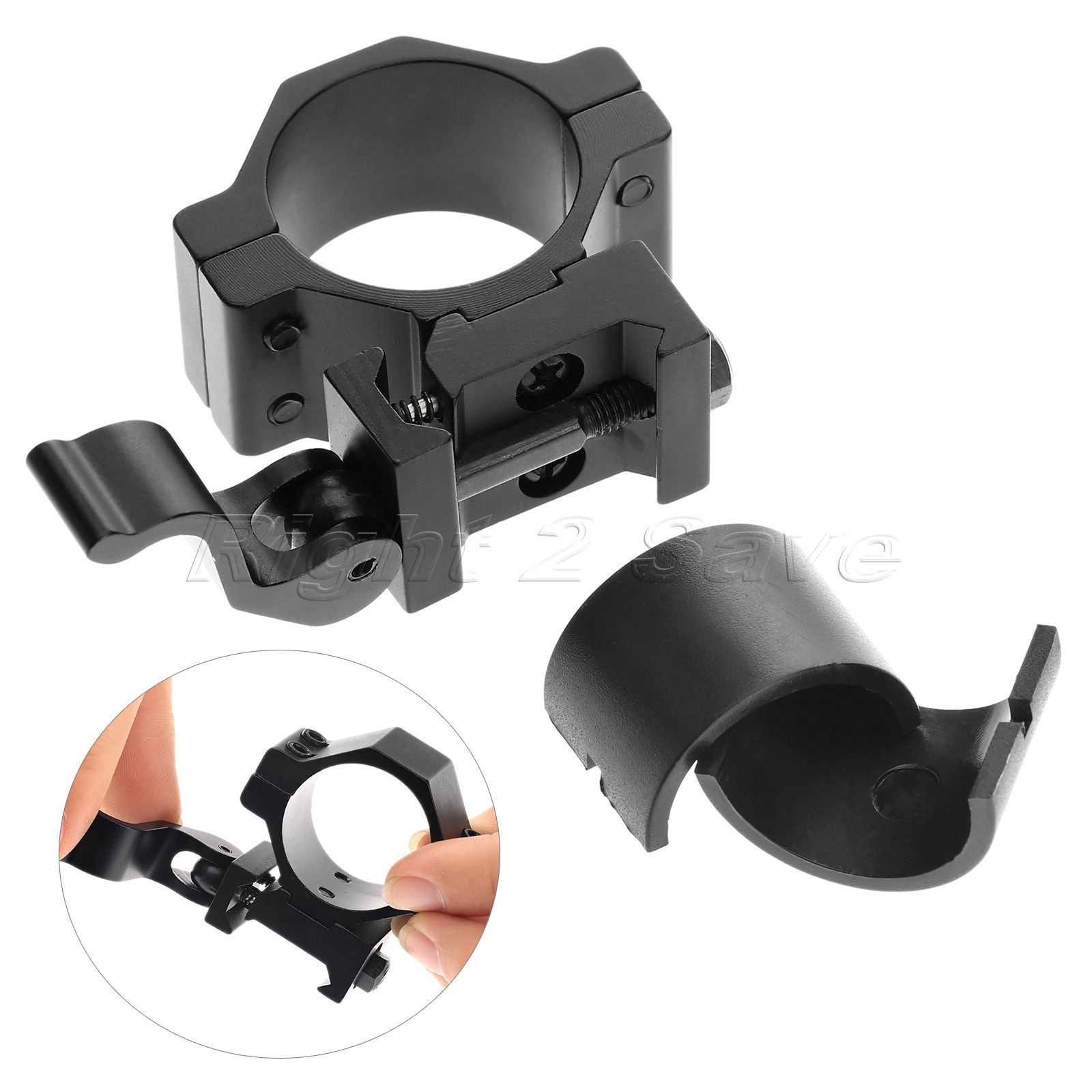

If you use QD rings you can remove the scope for storing.
I use these https://www.ebay.com.au/itm/Quick-Release-QD-30mm-25-4mm-Scope-Ring-Mount-Adapter-fit-20mm-Picatinny-Rail/181971374172
They have an advantage in that you can separate them and put shims between the base and the ring to cant the scope. Shims can bend and twist a scope, so it's not the best way, but it can be done.
This is the cheapest option I've found for putting cant into a scope on a dovetailed receiver https://www.ebay.com.au/itm/Ohhunt-1-30mm-High-Profile-Windage-Elevation-Fully-Adjustable-Scope-Mount-Ring/142711507063 I'm using one on a Ruger American at the moment and it seems to work just fine on the .22LR at least. It has two screws under one end, and pivots at the other end. Screw one in to increase the cant to where you want it, then tighten the second screw to pull it down tight against the positioning screw. Very simple, but you need to remove it from the receiver to adjust it.
QD rings.jpg (143.72 KiB) Viewed 6462 times
adjustable mount.jpg (87.22 KiB) Viewed 6462 times

Those mounts look good..I'll have to wait till I get the rifle as it is coming with a scope but I don't know what brand/size or what mountings it will have.
Then I can measure things and make sure I buy the right size,thanks for the link they are a lot cheaper than I thought they'd be and I think they are the solution to de-mounting for storage.
I won't worry about the sharing idea it was just a thought really.

Lots of price snobs will tell you the rings are garbage because they're cheap, but they work fine for me on all my rifles. I have another one-piece adjustable mount that was well over $100 but I'm hoping these cheaper ones will do as good a job on the .22's for a quarter of the price.
