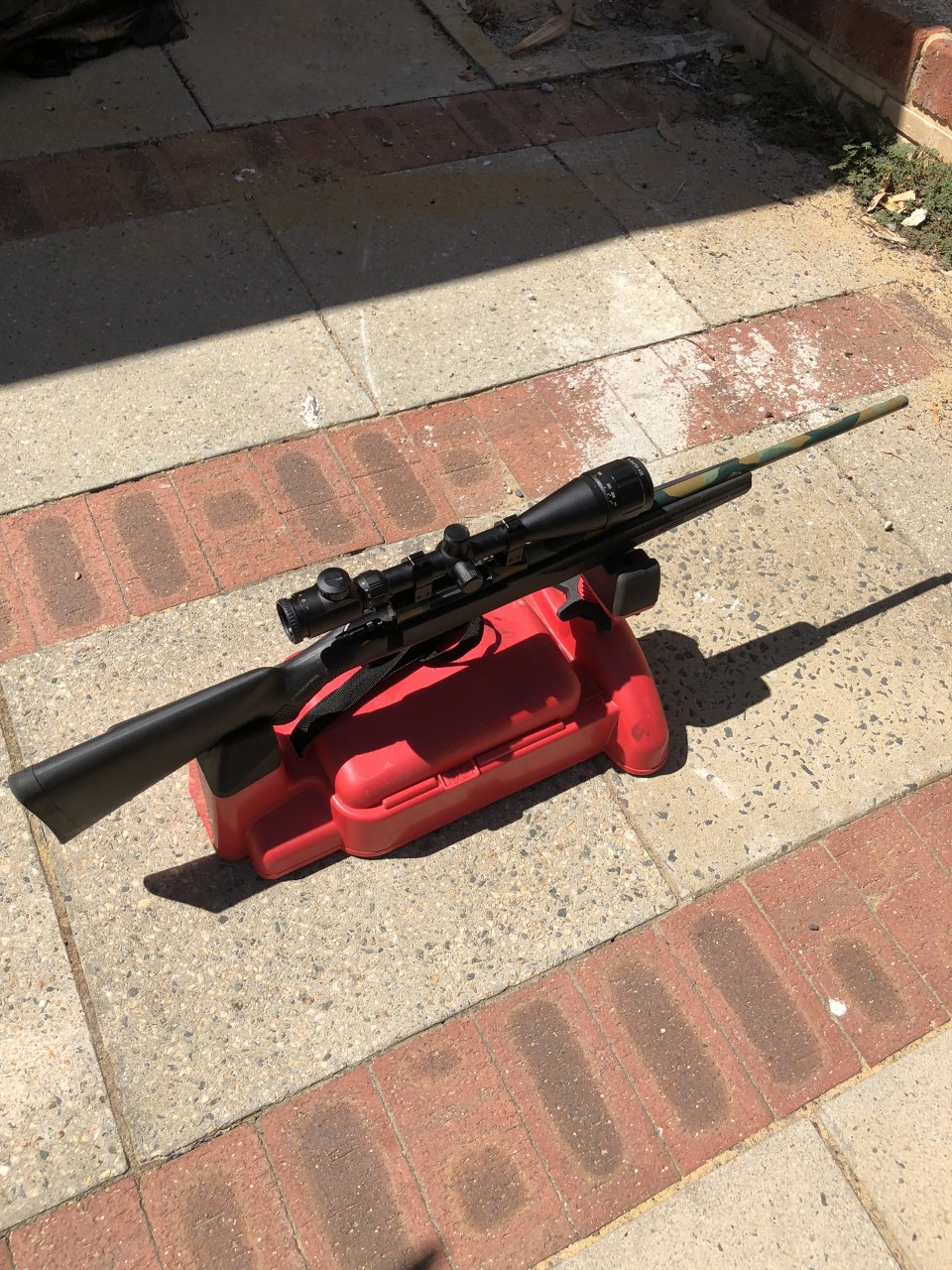

Post by duncan61 » 03 Jul 2019, 6:24 pm
I use this and also shoot Field class with it,The front rest has an adjustable winder and I adjust to where I am comfortable then get amongst it.It drops on the bonnet for long range shooting as well.Much better than bags and bipods :thumbsup:

Yeah, Ive seen them. MTM Predator? They're reasonably priced. Are you happy with it?

the rig that duncan is using has problems in that your rifle cant slide in recoil IMO better off bags but whatever works for you :drinks: :drinks:

The MTM Predator is the second one I have had and I am lost without it.You can be a smartass and open the compartment underneath and eject spent rounds straight into it.going to try the mirror thing very soon
