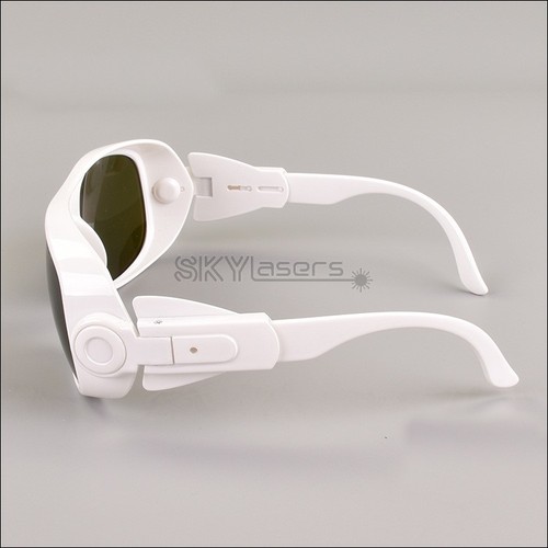

  • Consider using protective eyewear

I may buy one. I have no kids at home anymore and I may also buy proper laser safety glasses to go with it (must be made to exclude 850 nm range beams).
I could perhaps get away without the glasses if I take proper precautions .... :geek:

Anyone else imagine ramshackle looking like this?
