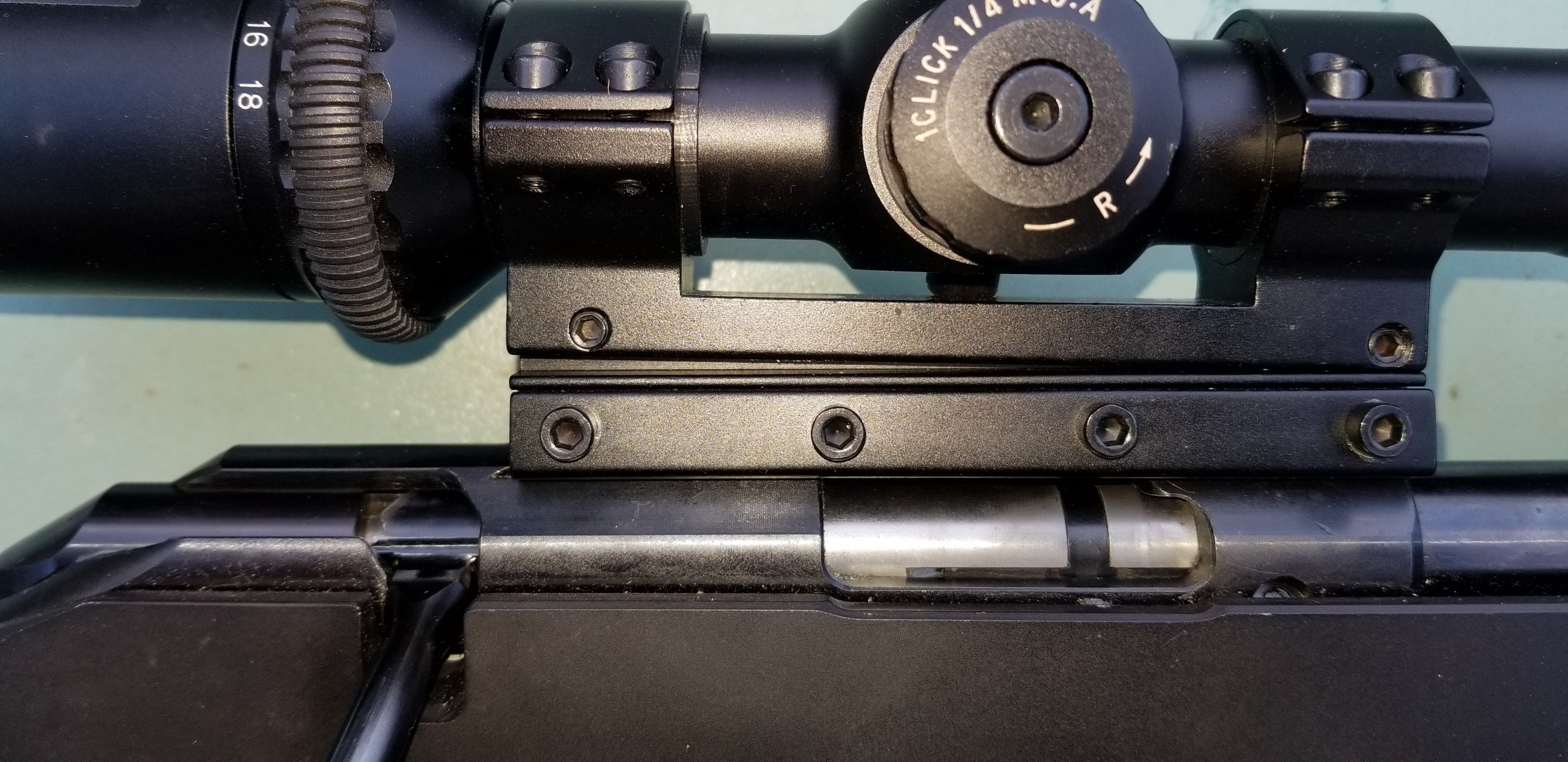

I use adjustable rings and adjustable one-piece mounts.
I'm preferring the one-piece mount but it is for a dovetail, not a pic-rail.
However, I'm currently playing with a scope on my RPR that does not have enough elevation adjustment to allow me to zero back to 50m on the RPR's 30-MoA rail. So I shimmed the front ring .012" and put 100rds through it today to ensure it is secure.
The first set of adjustable rings I bought were British Sports match, and expensive but there are now Chinese knockoffs available. The one-piece mounts are Knockoffs as well I guess, for about $40. The one-piece has a screw underneath to push the top of the rail up, and a second screw to pull it back down against the first screw. To adjust it you have to remove the rail, but once you set it up you wouldn't adjust it again. Mine is set at about 60-MoA currently. I wound the scope to the bottom of the turret, then used the rail to zero it, so I have the full 105MoA of elevation adjustment from a100m zero. Windage is adjusted via push screws on both sides of the front and rear of the rail. Loosen one side, tighten the other.
If you want a mount you can adjust while shooting, you'll have to look at some of the $500+ mounts with click adjustment.

The potential for putting force through the scope tube is why I prefer the one-piece mount. This is the setup on my Ruger American Target currently. The scope does get higher as you increase the cant. This one is 53mm above bore axis to the centre of the front ring. Building up the comb is easier than trying to mount the scope lower I find, and if you adjust the cant you will also need to adjust the comb height anyway.
I have bought some two-piece QD pic rail mounts, the ring comes off the base. I want to machine some pic rails at different cant angles, then I can screw them onto the QD bases, and mount the scope on top.
