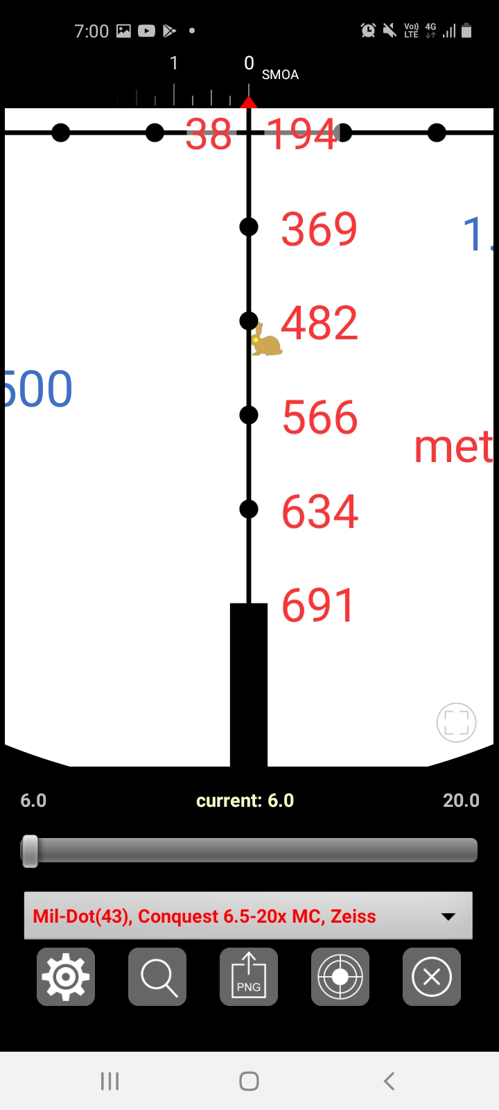

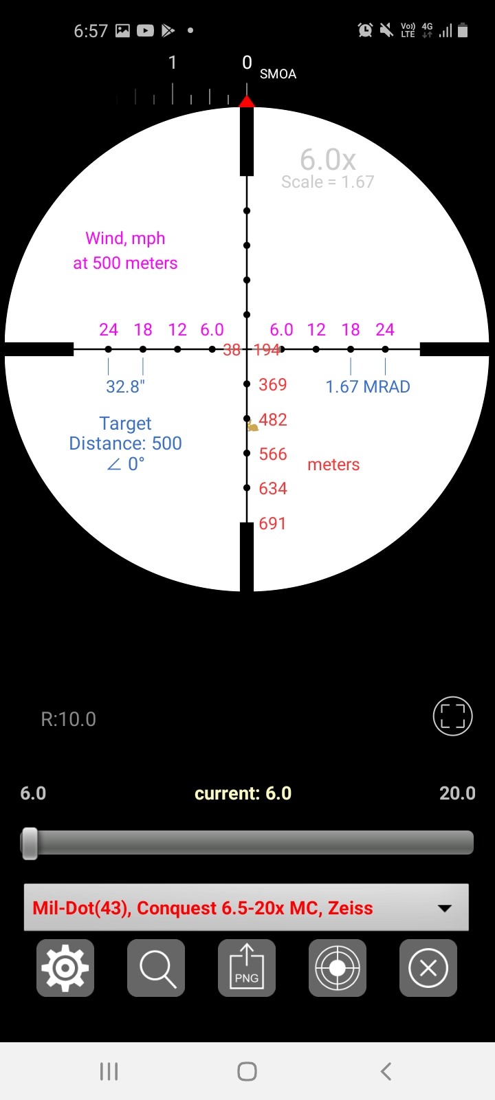

Here's what a rabbit size target will look at 6x mag @ 500 meters. You'd almost loose it behind a mill dot.
To add some more context to 500m shots, you can see movement through the scope from your heartbeat.
Unless you're exceptionally awesome, 6x will be just ok at 500 meters as long as you only plan on hitting large gongs, which is not exactly target shooting, its more just plinking.
Screenshot_20210526-185720_Strelok Pro.jpg (172.12 KiB) Viewed 15371 times
Screenshot_20210526-190040_Strelok Pro.jpg (161.56 KiB) Viewed 15371 times
