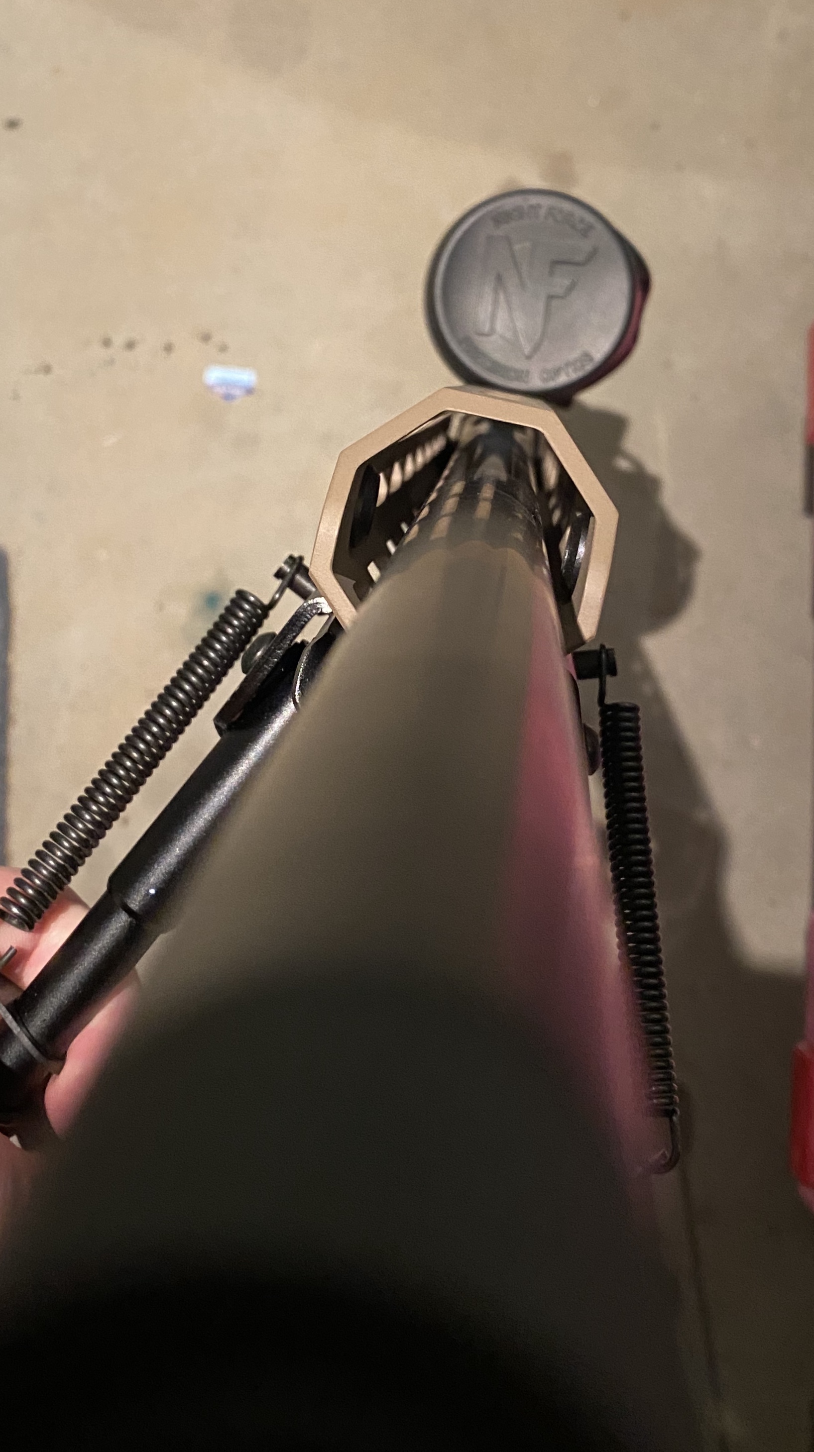

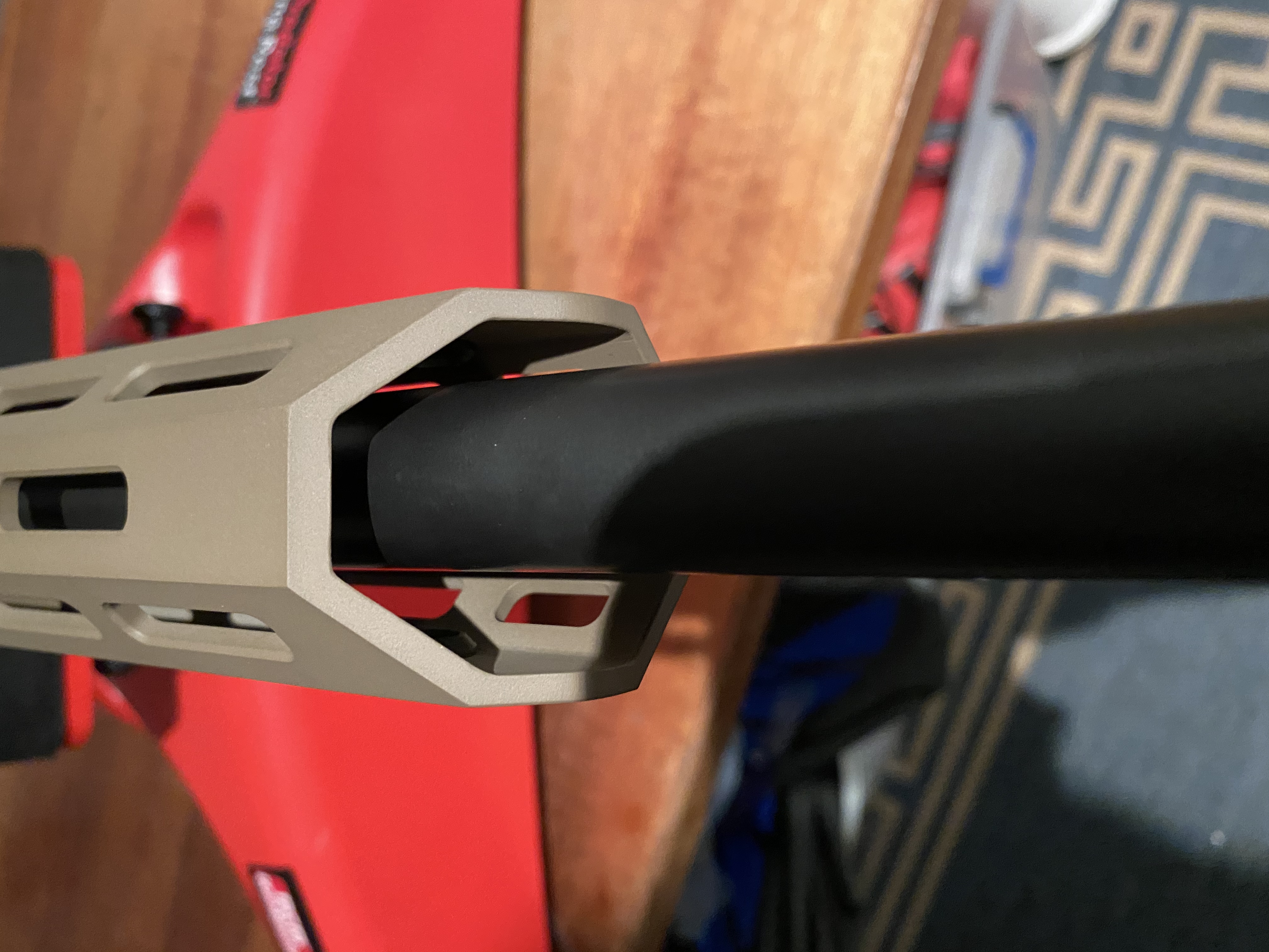

I’ve just been through a bit of an ordeal and thought I’d ask how others do it - and shine a light on some mistakes I made.
Fitting a new scope to my mdt chassis / howa and I attempted to get the vertical reticle in the scope aligned with a window frame which should be vertical.
So even using a rest, I simply could not get the chassis vertical and zero’d when compared to scope mounts - I put meter onto mounts and it would be zero, then onto chassis and it would be 2.5 + degrees out...so there was no way I could get reticle aligned.
So a closer inspection and more measurements show me that the chassis fore end is not aligned with the barrel by a fair margin and is actually twisted (see pics) It appears as if the MDT chassis is not as precision as they reckon - in fact, I think I might shoot the retailer an email see what they say.

Post by TassieTiger » 18 May 2020, 9:07 pm
I send MDT an email with pics and their answer was not exactly confidence inspiring...here is their response in entirety;
Anthony Xxxx (MDT)
May 18, 2020,
“Alright, on the Howa 1500 this can come up from time to time. It won't have any effect on performance but you can try and push it into the center a little bit by loosening off the action screws and pushing it to the opposite side and then retightening them down.
Regards
Anthony Xxxxx”
Customer Support
Obviously, I tried this and anyone who has put together one of these chassis kits will know that the holes that are cut for the action screws do not allow for any movement, so pushing it to the side with a screw loose, does sweet bugger all. Even if you could gain a mm, it would then be under tension and recoil would eventually move it.
I guess I could take it to a smith and have the locking lugs straightened (See pic with fore end removed)...so much for a precision chassis though.
I’ll await their further response.

Re: Setting up new scopes level - MDT chassis ISSUE?
Post by TassieTiger » 19 May 2020, 7:41 am
So another very poor response from MDT...
“The issue is the recoil lug on the Howa 1500 is not perfectly parrel and when pushed into the chassis this issue shows up. I'm not sure that there is enough material there to accommodate that (removal of metal) on the lug (to get it straight). You can have a smith try to but, you will need to bed it after.
Regards MDT.”
So the problem with this is numerous...
The original houge stock saw the rifle sitting dead straight so it’s not likely to be the recoil lug and I’ve offered to refit the action to the houge to prove it...
No one buys a $1400 chassis kit to have to get it bedded and if this issue shows up from time to time - maybe a warning or advice might be in order?
I was warned about buying a mdt - being they can apparently be hit and miss...I should have listened but the ESS looks got me in...that being said, I’d prefer function over form any day.

Post by TassieTiger » 19 May 2020, 8:05 am
Dudley, I’d hope that they would not attempt to retail a rifle with so much twist in the chassis.
MDT think it’s a howa / houge issue - I think it’s a misalignment of action mounting holes in the mdt chassis ...if they are off even .5mm Between the mounting holes at the action, by the time you take that misalignment 18 inches, you’d be 5-8mm out which is what I’m seeing. My concern is that it’s not only a horizontal misalignment...
Hopefully I can work something out with MDT.

Post by TassieTiger » 19 May 2020, 8:28 am
The fore end locks onto the shown lugs In the pic - the screws only secure it “firmer” onto the lugs. The lugs are not sitting equal...
There is no adjustment to speak of.
Update - so MDT are looking to resolve which is good news, despite them still believing it’s the recoil lug. But, they are willing to send me a new chassis to confirm either way which helps elevate my confidence in their support.
