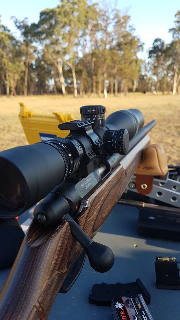

These are what I used .

Re: Leupold Dual Spring Precision Adjustments
Post by Wm.Traynor » 12 Jul 2021, 10:07 pm
Thank you deye243 but what kind of scope are those turrets attached to :)
Posts: 1826
Post by deye243 » 12 Jul 2021, 11:35 pm
Wm.Traynor wrote:Thank you deye243 but what kind of scope are those turrets attached to :)
Leupold vx3i 4.5-14 x 40 AO .
