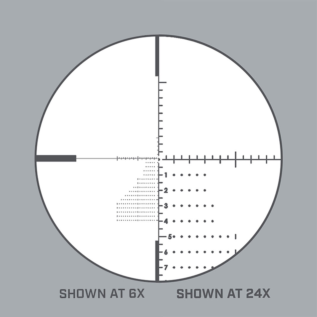

Post by bladeracer » 06 Sep 2021, 6:16 pm
This is an example of an FFP reticle.
https://www.bushnell.com/riflescopes/match-pro/match-pro-6-24x50-riflescope/P2178035.html
This is the 6-24x50 Bushnell Match-Pro (which I think is a great FFP scope).
The reticle at 6-power is nice and fine for target work, but wind it up to 24-power and it's four-times the thickness. That's the reverse of what you want for hunting and for shooting paper. You want a heavy reticle that is easy to pick up quickly at minimum zoom for snap-shooting while walking into an area, and a very fine reticle when at maximum zoom for precision shooting.

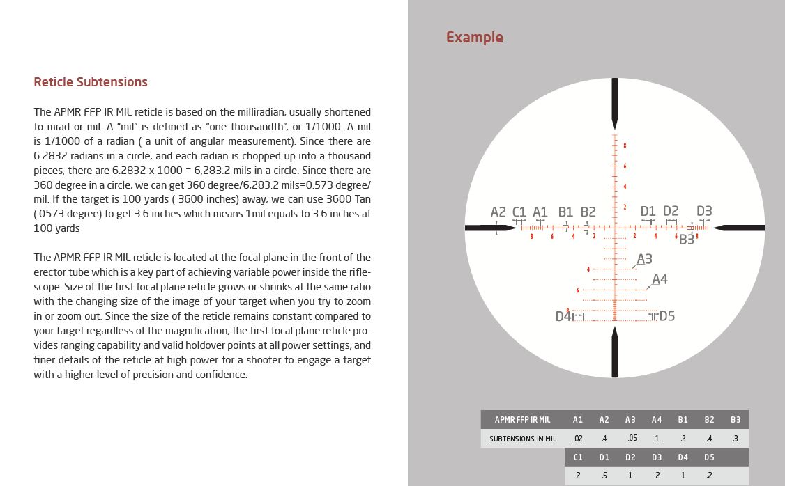

Re: Another Newbie another which scope....any advice appreci
Post by bladeracer » 06 Sep 2021, 7:08 pm
Larry wrote:I have a Athlon Argos 8-34 and on max zoom the hash marks are no bigger than my SFP NF BR much smaller than my NF NXS 8-32. I also have a Bushnell 6500 6-24 50 on my 22 and have no issues with the retical blocking out the super center dot on a 22 target the size of a ball point pen dot.
Have a look here - https://athlonoptics.com/product/rifle-scopes-argos-8-34x56-apmr-ffp-ir-mil/
You can clearly see that the reticle is _much_ thicker at higher magnification.
And from the manual.
Athlon Manual.JPG (106.36 KiB) Viewed 9249 times
I can't find any reference to the thickness of the reticle, but the hash marks at at .5Mil, and the reticle looks to be about one-tenth of that, so maybe .05Mil thick, so 5mm thick at 100m at 8-power? Which makes it 21.25mm thick at 100m at 34-power? Perhaps it's finer than that, but it still means the reticle is 4.25 times thicker at max zoom than it is at min zoom.

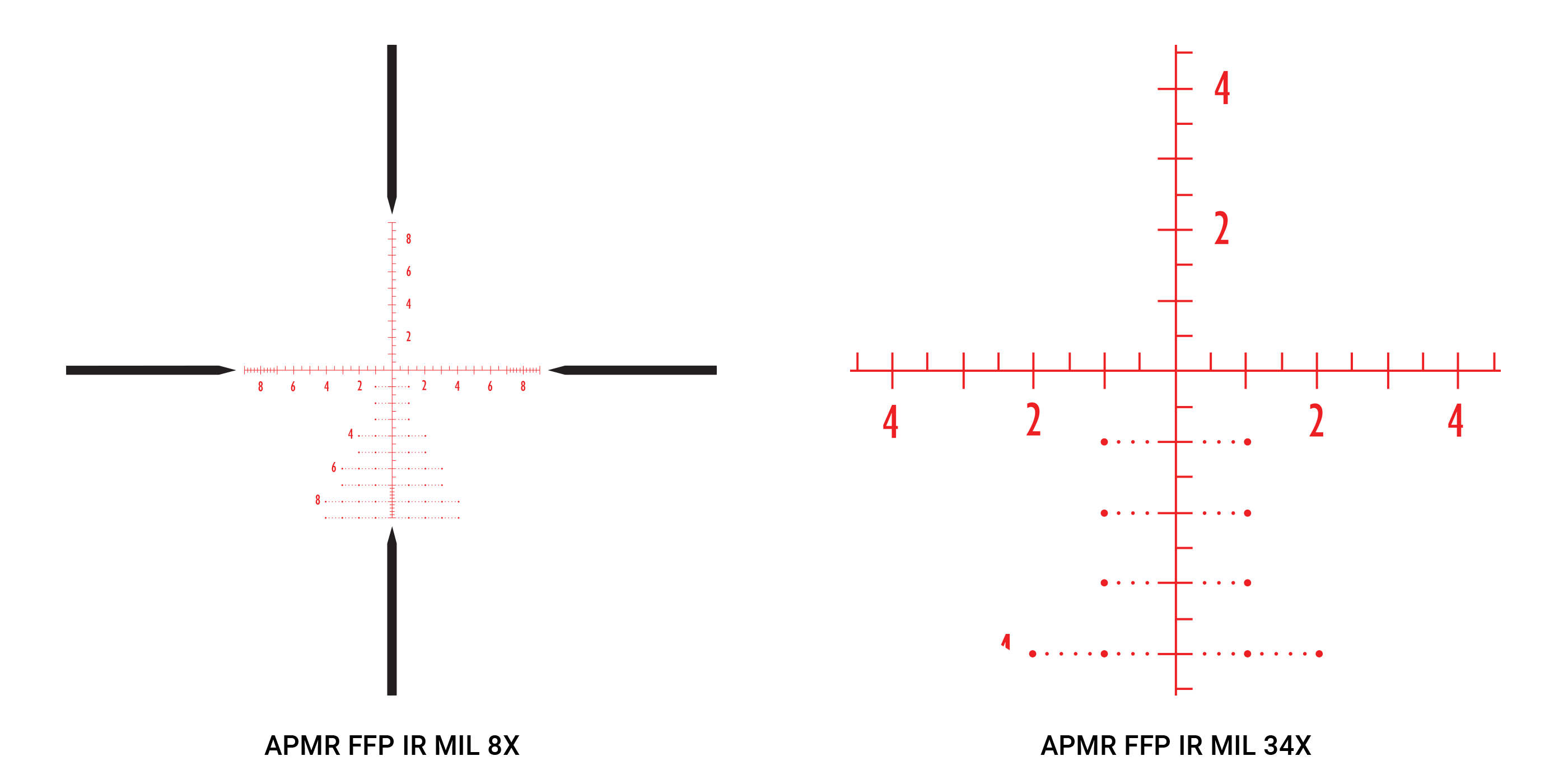

Post by bladeracer » 06 Sep 2021, 7:18 pm
The NXS if it has the MOAR-T reticle is only .0625-minutes thick, one-sixteenth of a minute, or 1.8mm thick at 100m, and 18mm thick at 1000m.
https://www.nightforceoptics.com/au/technology/reticles/second-focal-plane/moar-t-reticle
Quite astonishing, and half the thickness of my mate's Athlon, but could you use this in the field trying to sight on a rabbit in the grass at 100m?
If it's the MOAR reticle it's between .100MoA and .160MoA (my mate's is .125MoA).
https://www.nightforceoptics.com/au/technology/reticles/second-focal-plane/moar-20-moa-reticle
