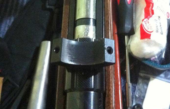

I'm with 1290. I've done it, only ever once for a rifle/ring set then marked them front and rear.
A length if 1" and 30mm S/S round with a 12mm hole tapped in the centre for a handle cost me $0
Course and fine valve lapping compound from supercheap auto.
Mount the scope and triple check ring position then remove the scope and lap the rings. I was amazed how poor the contact with the scope was at first, it took quite a bit more lapping than I'd expected to get a >50% clean up on the surface where the scope sits. If you can borrow the gear I'd suggest its worth the time to at least check your setup
These were sports match rings on an anschutz actioned weatherby mkxxii
lapping scope rings

Thanks for the photo Chronos.
That is more material taken off than I would have expected.
