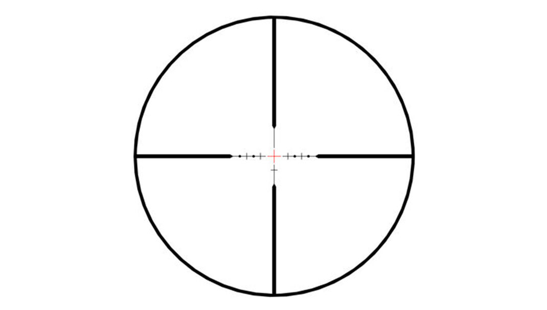

I just use the AR Optics 4.5-18x40 on mine, which would likely come within your budget. $295 at Cleaver if they have stock. They do a version with a reticle you might find better for holding wind, but it's $365. The standard reticle only has a 3-minute windhold on the reticle, but if you combine it with an edge-hold on the target it should cover most normal wind conditions for the .22LR out to 100m. The ram for example is 160mm wide, or 5.5-minutes, so an edge hold (on the nose or bum) gives you 2.5-minutes of wind, plus the 3-minute reticle gives you 5.5-minutes at 100m, which is a decent wind. The Wind-Hold reticle gives you 6-minutes in 1-minute marks I think.
This is the standard reticle.

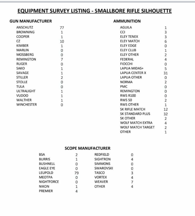

Post by Strikey » 08 Jun 2022, 8:24 pm
This is part of the equipment list, Smallbore rifle, from the 2021 NRA Silhouette Nationals over in the States. Gamerancher might be familiar with some of this stuff :thumbsup:
Strikey
Posts: 313
Re: Budget scope for Rifle Metallic Silhouette
Post by in2anity » 09 Jun 2022, 10:07 am
surprised that there's no nigthforce on that list - reinforces everyone's advice i guess, Leupold "do the job".

Post by Strikey » 09 Jun 2022, 7:46 pm
in2anity wrote:surprised that there's no nigthforce on that list - reinforces everyone's advice i guess, Leupold "do the job".
When you have weight limits on your rifle Nightforce scopes are just too heavy, if you take the weight out of the rifle to accommodate a heavy scope the rifle then becomes top heavy and unbalanced, becomes uncomfortable to hold steady while shooting offhand. Leupold scopes are light for their size, tracking is repeatable and the glass is more than good enough, also their reticles are either fine duplex or crosshair with a centre dot, you don't want a busy reticle for silhouette.

Post by SCJ429 » 09 Jun 2022, 7:56 pm
Most Nightcore options are pretty heavy, counts against them in this type of comp.
