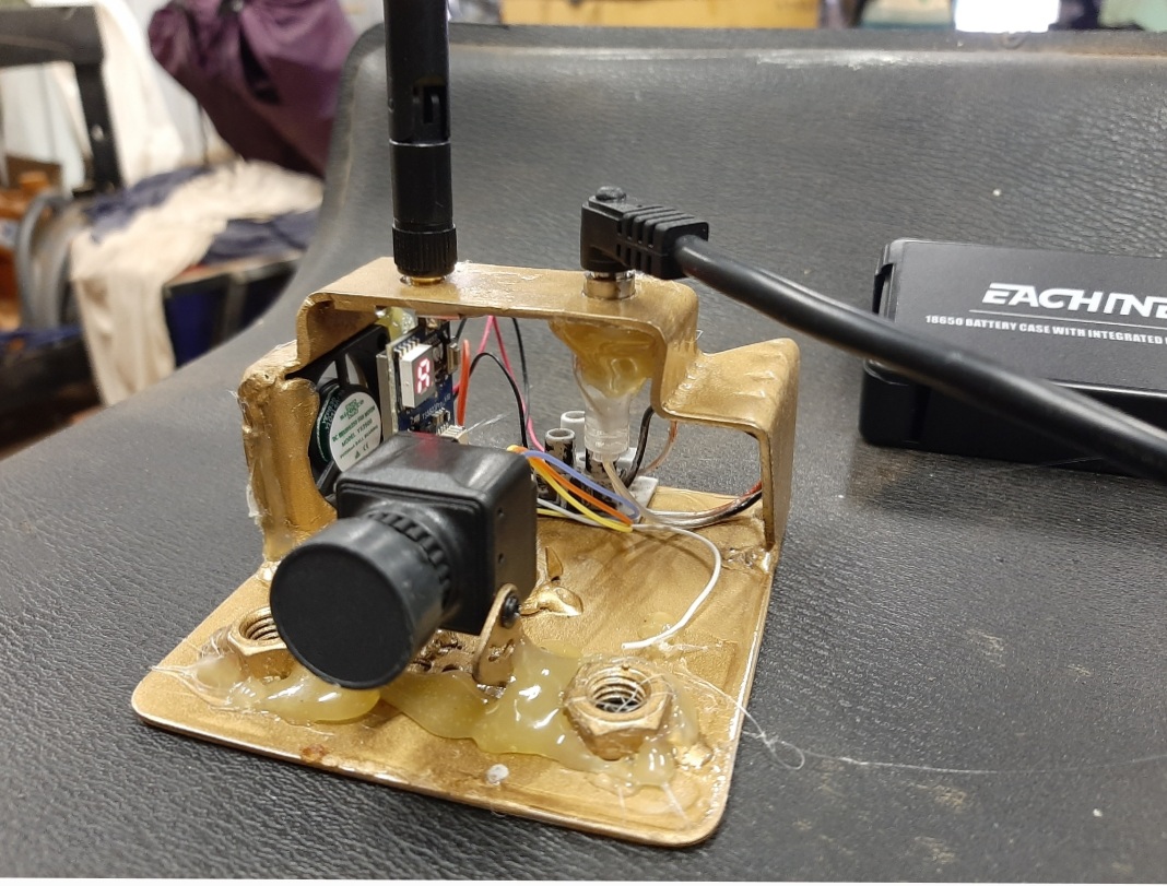

Today I finally had a chance to start an actual build of the camera "unit". With a bit of skulduggery I made a frame that would hold all the components and have mounts for adjustable legs or tripod.
Please don't judge, it's definitely not my finest work but a few tack welds and some hot glue produced the above in a couple hours.

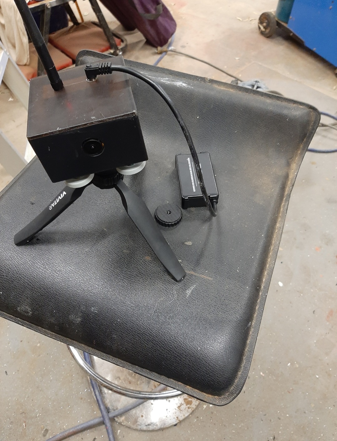

Post by scoot » 29 Oct 2022, 6:04 pm
Finished prototype 1.0
Hopefully I get a chance to check range, image, battery, heat dissipation, etc tomorrow. Should work easily enough to 200m even without long range antennaes. As long as the target image is good and it doesn't melt down after running for a while should be a winner.
