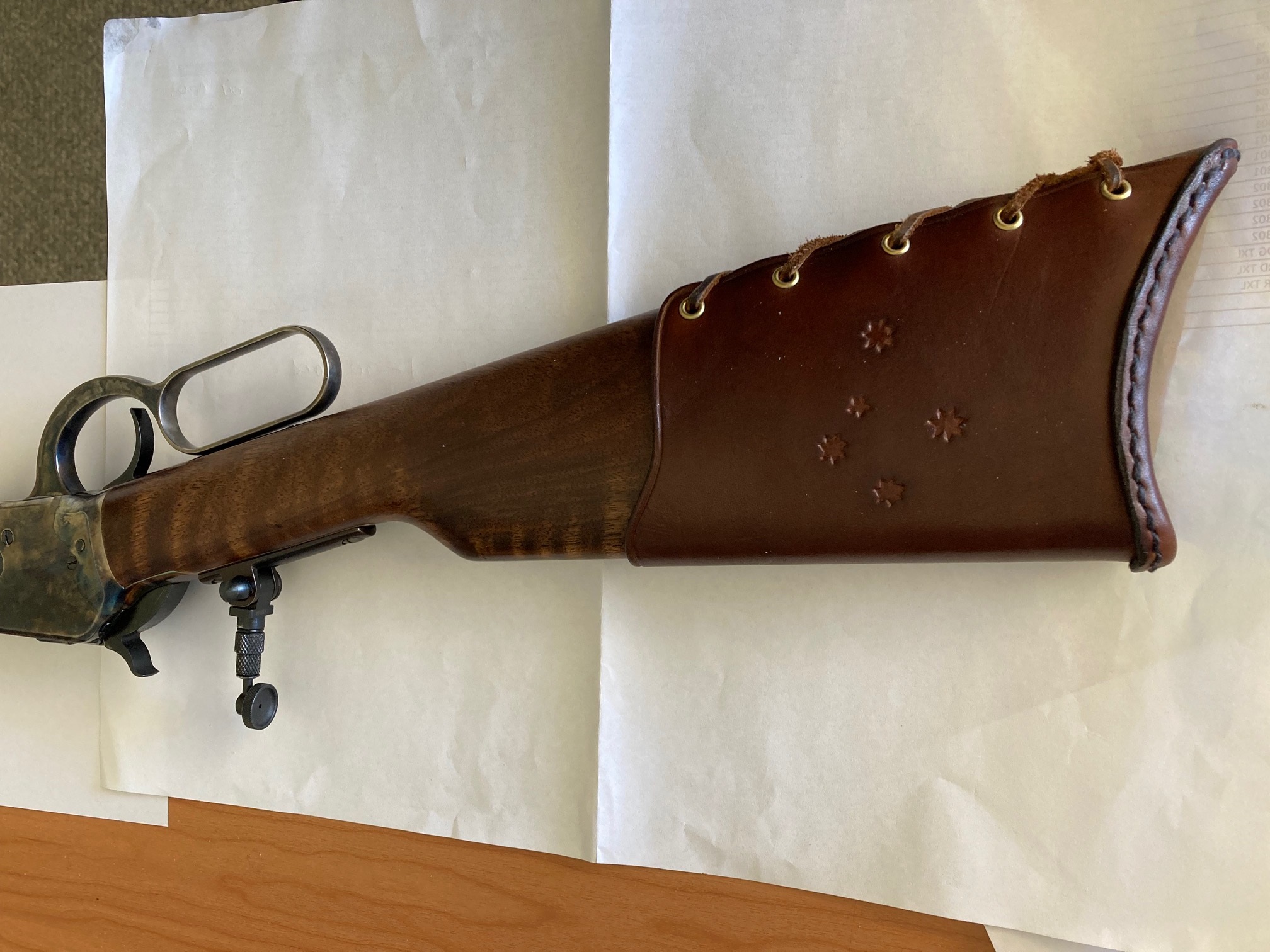

My Winchester 92 wears a Marbles tang sight which is very similar to your Lyman. I removed the bead front sight and replaced it with a flat topped blade that I prefer and I'd do that with the Rossi once I know the required height.
The Rossi carbine needs drilling and tapping of a second hole for a tang sight, unlike the Chiappa which is true to to the original 92s.
