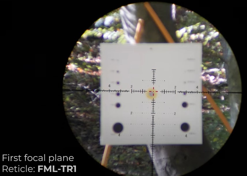

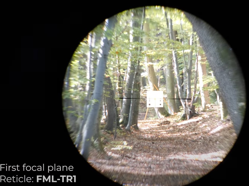

I happened to watch a video review of a very high-quality March FFP scope just now (according to the video it retails for E3500 or about $5500).
https://www.youtube.com/watch?v=VxTbZveUkJA
At 4.5-power you can see that the reticle is near invisible even against a white paper background target - 11:33 in the video.
Screenshot 2022-10-26 135218.jpg (105.61 KiB) Viewed 5125 times
At 28-power the reticle is much larger, to the point of obscuring tiny aiming points - 11:44 in the video.
Screenshot 2022-10-26 135248.jpg (64.76 KiB) Viewed 5125 times
FFP works backwards in my opinion, you want a fine reticle at high-magnification when you're trying to hit a small target at longer range, and a heavier reticle at low-magnification when you need to pick up the reticle very quickly on a close-range moving target.
As for the reticle stadia being the same regardless of magnification, good luck trying to even read the markings on the reticle at low-magnification :-)
Stick with SFP.

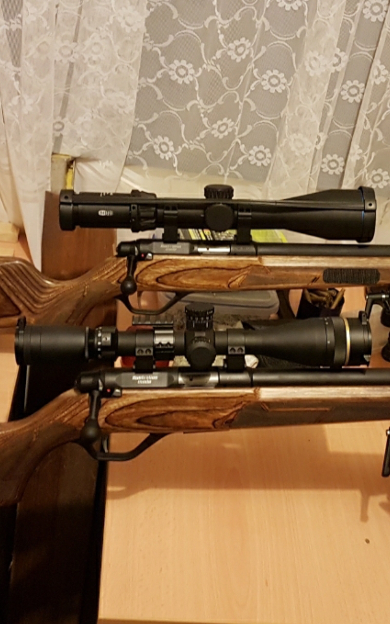

Anyway here is a pic of my two rimfires 22 has meopta optica 6 3-18X56 my 17 hmr has a leupold x3i 4.4-14X40ao now if I was hunting pigs and goats the loupy would be my go to unless I was spotlighting.
And yes it worked great on a centerfire too .

bladeracer wrote:I happened to watch a video review of a very high-quality March FFP scope just now (according to the video it retails for E3500 or about $5500).
Stick with SFP.
I don't doubt SFP can be made to work, but as a user of FFP scopes, I find the negatives you list don't matter in actual field use.
That low-mag reticle might look invisible in the video, but what a video camera sees and what your eye sees are not the same. In that video capture, the white target board is way overexposed, so you can't see anything, including most of the aiming circles on the target. The overexposure in the screengrab has also obscured the reticle markings. With first hand experience myself of starting with SFP before selling it and now owning 4 x FFP scopes, I would say that a FFP reticle is visible in real world use at all magnifications. What it isn't so good at is fast acquisition when on low power. The lines on the reticle are small at low magnification. Quite visible, but small. But as pointed out in one of the other posts above, if you need fast acquisition at low magnification, then just turn the illumination on. The illumination on most scopes turns itself off after a few hours, so if you forget to turn it off you will still have a battery for next time.
FFP reticles almost always will have a very small central aiming dot with crosshairs leading into it. At low magnification, the crosshairs are visible. At high magnification, the small center dot is visible. There is always a useable aiming point. In the second video screen grab, with the March scope at high magnification, you can see the center dot illuminated with small illuminated crosshairs around it. That looks quite useable!
I spent the weekend shooing small (0.15 or 0.20 millirad) targets from 400 to 1610 metres (1-mile) all with FFP scopes and I really did not have any problems with FFP, whereas a SFP would have been very problematic and would have limited my shooting. If you want to have only a single magnification available for use for high precision shooting, then SFP is viable. If you need high precision and you need variable magnification, then it is FFP.
