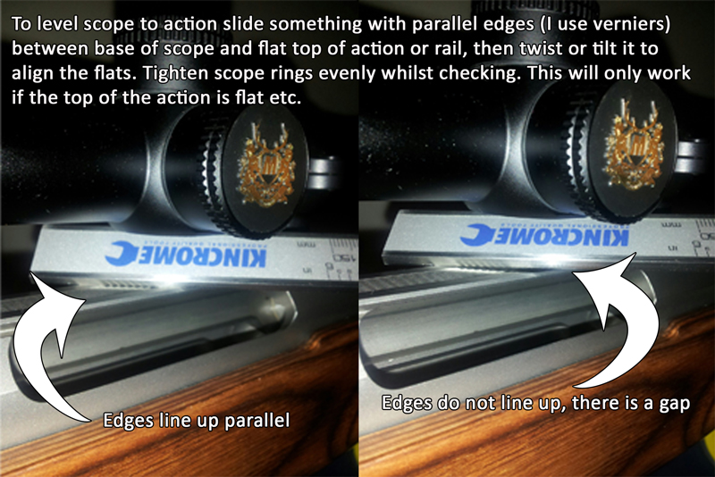

Here's my pic of how I did my T3 and some others before, simple, quick and works easy as long as the action is flat on top or you have a rail to work off.

Pro photo examples there Stevo :D

Yeah, cheers mate.

Arrows for dummies :lol:
