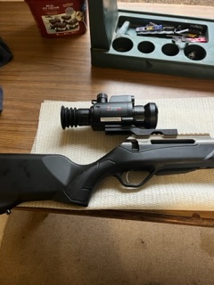

After playing around before I mounted it, spotting stuff outside for a couple of nights it seems to be pretty decent. I think the built in rangefinder will be well worth it.
I had it mounted on a Lithgow in the shop before I bought it, so I was well aware of the height and that a cheek riser would be needed.
So, any advice on cheek risers? Just a padded velcro wrap around job, a Kydex? Victor Company make one that looks good, but keeping in mind that it will no doubt have to be removed to take the bolt out.

Post by Shootermick » 31 Jul 2023, 9:30 am
mchughcb wrote:Bradley cheek risers
I’ve seen them. Bit of a hybrid between a kydex type but held on with velco straps. Pricey though.
Good bit of kit?
Even though the rifle only has a plastic stock, I’m still not too keen on drilling holes if I don’t have to.
