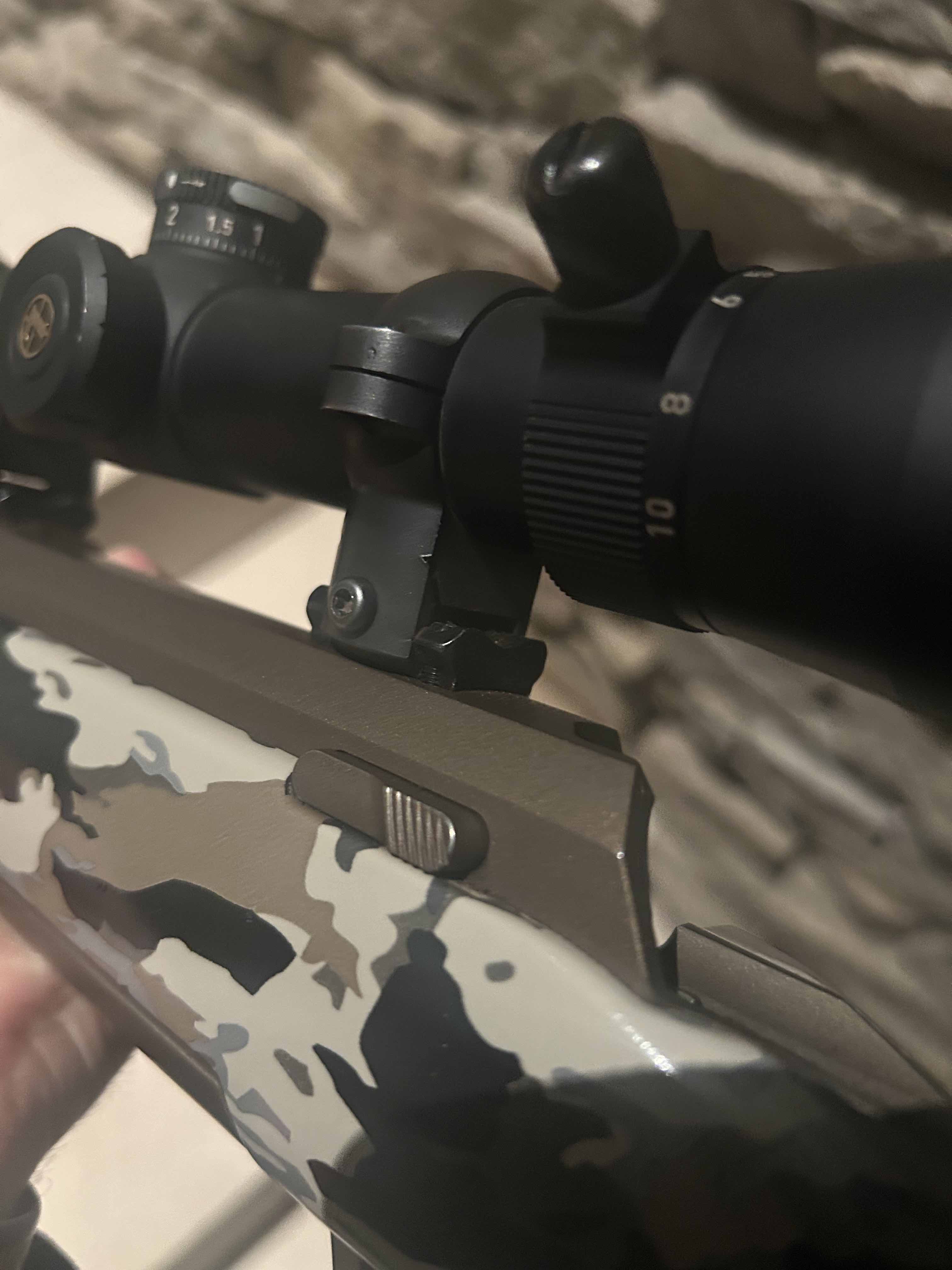

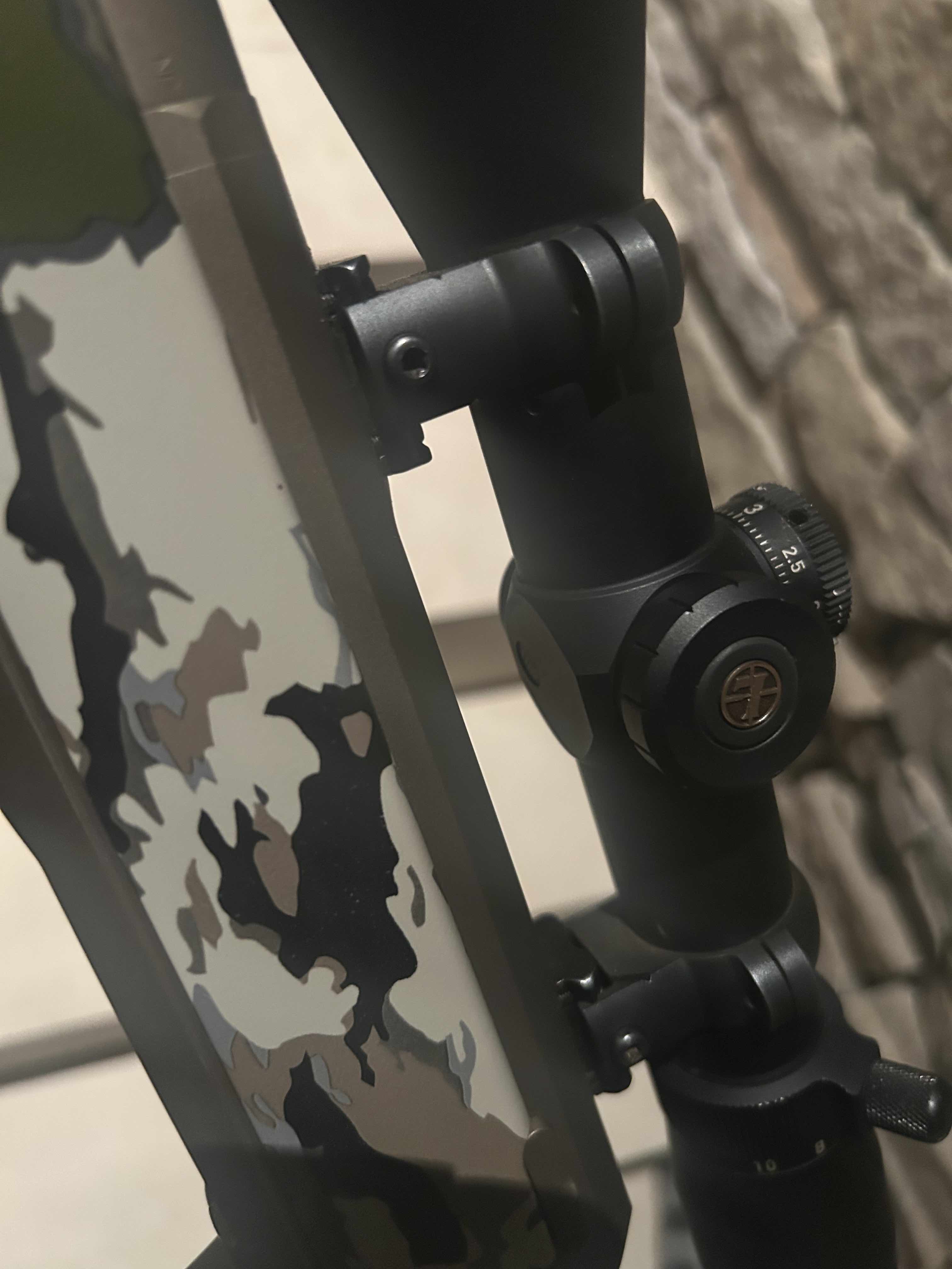

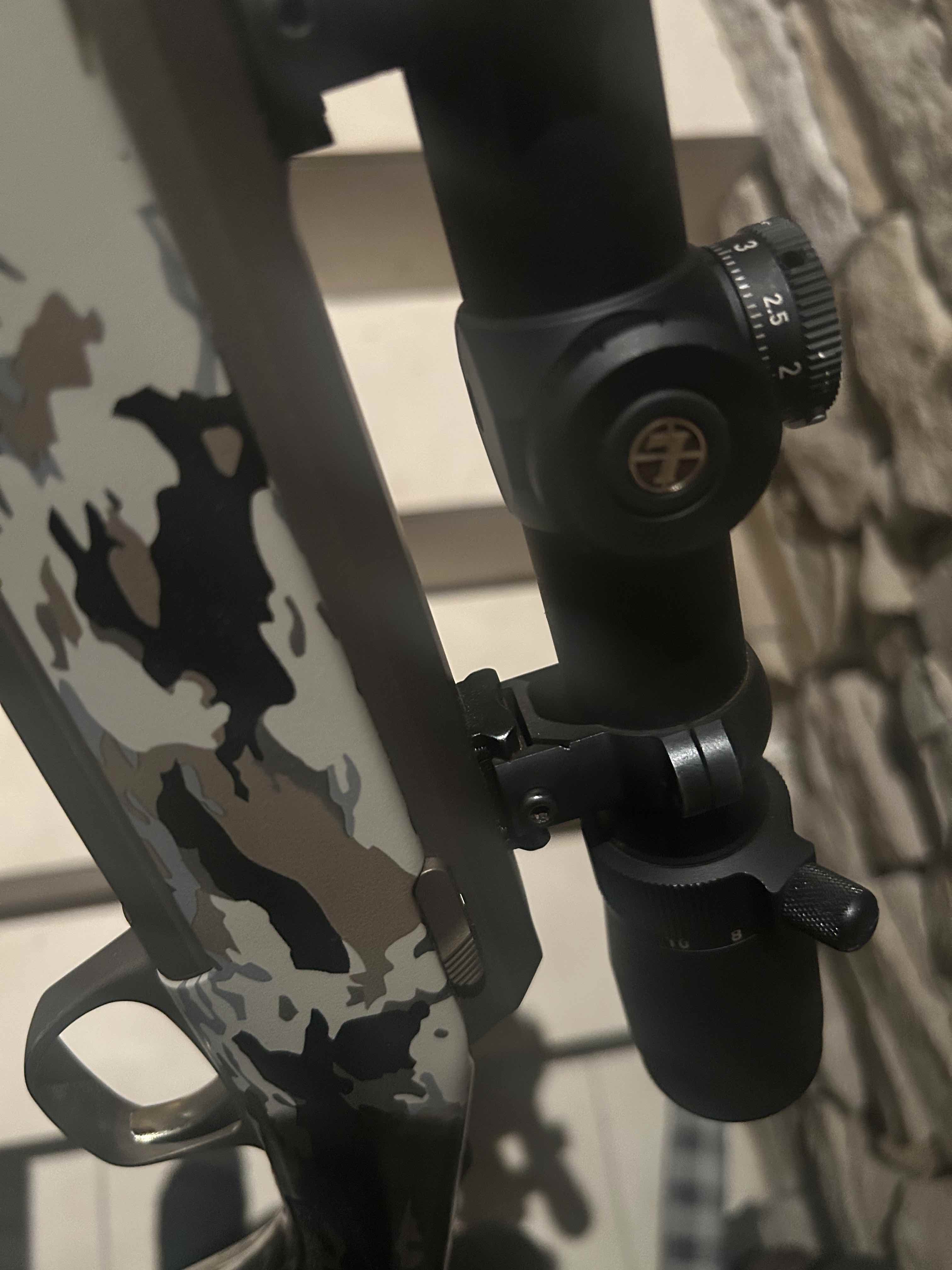

Post by MG5150 » 16 Sep 2025, 10:32 pm
Hi All
I own a Browning X Bolt with a Leupold scope. Can anyone help me identify what sort of mounts/rings are used for the scope?
Are these individual Picatinny blocks or would allow a thermal scope with picatinny grip to attatch?
All help greatly apprecaited.
***Edit - After doing some googling I think i am inquiring about what the mount piece is rather than the rings that grab the scoope
Mount 3.jpg (357.29 KiB) Viewed 8349 times
Mount 2.jpg (323.5 KiB) Viewed 8349 times
Mount 1.jpg (357.5 KiB) Viewed 8349 times

Re: Help Identifying Scope Mounts
Post by SomeoneElse » 16 Sep 2025, 11:10 pm
They look like two pieces of Picatinny base to me, though they might be Weaver bases. Compatibility with a thermal scope would be “it depends”. If the thermal scope is a tube style then a set of pic rings could be positioned wherever they need to be along the tube length to ensure the rings seat into your two-part base locations. If instead your thermal has integral pic clamping then the two-part base might not necessarily have the horizontal slots in the right/useful positions where the thermal clamp is expecting.
I have a single piece pic base on my X-bolt which straddles the chamber. That provides maybe 13 horizontal slots which gives some variety in slot spacing options for different scope types. My day scope uses rings like yours, occupying the front-most and rear-most horizontal slots. When I change over to my Holosun 510C sight it’s integral clamp seems to prefer the cross-pin to sit in the second-from-front slot. Putting the Holosun cross-pin in the front most slot leaves 1/3 of the reflex sight (and its clamping mechanism) hanging over the front of my pic base.

Post by bladeracer » 16 Sep 2025, 11:52 pm
MG5150 wrote:Hi All
***Edit - After doing some googling I think i am inquiring about what the mount piece is rather than the rings that grab the scope
Look like Weaver bases to me. I would think it unlikely a one-piece mount would happen to fit into the grooves of them. Does your thermal have separate pic mounts or is it all one-piece?
You could remove the bases and use a single length of pic rail with the side cut out for the ejection port and drilled to match the existing holes. Or you could use a round file to cut out one of the slots until it does properly match your mount.

Post by womble » 17 Sep 2025, 3:46 am
Agreed. Likely weaver. You need the picatinny rail SomeoneElse mentions. Ideally the browning one for that rifle. Which will probably cost a ridiculous amount of money.
How much do you want for it SomeoneElse ?
Use SomeElse’s quote for the better price you found elsewhere https://huntthenight.com.au/products/talley-browning-x-bolt-picatinny-rail?srsltid=AfmBOopNcHLcMnIb5GWdG0wy-UHqu__6OA3jyDrevkBMaxROL3LQdfYa
Edit that’s a different manufacturer. Make sure it fits your model.
More Edit. Quite a few available according to googly . Different brands. And are they actually available as in stock. Or not really.
And your next question. 0 moa rail. 20 moa rail . :unknown: Which one do you want and why.
Bladeracer can take that one. He uses a 1000 moa rail to fire a 22 rimfire over 100 kms when the wind is right.
