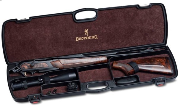

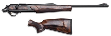

Post by dorpel » 10 Feb 2015, 8:01 pm
FYI if you're interested Melanie the Browning Maral is a takedown build like you're picturing.
Browning Maral
Browning Maral
