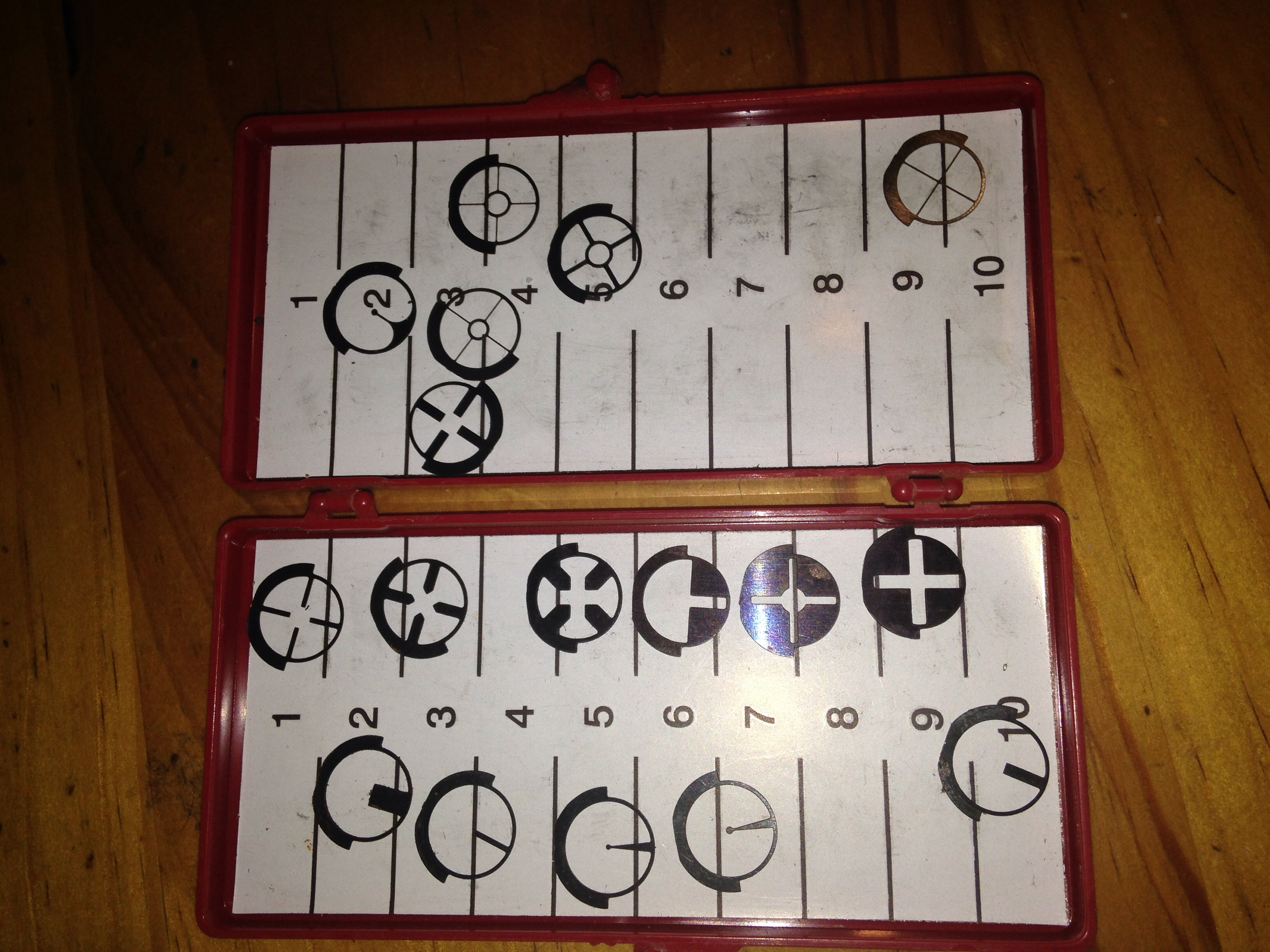

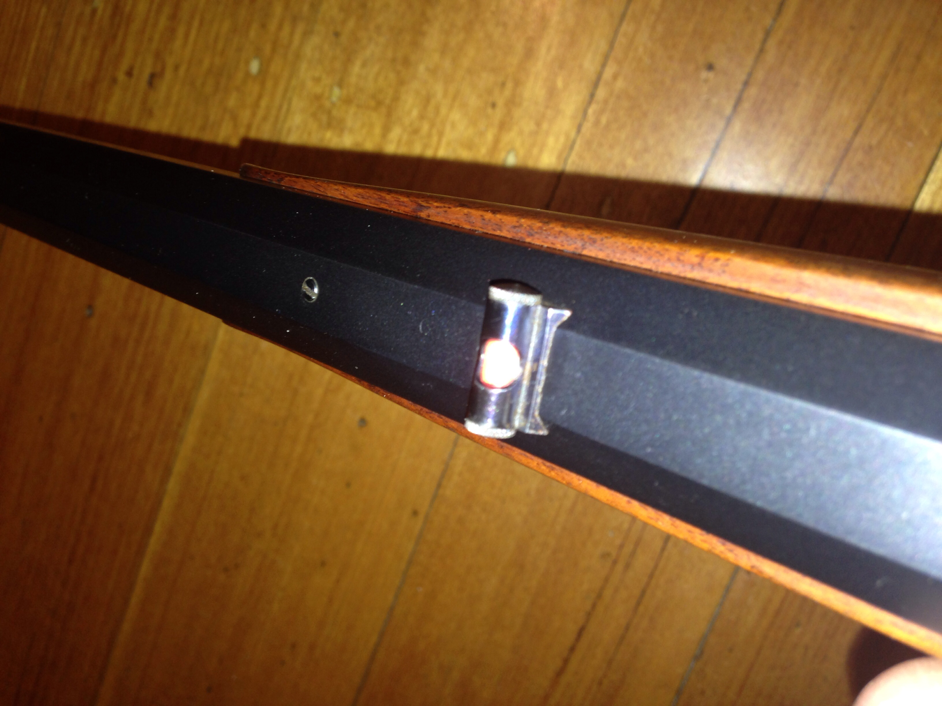

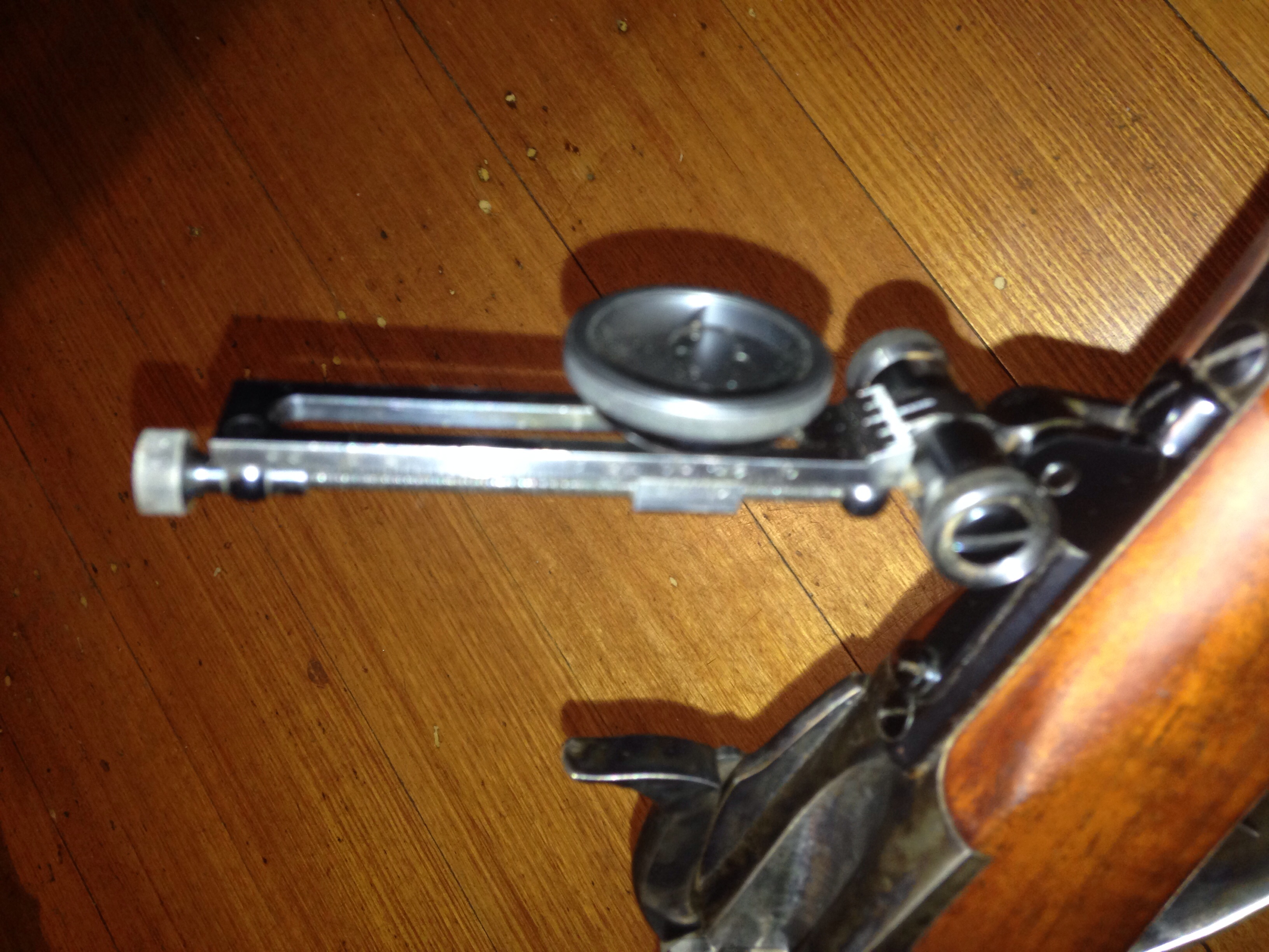

That is a nice piece of kit and makes me drool! Soule vernier sights are the only way to go but they aren't cheap. A globe front sight with changable reticle inserts with or without a built in spirit level are also needed though a separate level mounted in the rear dovetail is good too.
Re: Tang sights for High Wall
Post by Noisydad » 20 Jun 2015, 9:17 pm
Selection of front sight inserts
Mid mounted spirit level.
Soule tear sight.
These pics are of the sights and front inserts on my Sharps and are the sort of thing needed on your 1885.

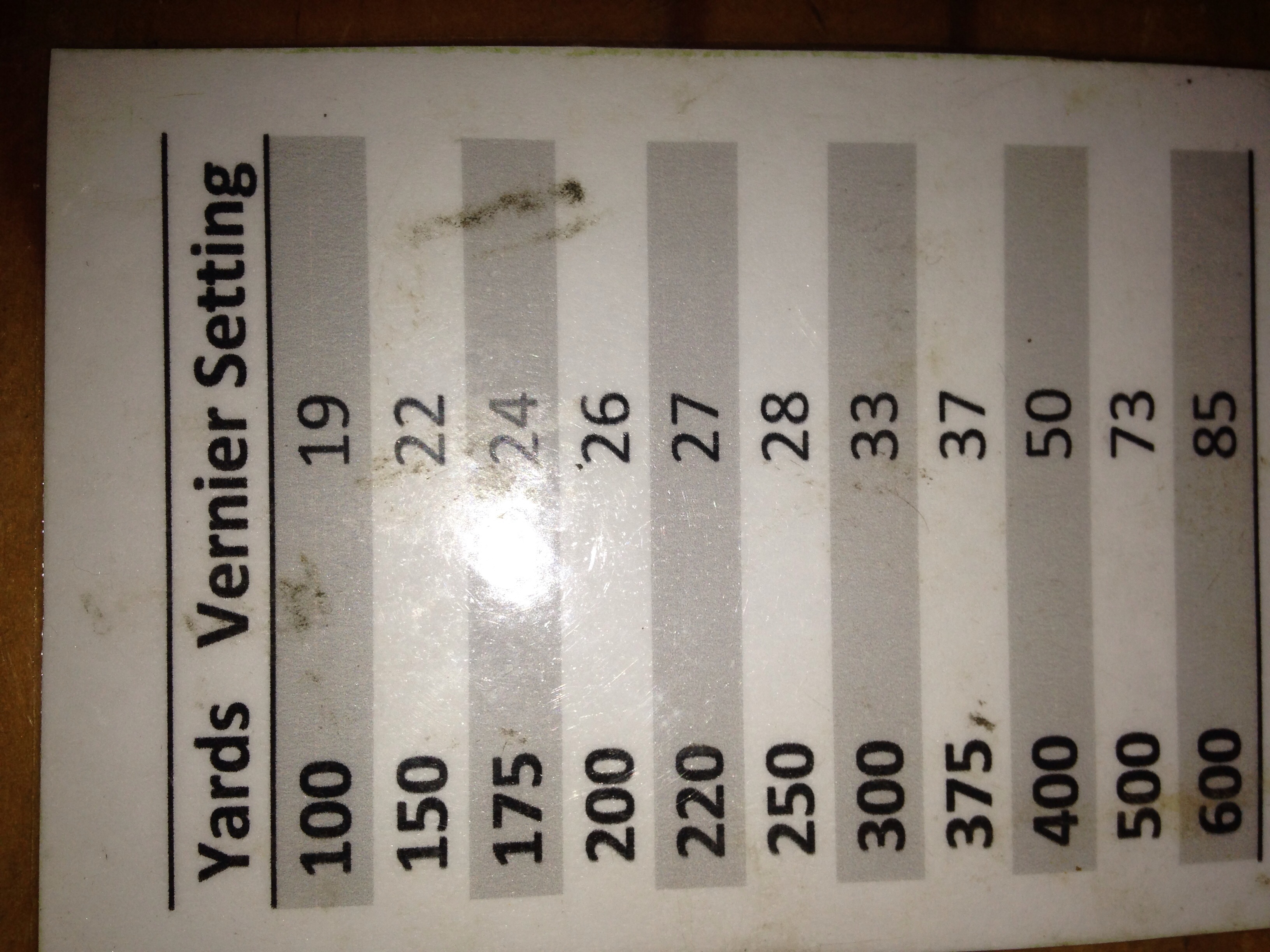

You'll find a laminated card of sight settings indispensable.
Post by Mick280 » 21 Jun 2015, 8:02 pm
I can certainly see the value in having a reference card like that once I am set up.
