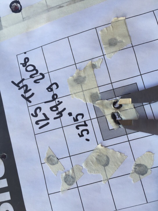

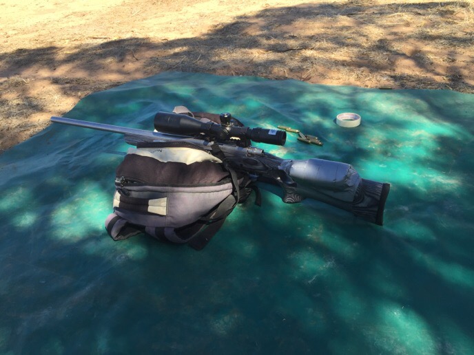

Post by MalleeFarmer » 28 Feb 2016, 6:19 pm
So I followed the advice given on centreing the scope and was basically spot on for windage. One click right I think. (Adjusted 10 right bore sighting and returned 9 after shooting at 25yd. :unknown: Elevation was around 36 clicks down 18 to a 25yd 0 and another 18 or so for a 100yd 0
Here is my prone setup. Bit flash I recon black wolf backpack with a couple jumpers stuffed inside as a rest. And an old bunker tarp so I don't get too much sand blowing up onto the rifle. Used an old sighting in paper hence all the holes taped up. Once I had I sighted I taped my holes up and shot a .5" with 125gr TNTs
Flash shooting setup.
.525" group at 100yd

Post by Seconds » 14 Apr 2016, 10:51 am
MalleeFarmer wrote:Bit flash I recon black wolf backpack with a couple jumpers stuffed inside as a rest. And an old bunker tarp so I don't get too much sand blowing up onto the rifle.
You're very fancy :lol:

Post by Usurper » 10 May 2016, 3:27 pm
MalleeFarmer wrote:Here is my prone setup. Bit flash I recon black wolf backpack with a couple jumpers stuffed inside as a rest.
The old back pack has served many a shooter well :thumbsup:
