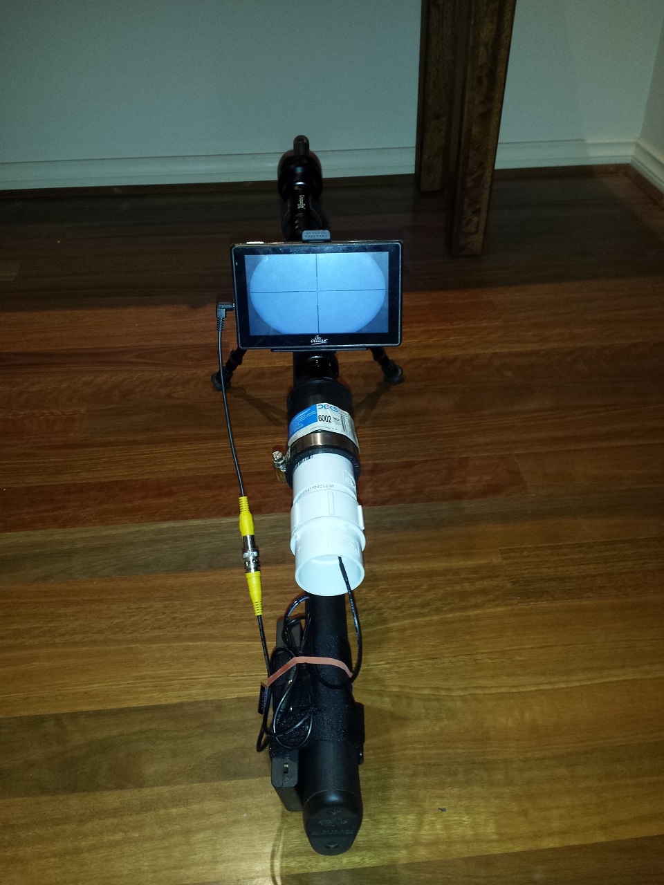

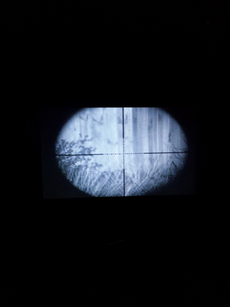

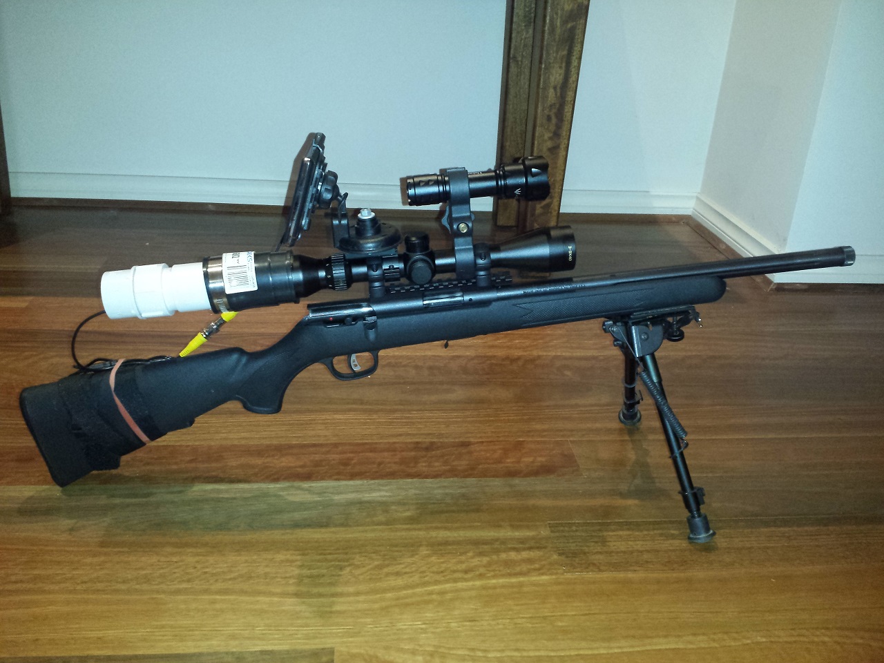

Post by YoungBuck » 23 Mar 2016, 5:37 pm
For those following along, all the parts came in and I have put it together. Will be testing it out this weekend. Lights up even better than I thought it would.
IR illumination through the scope in the dark of night.

Post by YoungBuck » 23 Mar 2016, 6:25 pm
Ah nice, didn't see your thread. This little system cost me $270 all up including postage for the parts.
This might get me into getting a better purpose built system but I'm going to need to be keen on night hunting and will really have to win the Mrs over with the price of them.

Post by Title_II » 27 Mar 2016, 1:14 pm
It looks awesome! Not sure how you are going to get a cheek weld with that. I have a similar setup but thermal, and with a one eye goggle display, and meant for shooting around corners or from defilade. Yeah, I have an inner Mall Ninja that gets me into pointless projects here and there.
If you are going to build the thing so that you can't even get a decent cheek weld, might as well look into an eye display instead of a giant panel. I did mine almost 10 years ago and the electronics and glasses cost probably $200 (not including the thermal). They are probably almost free now. I got something marketed for use as a DVD player. Which is pretty much the dumbest idea ever, who the heck wants to watch a DVD with one eye? Anyway, they are probably almost free now. And this was not my first one. I bought a setup that did the same thing about 15 years ago but it had mirrors and stuff and was a complete piece of crap. It was marketed as CCD digital night vision but was garbage.

Post by YoungBuck » 07 Mar 2017, 7:07 pm
Luvmadaysoff wrote:Well Done. Are you enjoying the system you made, and have you made any upgrades as yet?
Hi mate,
Yes enjoying it, it doesn't get used as much as I'd like but I've taken several rabbits with it. No upgrades to it since I made it, the one thing that i will be doing is getting a more powerful IR torch on in. The one that I have seems to have an overheat system built in and when its been running a bit long it starts blinking on and off on the lowest power setting (I assume to help it cool), really annoying when you are trying to line up a rabbit.
If anyone has any suggestions I'm happy to hear them.
