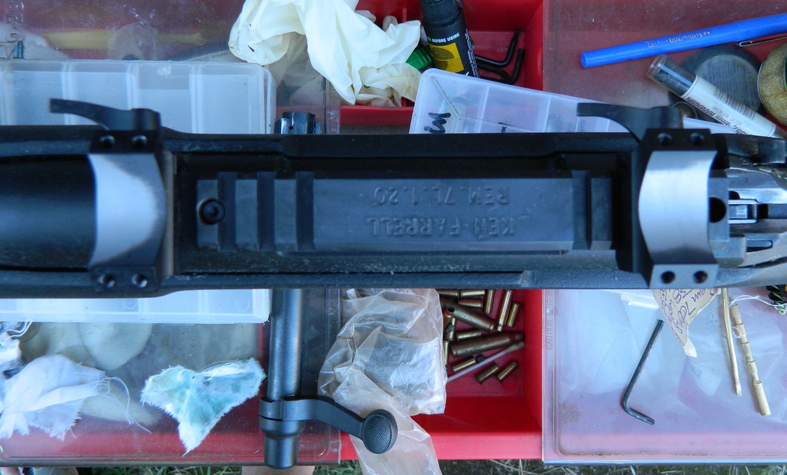

Here are a couple of example, of why I lap rings;
I hope you can see where the Steel Ring Material has been lapped/removed (Silver colour), and the remainder is still intact.
The Front/Left ring, has benefited most from this lapping job, as it was at a bit of an angle, compared to the Rear/Right ring.
The reason I generally lap rings in place, is to eliminate these tolerance variations.
The way I look at it is, you have probably heard of "Bedding a Rifle Action", well "Lapping the Rings" is basically doing the same thing for your scope!
The biggest problem you will be facing JunJun, is actually finding a person that actually understands what it is, that they are trying to achieve!
So be careful, as this task can be overdone by persons that don't truly understand, what it is they are trying to achieve.

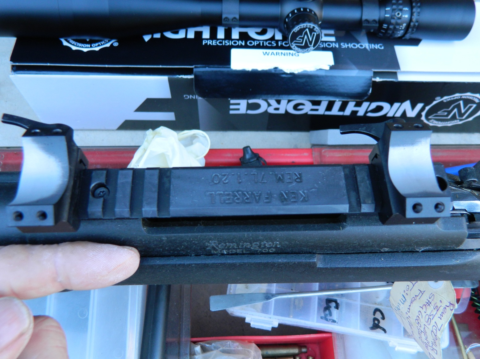

G'Day Fella's,
Here is another example of scope ring lapping, this time on Nightforce 34mm Aluminium triple screw rings.

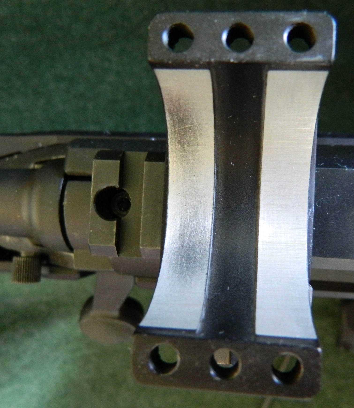

Here is a close up of the front ring.

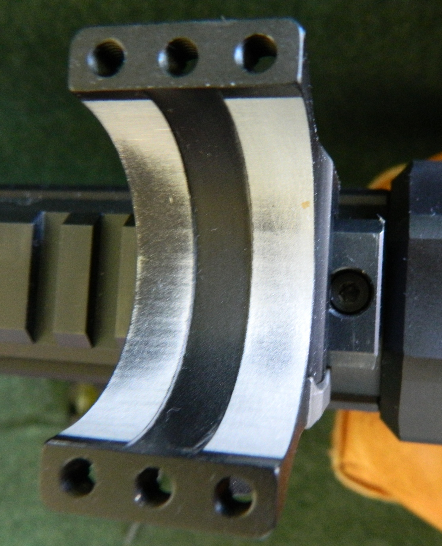

And a close up of the rear ring.
Then there is the finished product.
