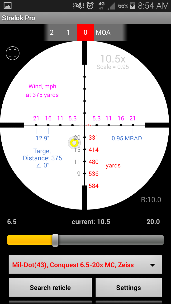

Post by on_one_wheel » 20 Oct 2016, 8:42 am
I've just got into milldot scopes and I'm loving them.
Yes for ranging you need to have it on the correct magnification.... that all good if your confident about the size of your target.
If you have it accurately ranged and you use balistics software then it doesn't really matter where you set your magnification.
This is how my .223 shoots
Pictures showing same wind and distance but different magnifications
I'm looking at saving a picture of my reticle at full magnification and sticking it on my flip up cover for a quick reference.
Most of the time I'm using the dots as a reference only and not ranging with them.
My range finder is way more accurate ... zero guess work involved as far as target size goes but being able to get a reasonable idea of range using the dots is pretty cool.
